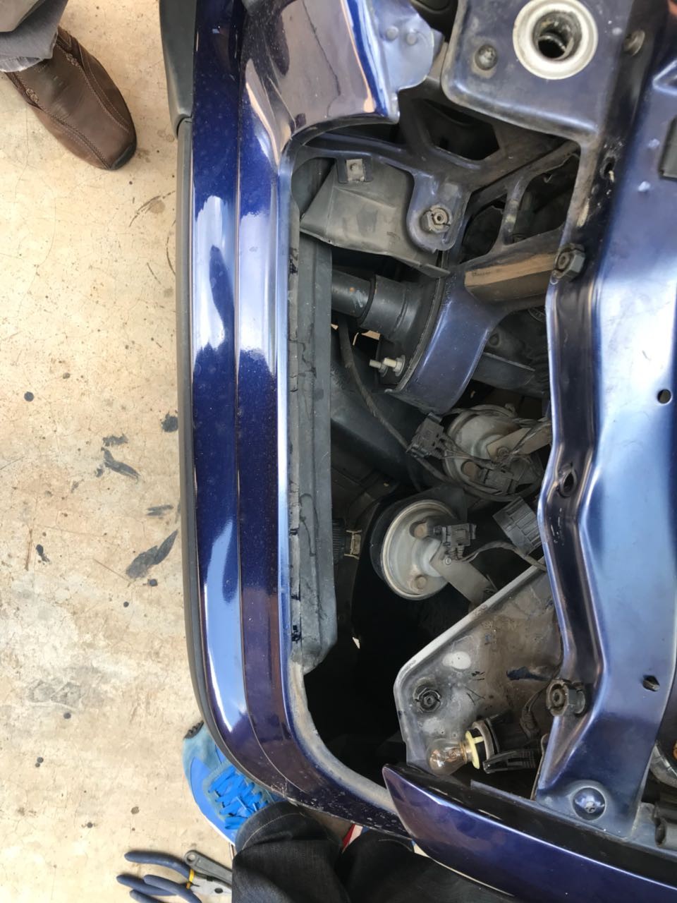

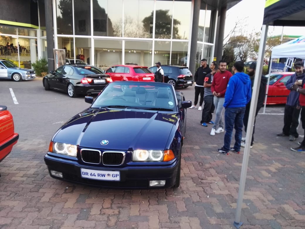

We started Saturday off late. But we began by fitting the CCFL Rings. After removing the lights, Preshen cleaned the housings and fitted the rings. Reassembled the housings and then did the connection of the left hand side light housing. We tested and the parks weren't working (They were working before we started). So we tried it on the right side which was working. Very strange we thought. Googled and googled and pottered around for about an hour trying to figure it out and eventually a call to Uncle Peter who confirmed that the right and left hand side have different fuses. Thank fully we had spare fuses and Bam we were back in action. As with anything on this car, the lights are so much easier to take off then they are to put back especially the bolt which sits on the passenger headlight under the air ram. That took another half an hour just one bolt.

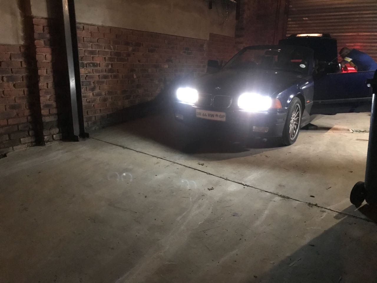

The CCFL Eyes are extremely bright. The last picture is just the CCFL and parks on. (Without the Lowbeam or HighBeam) I will take some better pictures during the day.

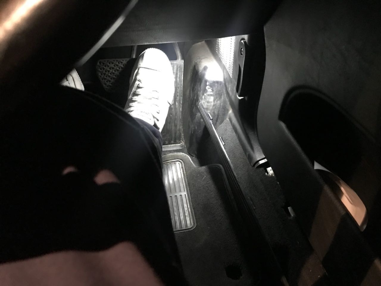

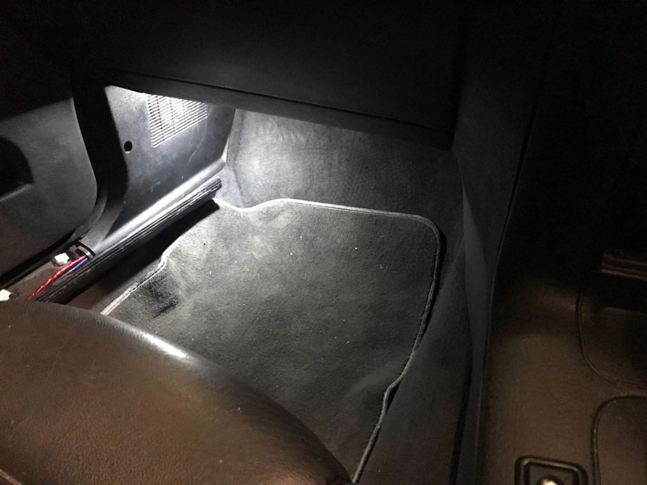

Next was Interior LED Lights. Footwells, Dome, Cubby and Boot fitted with LED.

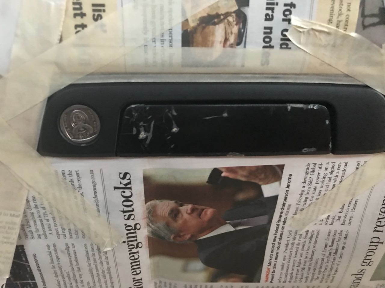

After Realizing what a bit job it would be to replace the door handle. We decided to respray the handle with Plastidip. BTW R1 fits into the Keyslot like a glove. Will update with an After later on.

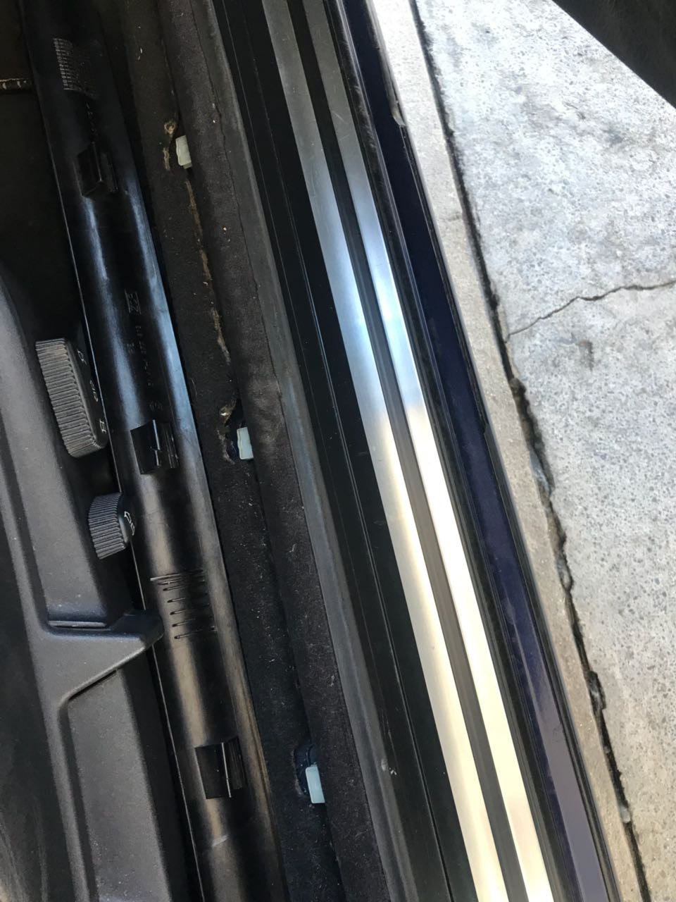

One thing I am really struggling with is trying to put the interior rocker panel (I think that is what they are called back on). If anybody knows how to do this and can assist me or give me some tips, please give me a shout.

Those clips on the door sills are a ‘use once’ affair. You will need to buy new clips to fit them back. It was a few rands when I bought them...

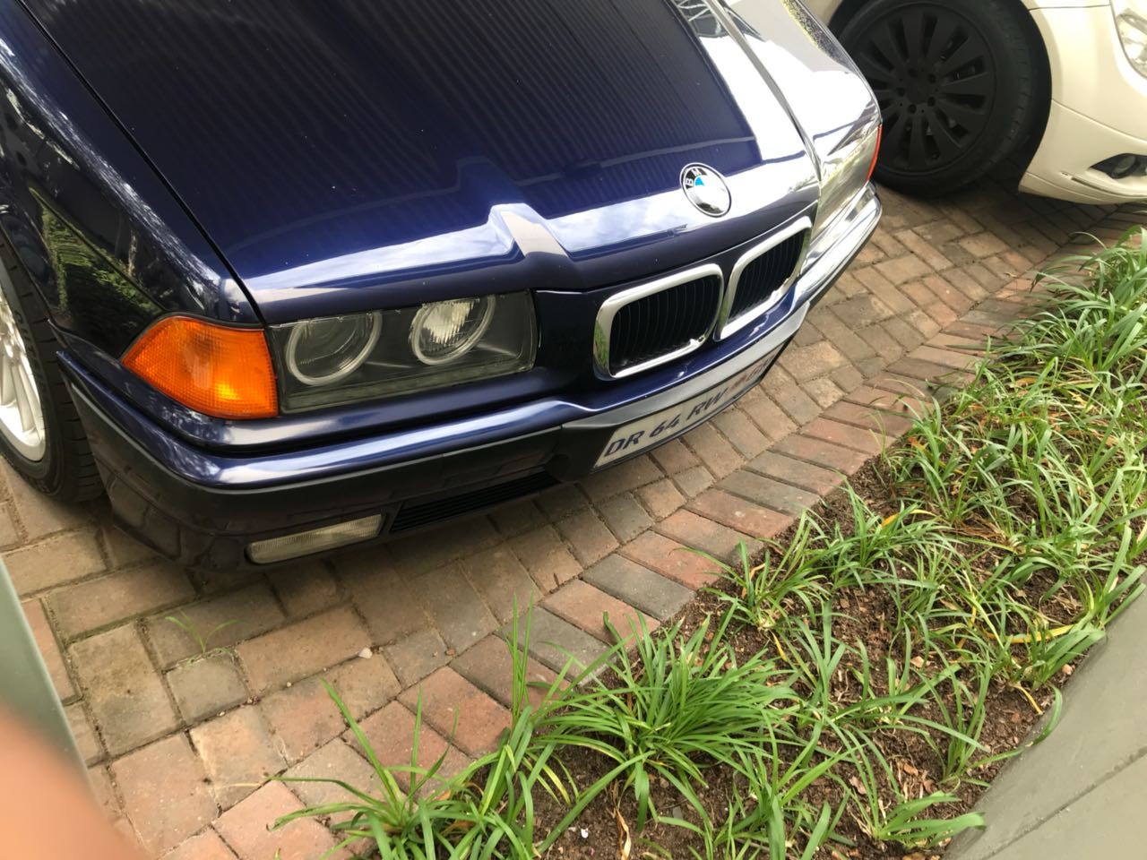

Car looks great bud, and once you add the final touches... Maybe throw in some clear indicators/rears as well? :blowheart:
Just a question as to why you decided to keep the park lights in addition to the angel eyes? You lose the full effect of the corona rings this way, IMO.

To be honest I never really gave it much thought but now that you mention it, ill make it happen, very simple to do. The car has literally driven 2000kms this year and I don't see her doing much more than another 1000km before year end so After fitting the angels I never really saw them again until the pics.
