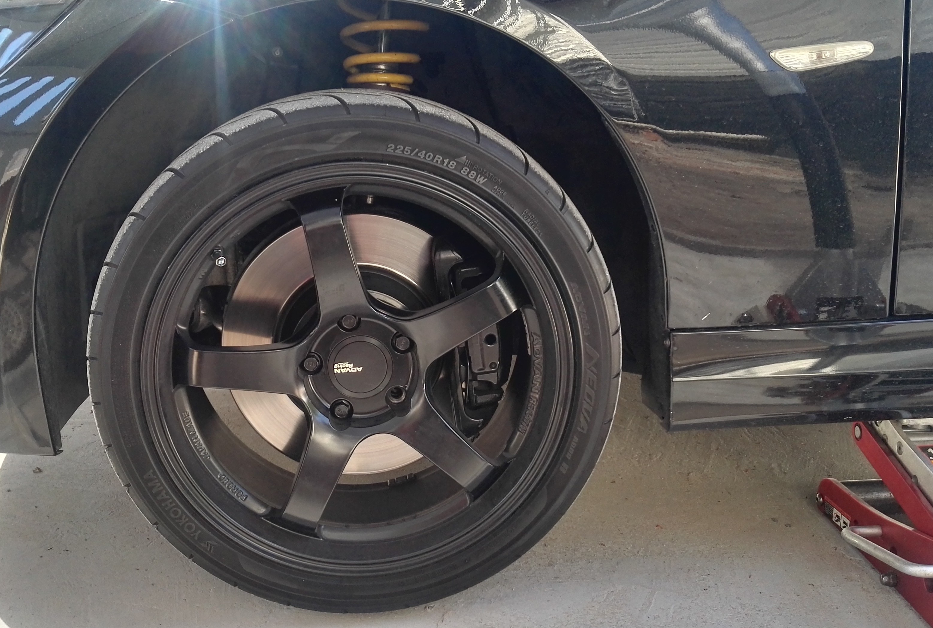

Some pix and comments on the fitment of the AXIS Caliper Guide Bushings:
1. My front and rear brakes are completely stock except for the ER brake lines. :thumbs:

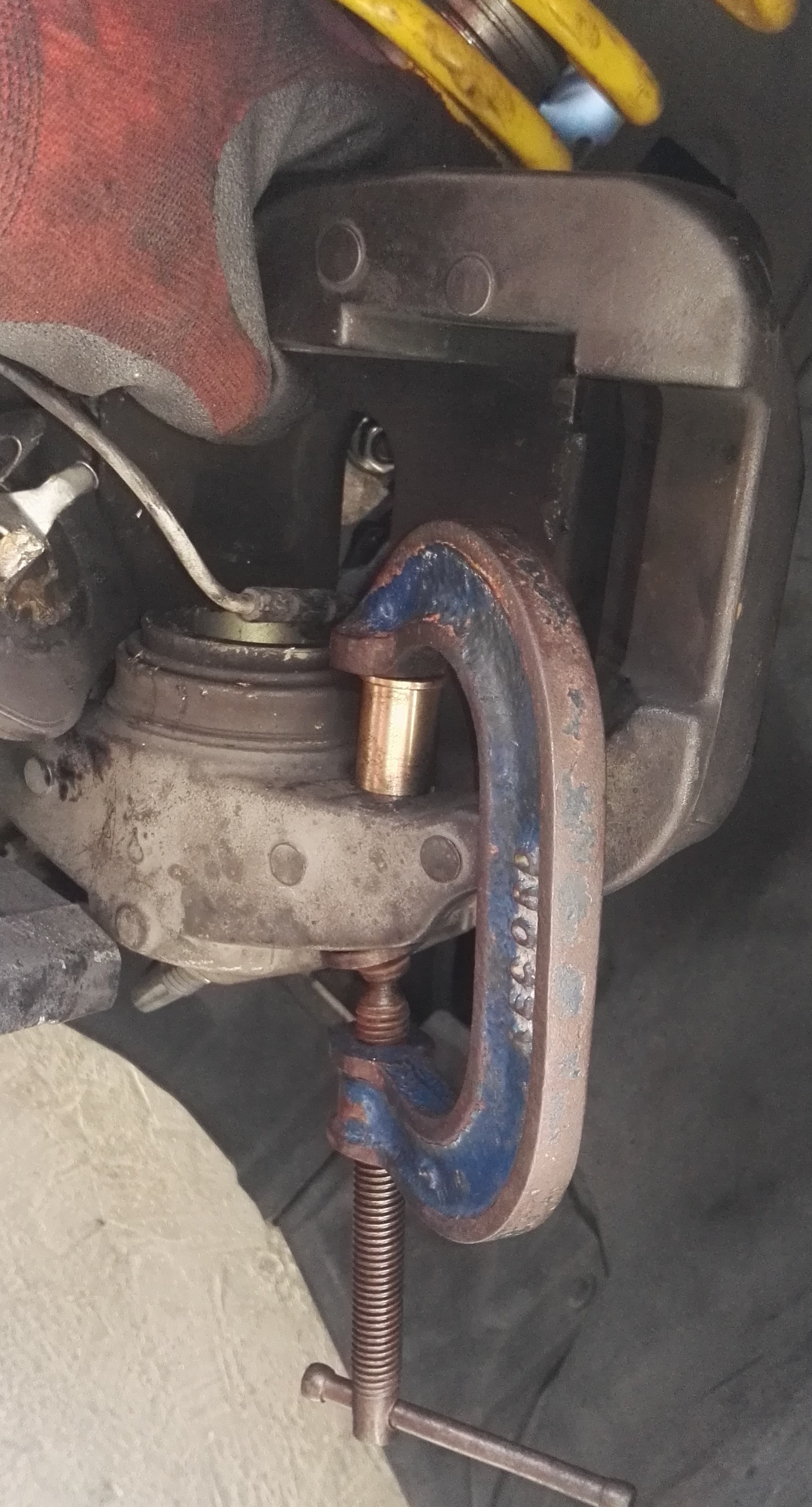

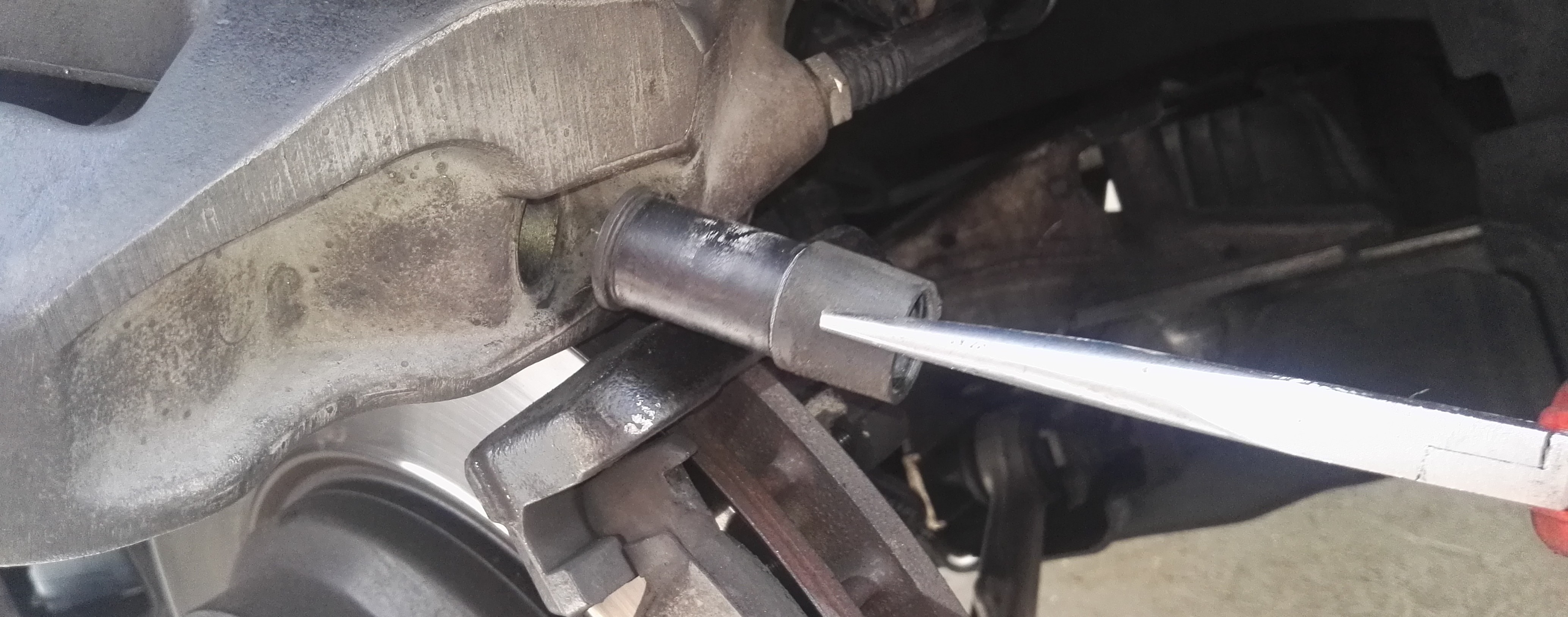

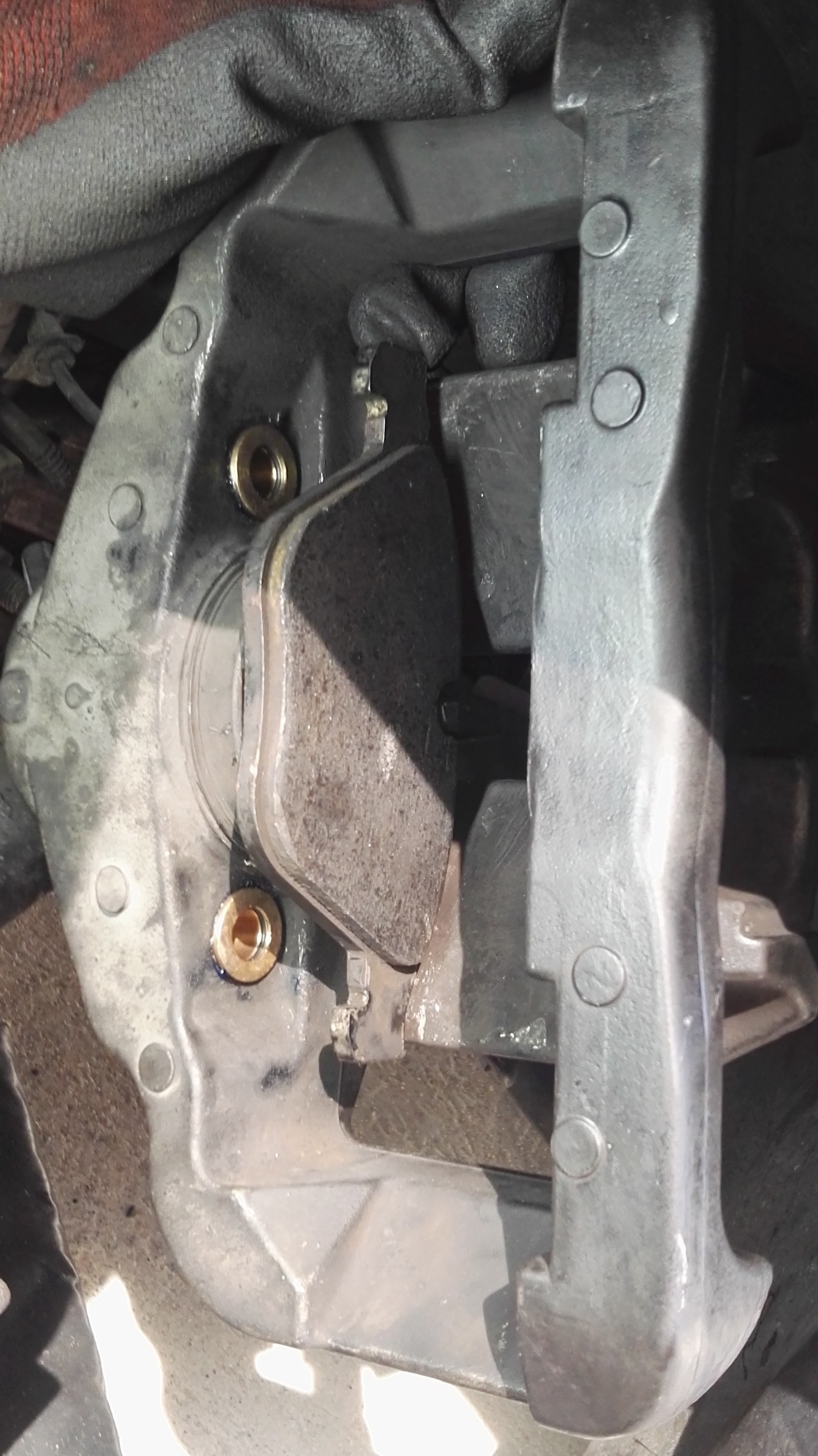

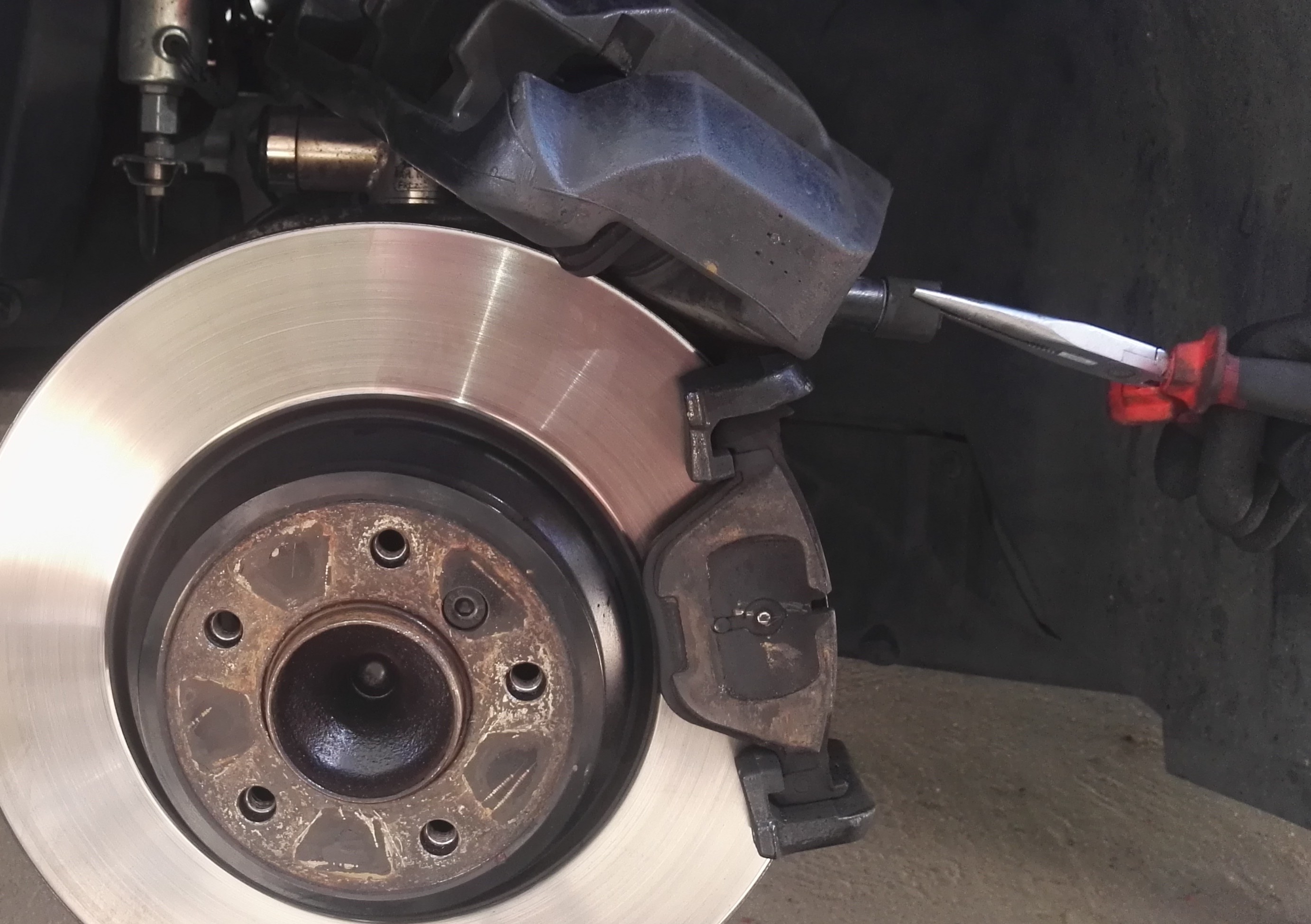

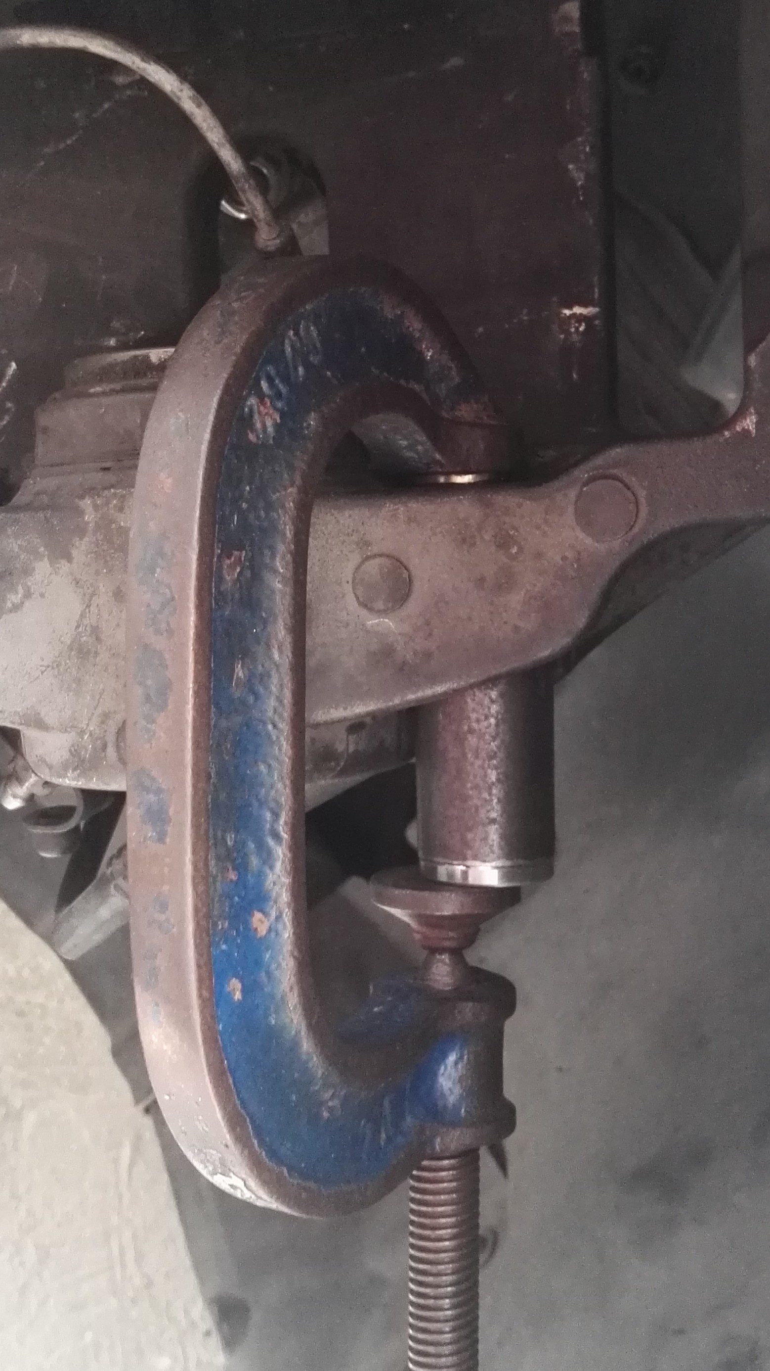

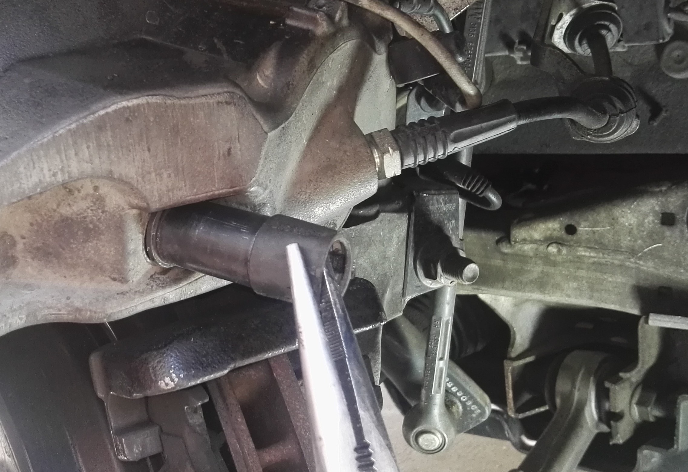

2. The installation of the Axis caliper guide bushings is easy for any novice to do BUT requires you to remove the caliper. To save you having to remove your calipers a 2nd time; this mod is best done when you change out your brake pads or discs or if you have more than 50% life on your pads/discs left; then do it. My front pads had very little left in them so I should have waited, but enthusiasts cant wait :smilebounce:

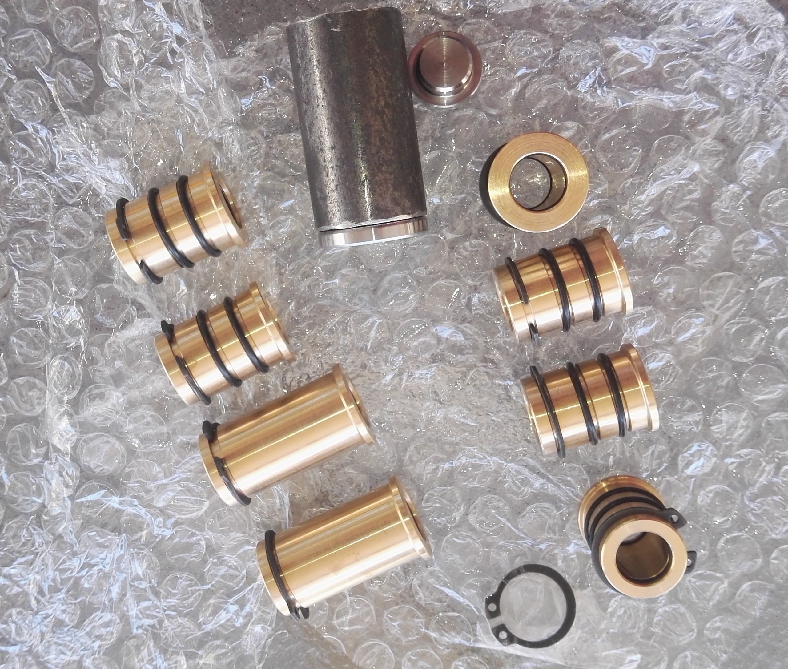

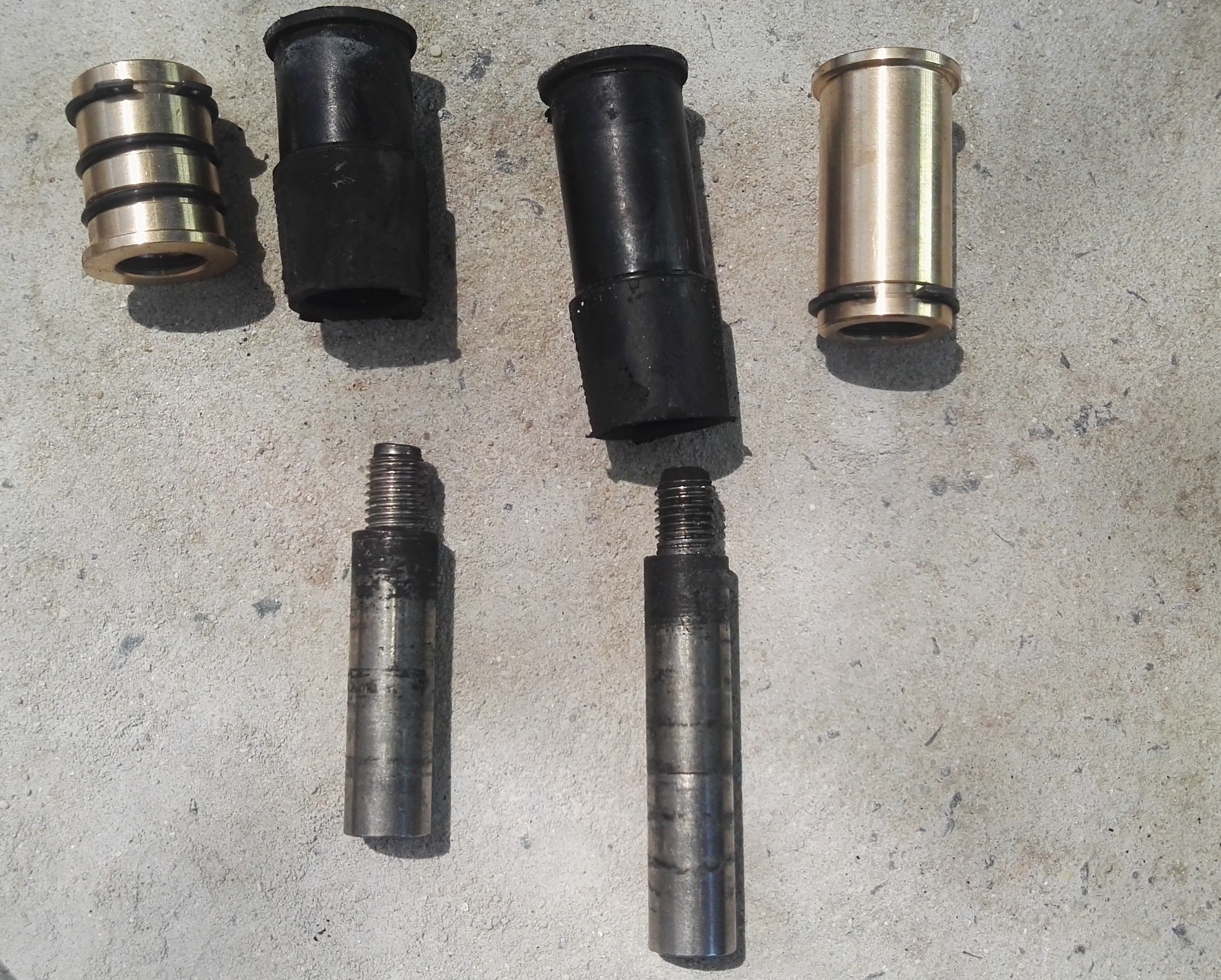

3. The Version 2 guides have O-rings on the inside and outside. The inside O-rings is a great idea and the sliding pins slotted in perfectly with a little grease. The outside O-rings did not work in my case. They kept on sliding out of their grooves even with liberal greasing and one of the outside O-rings cut & broke. I then removed all the (outside) O-rings and fitment was a breeze. The outside O-rings are meant to keep dust out and retain grease but since the guides are not "moving" parts, I don't see the use of the outside O-rings. So mine is fitted like version 1 bushings.

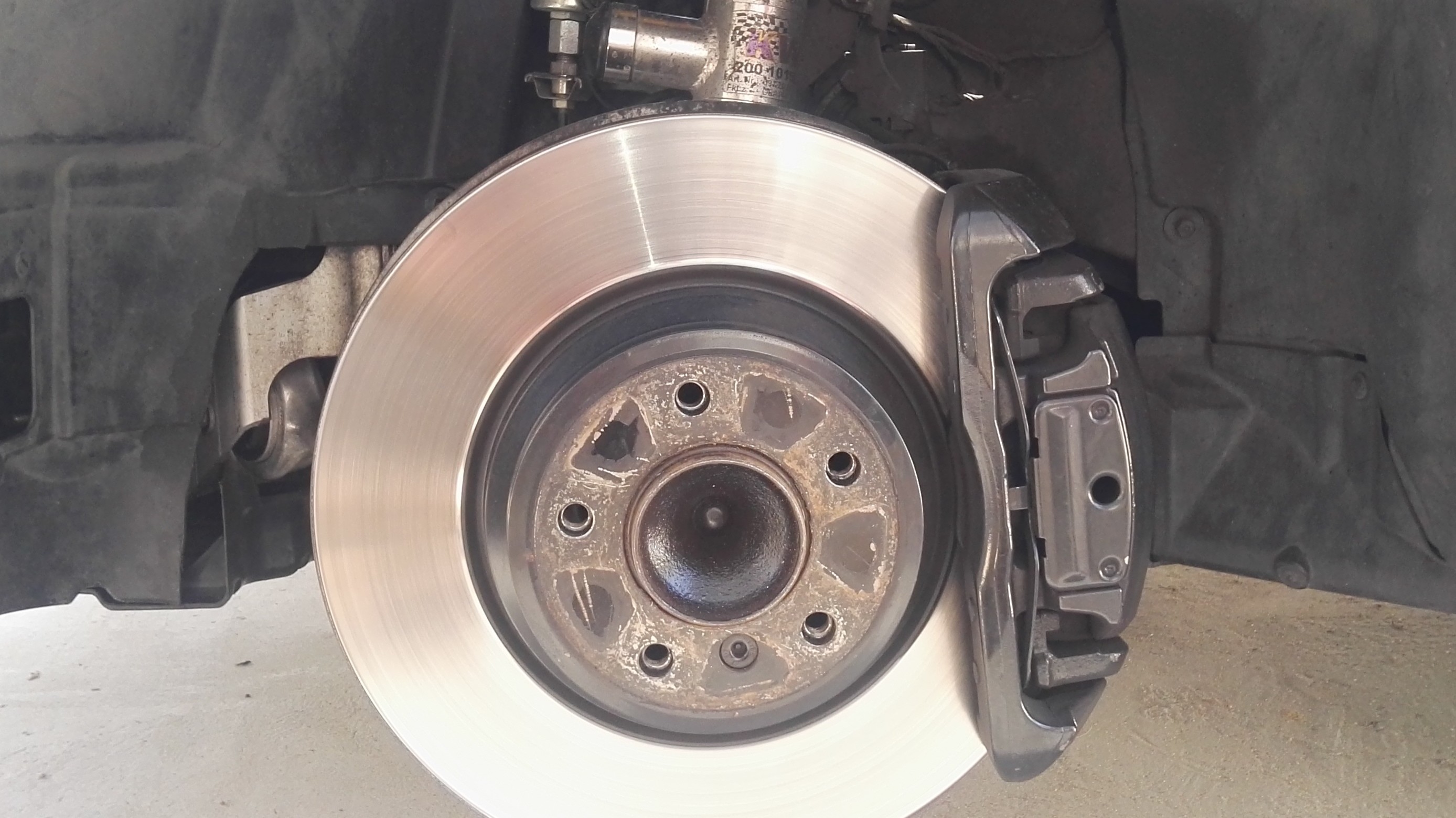

4. There is a definite improvement on brake feel and bite. :bravo:
5. Another good mod decision, pity I waited so long. :ty:
