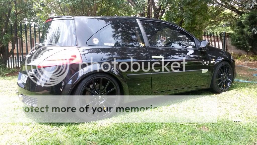

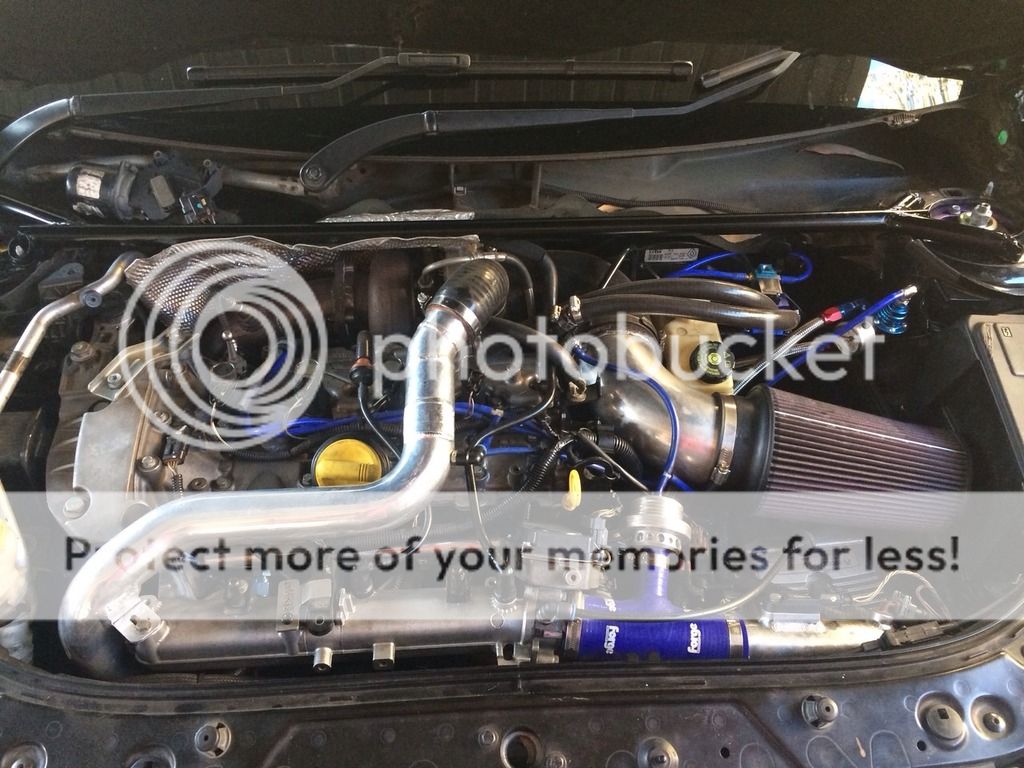

Pics:
when the motor was built initially:
The cab:
