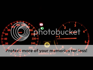

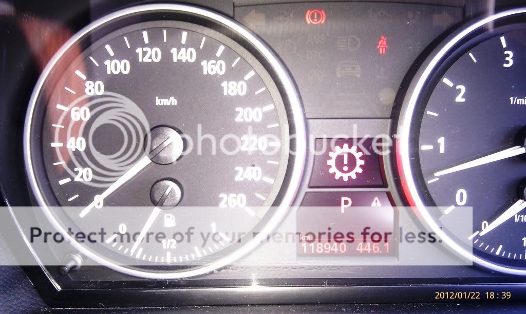

Hi guys,
so I got the same error again on saturday evening and took a picture of this and a video.
I'm really worried now and with so little mileage left on MP, I'm really considering a change :cry:
The car doesn't feel like a beast anymore...feels so slow and not responsive :cry:
Naruto
2 weeks back I took the car for service and they said they noticed that my Gearbox oil was low and filled it up.
The service technician was adamant that the light came on because of the fluids being low, and I asked him what could have made this, and he said to me, wear and tear in the GEARBOX... I got worried and asked what wearing off in my Gearbox. He just told me some :argh: when I asked him he couldn't explain.

Oh no!!!
I'm really worried now :cry:
Ricky how much did it set you back for?
where did you get it sorted?
Tlvivo
I am no gearbox expect but gearbox fluid shouldn't just go low (maybe someone more knowledgeable can correct me). If fluid was low there must be a leak somewhere, could be a crack or maybe a seal? Your warning is orange as opposed to Ricky's above so its not critical but needs urgent attention.
Is there a cover under your gearbox? maybe remove and see if there are no leaks - these under carriage covers disguise oil leaks very well especially if its leaking slowly.
worst case scenario is that your gearbox is shoelaced *(bust)... I say do as much trouble shooting as possible. As far as I know if transmission fluid is low in the gearbox the car will have loss of power as the gearbox is not working as it should.
