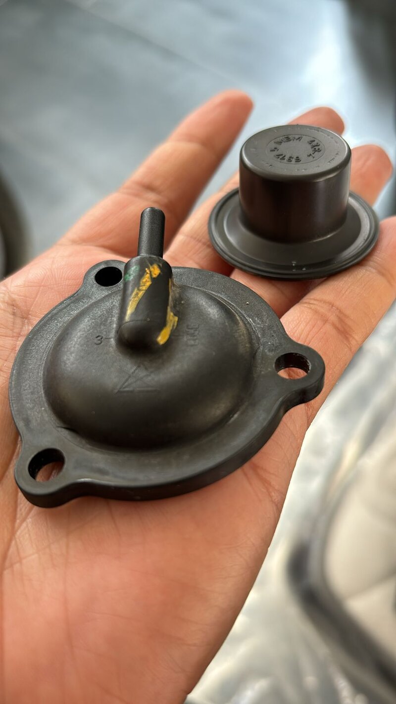

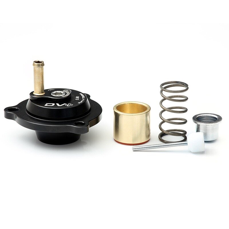

OEM DV was replaced by a GFB DV+ (this was not really 'required' but it was an easy job while the Turbo hose was being done and it replaces the plastic stock unit next to it). Apart from the obvious material differences, it also becomes problematic over time with higher boost.

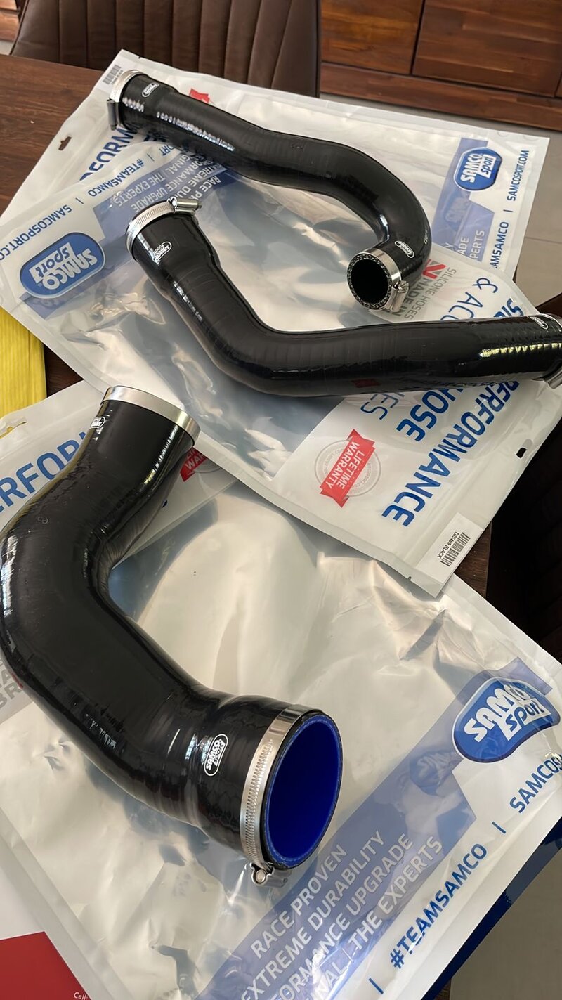

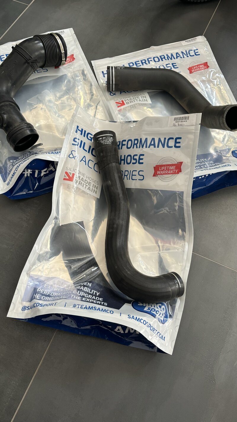

Samco intercooler hoses
Samco Turbo Inlet pipe
The reason to do these is to avoid deforming under higher and sustained boost as you'd find with track use. It also prevents cracking of the hard and fairly thin-walled plastic inlet pipe.

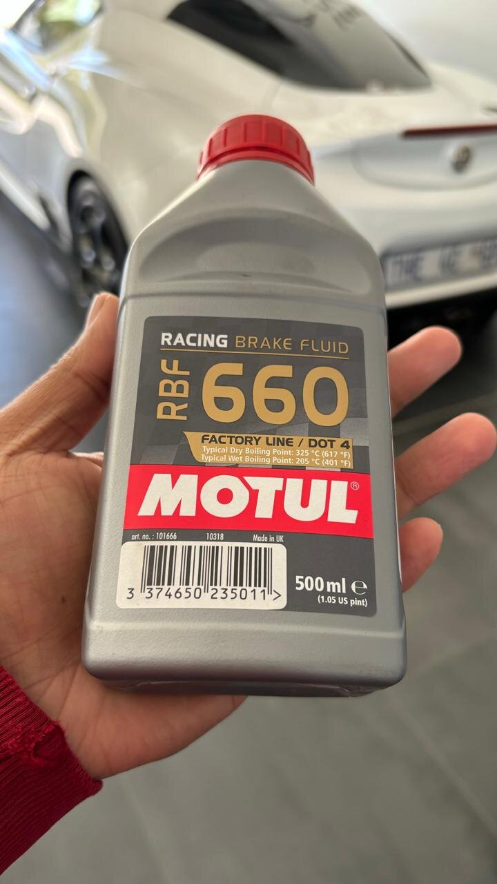

I also did a complete brake fluid and clutch flush/adjustment. Good ol' Motul RBF660

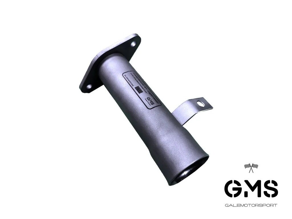

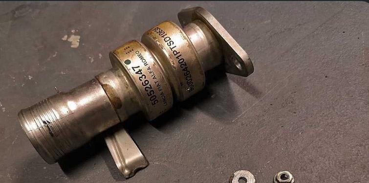

Turbo outlet resonator delete (this is a point of failure of sorts: the stock resonator disintegrates over time and the material makes its way towards the intercooler core. Not an issue on my 16000km example LOL but still worth doing 'while in there' there is a few mm of carbon fibre between you and the turbo (where this kinda sits) which is why I guess Alfa decided it should be resonated? Anyway it's a simple-enough inexpensive replacement (again while the labour is being put in).

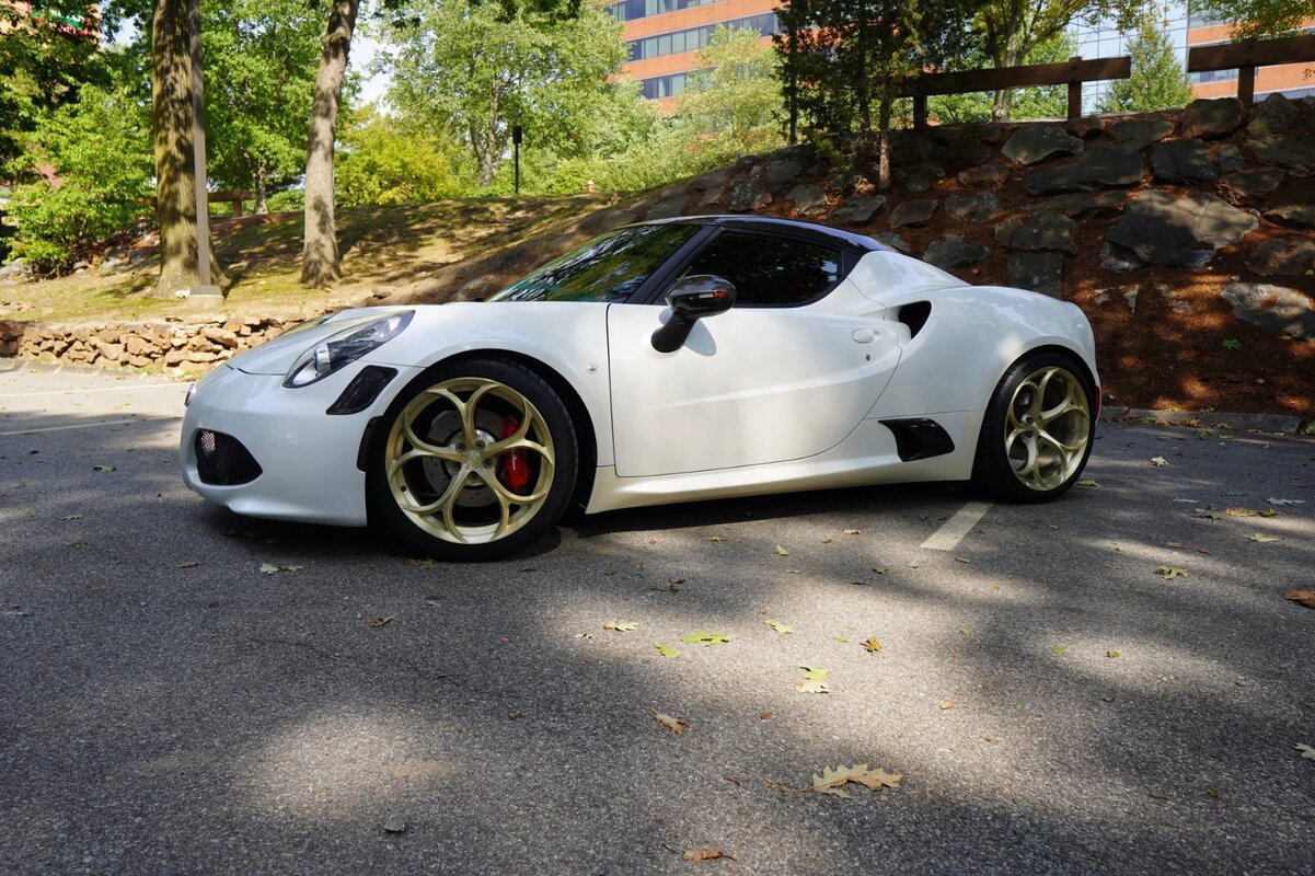

I can feel the Michelin PSC 2s are now coming to the end of their useful life (especially together with more power where I had some squirelly moments LOL). I am considering a wheel upgrade which will allow me to run 265s at the rear (Below). Something that is more OEM+ than others that look quite out of place (OZ, Novitec, Titans). This may coincide with my next set of tyres (and perhaps a change to different tyre too) I'd spoken to Firi about a custom set before. It's a strange PCD (5x98) so there are virtually no 'off the shelf' inexpensive options. That said, pricing doesn't seem to be terrible for 18F/19R sets.
