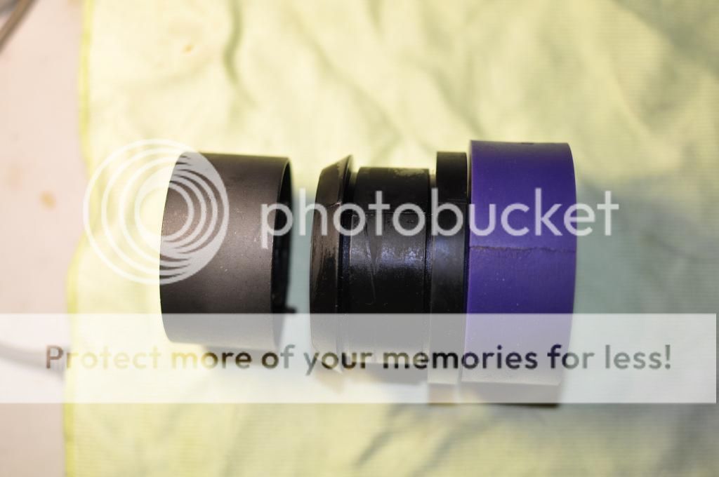

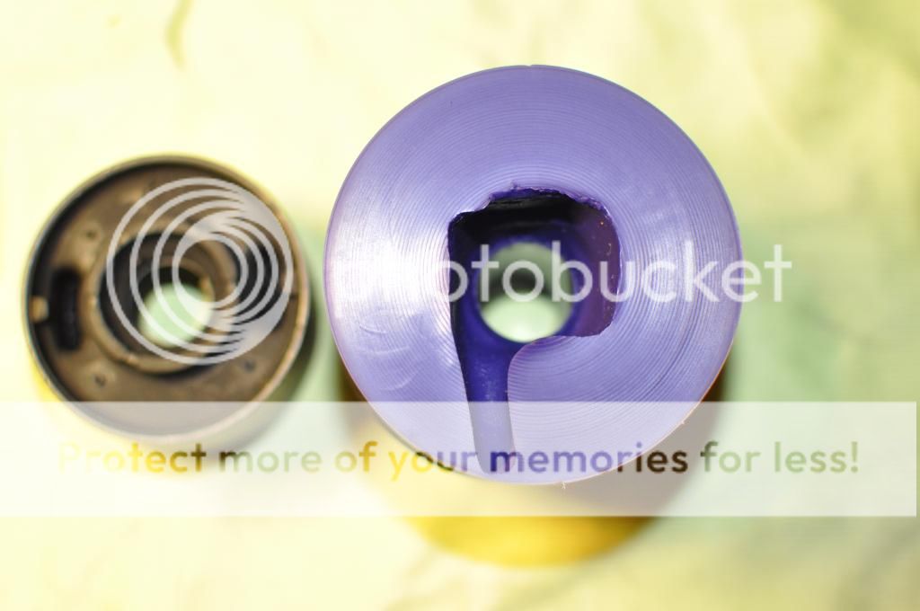

Powerflex lower control arm bushes.
New design from Powerflex which works much better.

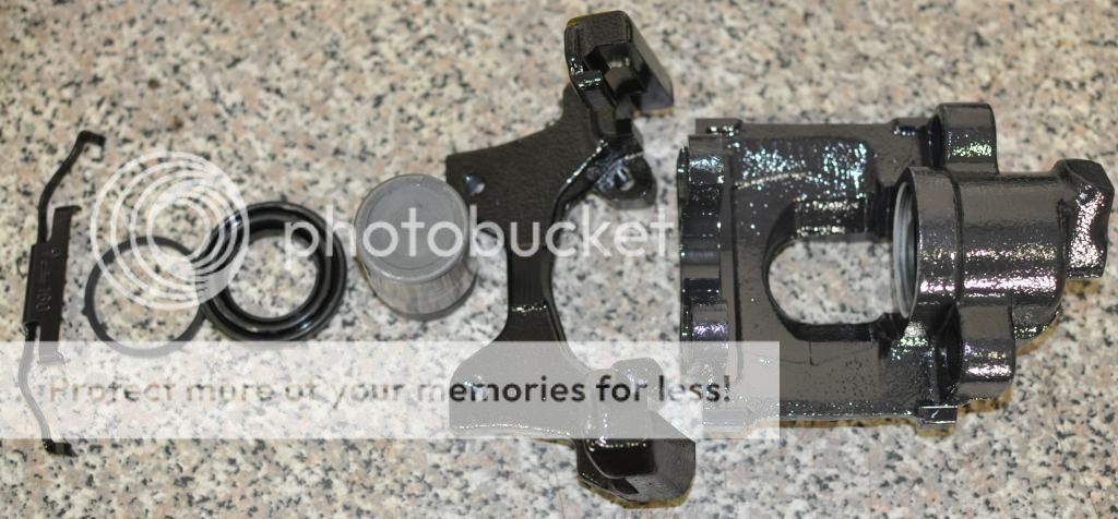

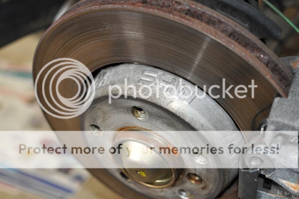

All 4 brake calipers will have been sent for ceramic coating in "factory spec black"
Absolutely smooth discs with a straight surface but worn pads after 28xxxKs.
Clearly no hard erratic braking.
I consider that as a sign of good driving habits.

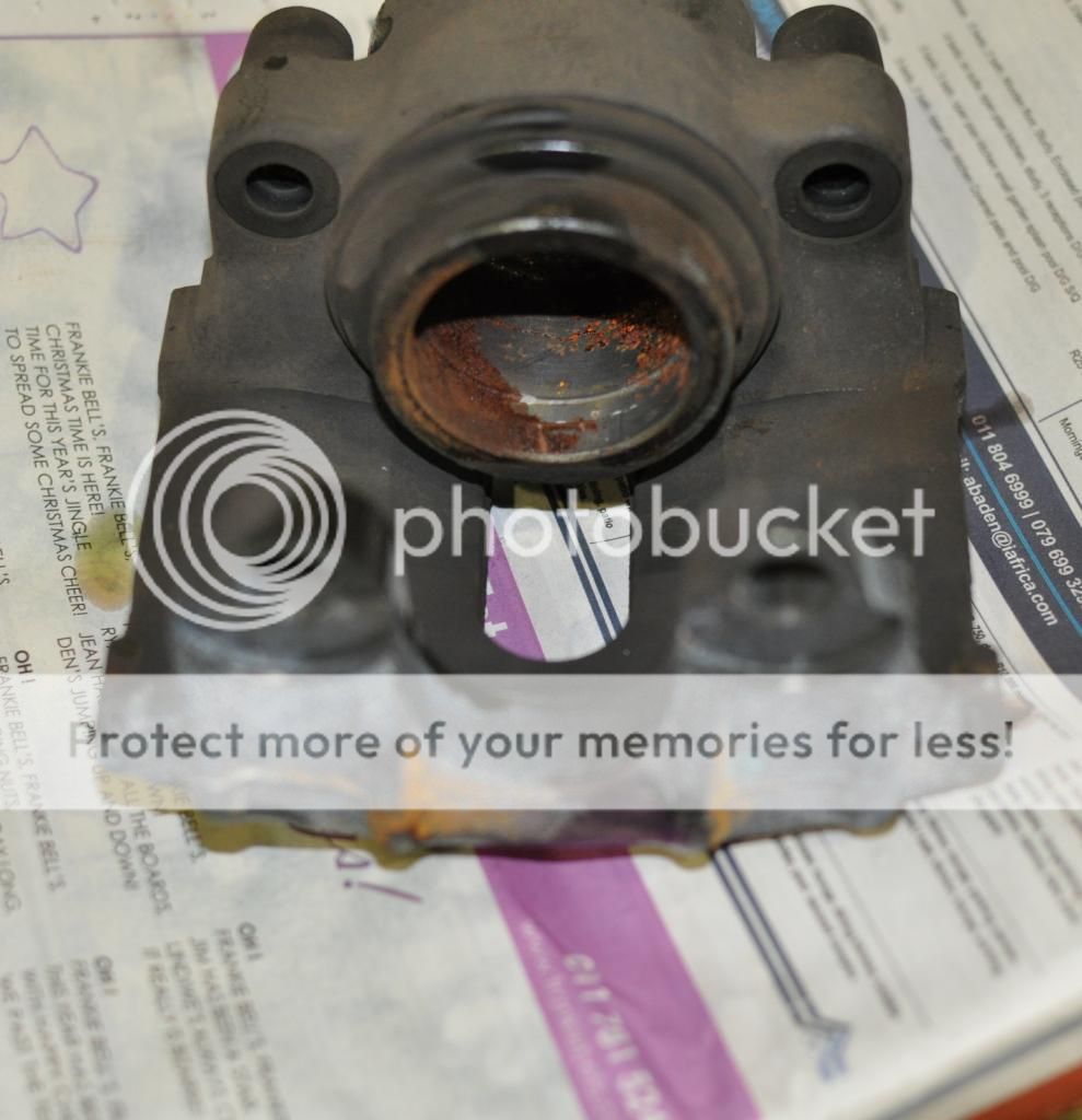

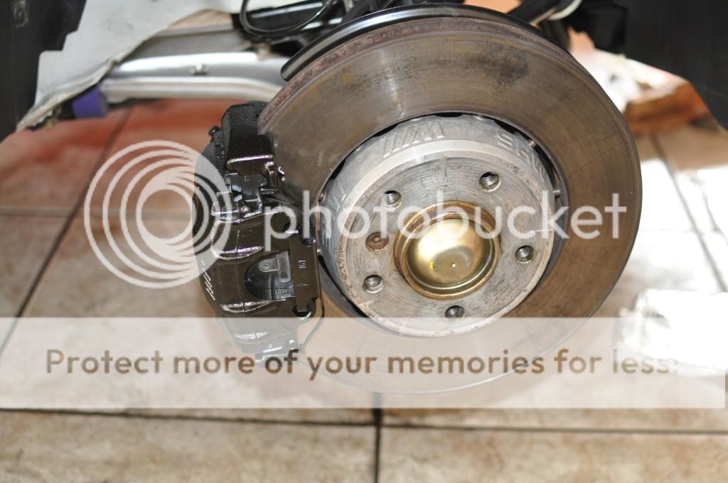

Left front stripped
Here is the before pic.
Peter@AEW

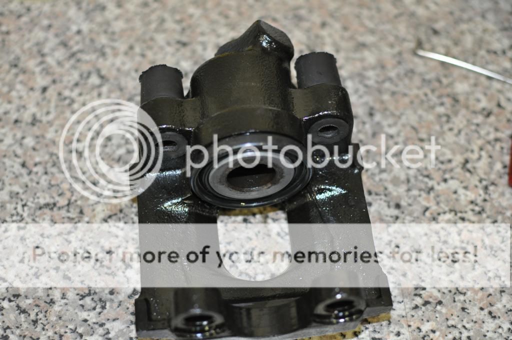

Brakes came back from POWERKOTE.
The ceramic coating although expensive is absolutely magnificent.

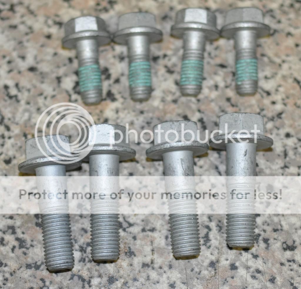

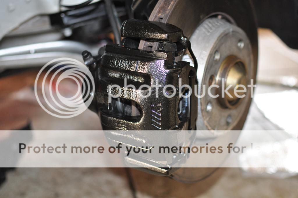

New bolts for the carrier brackets.
Rear brake carriers at 65Nm
Pins 30Nm
Brake disc locating bolt 15Nm
Front carrier brackets 110Nm
btw bolts are one time use

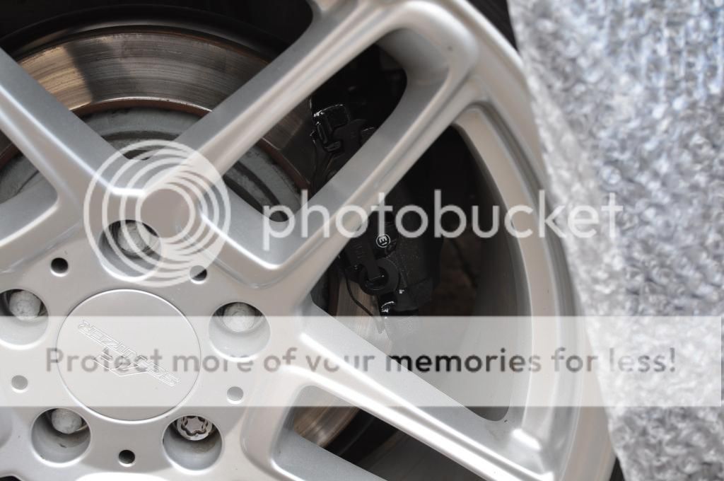

Peter@AEW

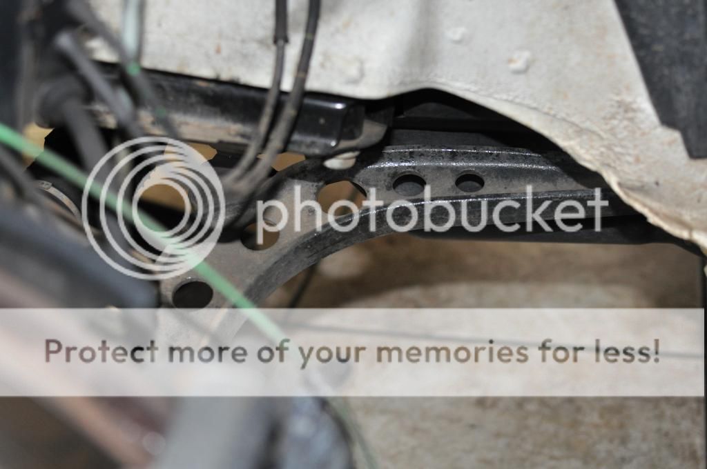

This is the rear left wheel.

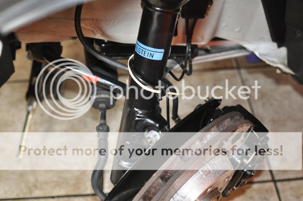

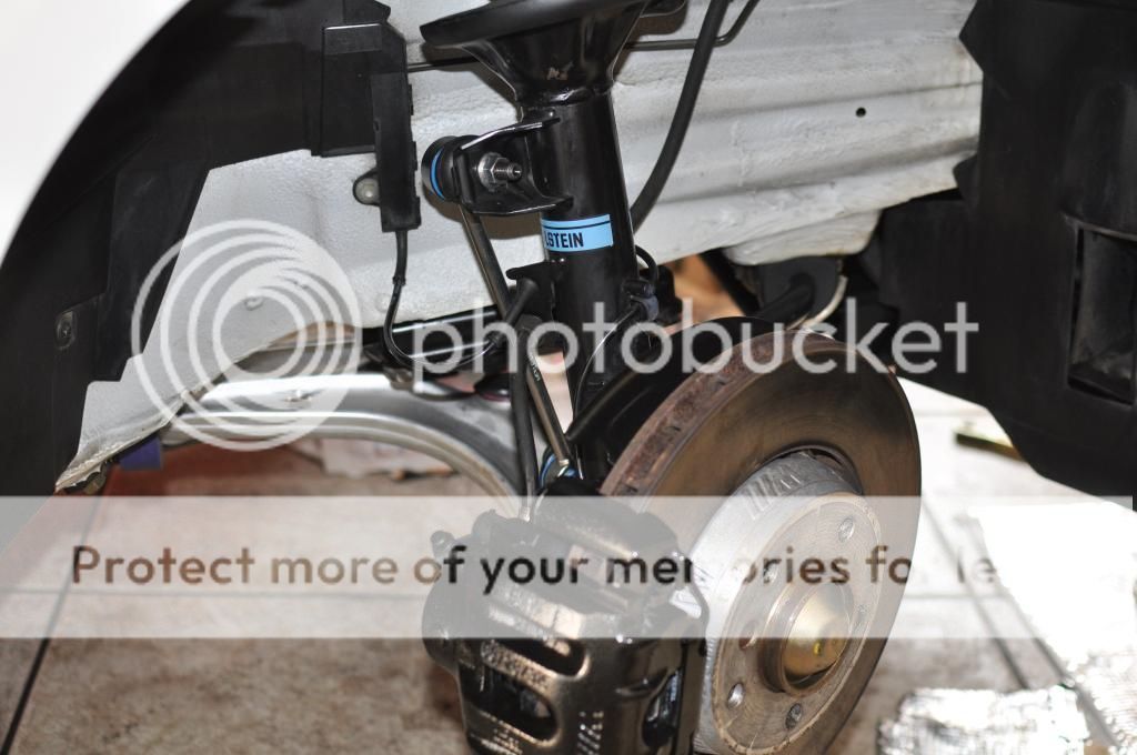

Front suspension
One of the left side.
Replaced the stabiliser links with MEYLE HD as they are bigger better stronger and cheaper the OE.
Anyone notice anything else?
