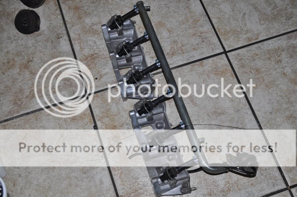

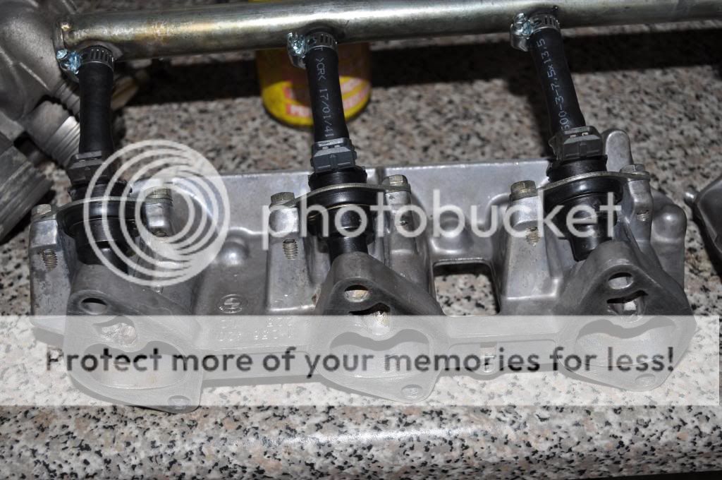

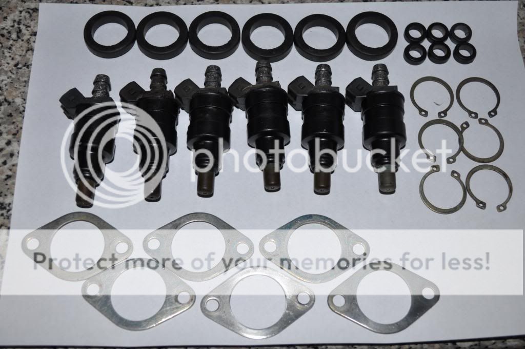

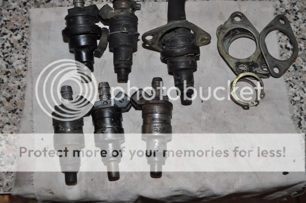

Injectors before and after

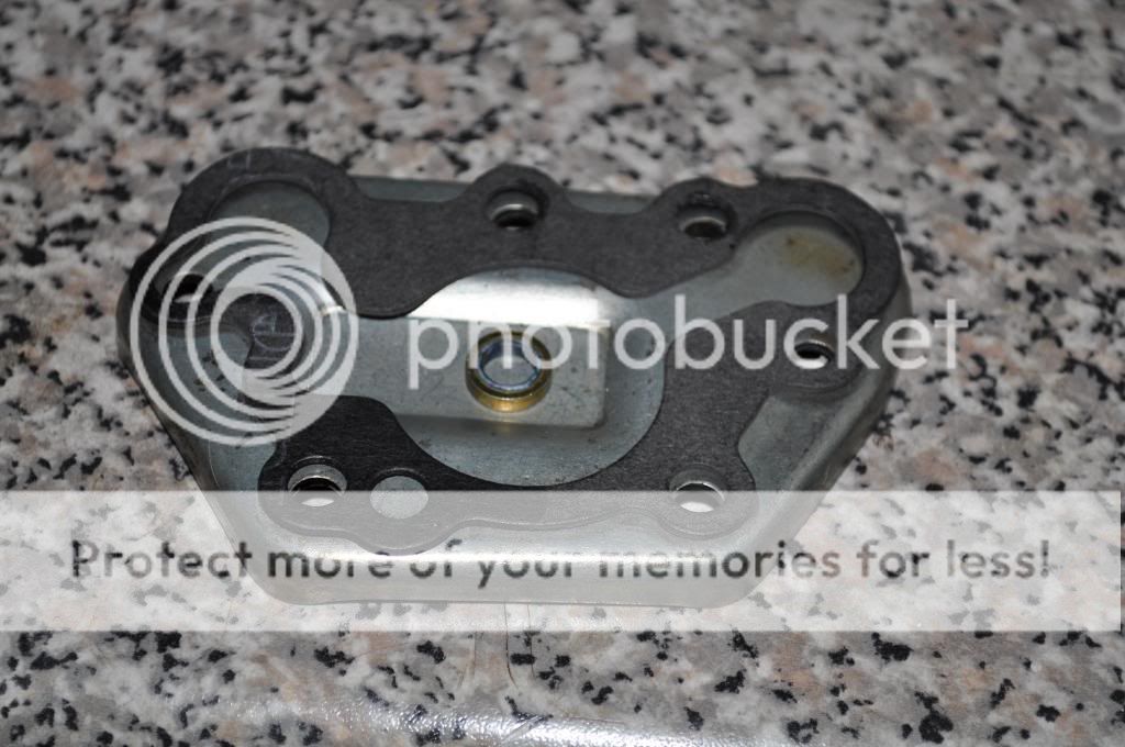

Cylinder head back plate with the special oil seal washer
To change the back plate one needs to drop the engine off the engine mountings and loosen and tighten bolts with quarter turns and then pray that they have not used silicone on the gasket.
Unfortunately my prayers went unanswered and the gasket was plastered with silicone which was not entirely unexpected given the rest of the of the engine

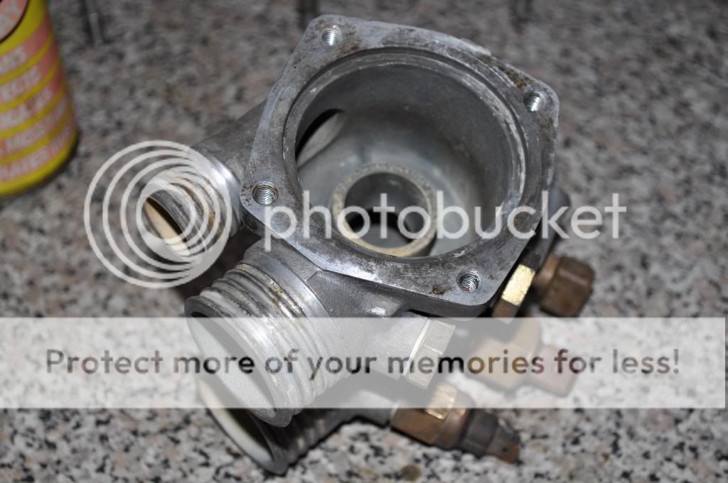

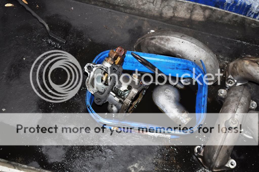

Thermostat housing soaking overnight to clear the gunk they had used to seal the thermostat cover.
Cleaned

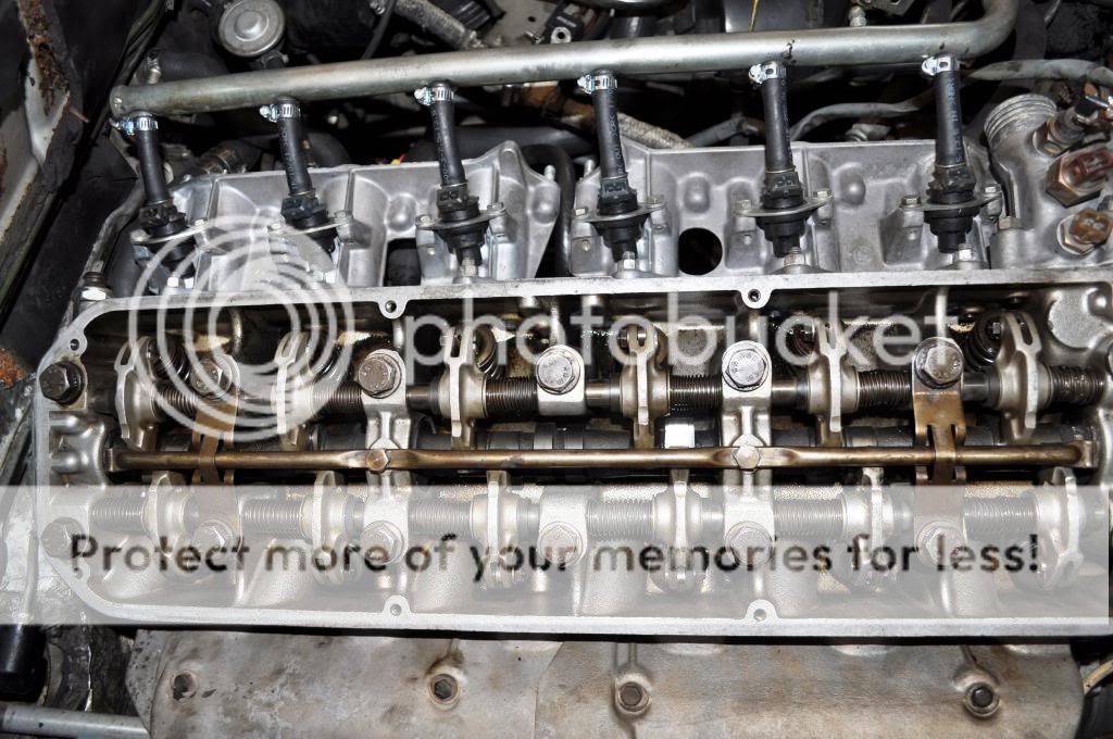

Worn rocker shafts and eccentrics is the next challenge that faced us when setting valve clearances.
We were tempted to go under size however the risk of damage to the valve train made us stay in spec.
Motor is still noisy but thanfully not as much as when it came in.

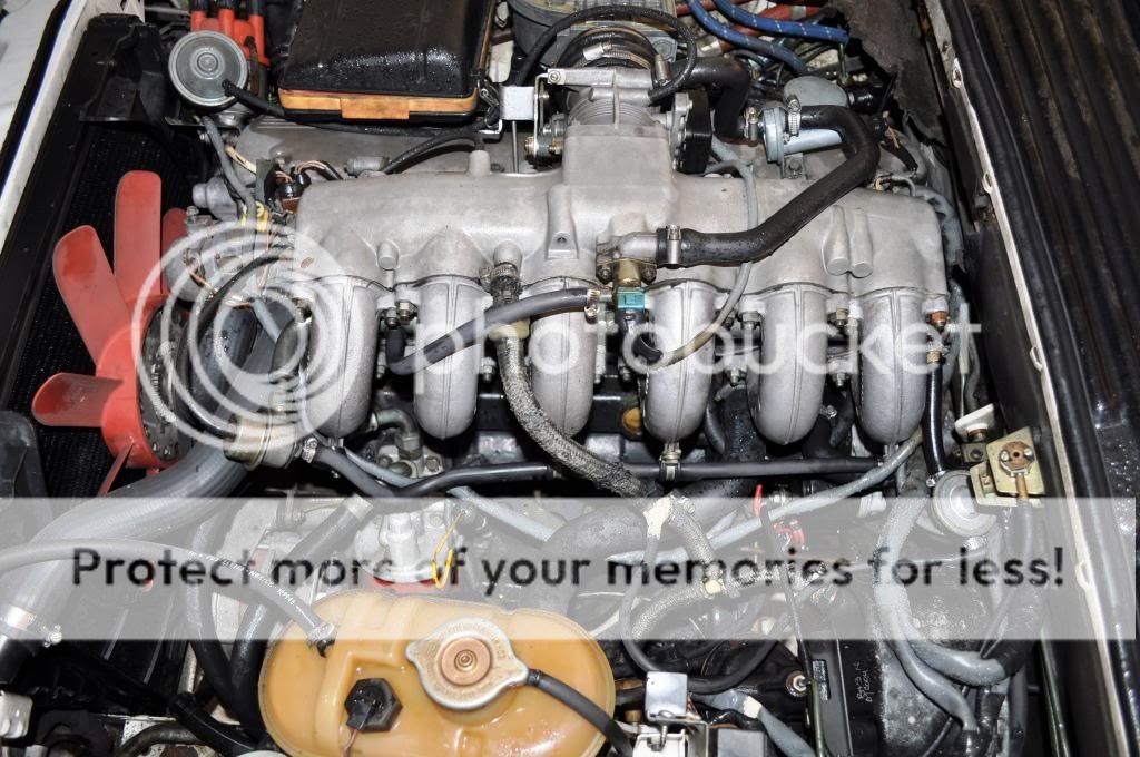

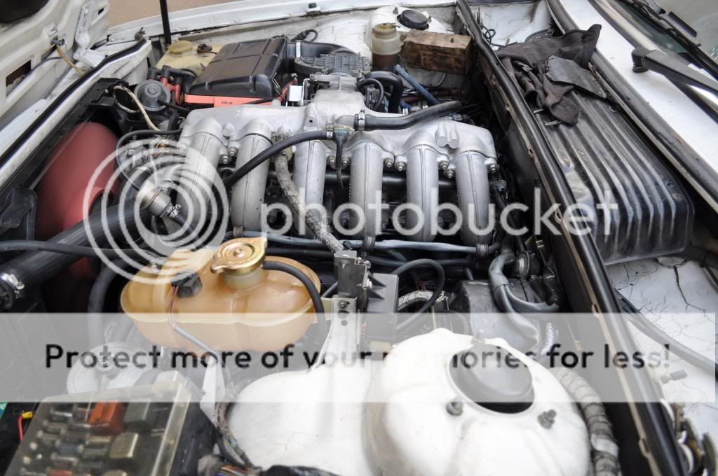

Finished assembly.
AFTER
BEFORE
As soon as budget allows there are a few more items that require replacement such as the booster vacuum hoses,engine mountings gear lever worn parts as well as power steering system shocks etc.
