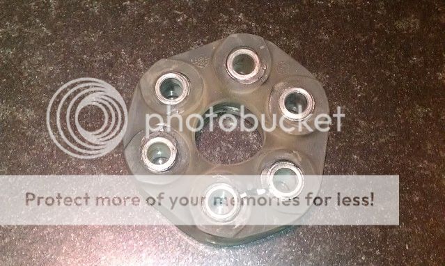

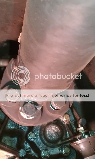

I also replaced mine and still had a problem....reason; inferior quality part. :flyfun: Failure was undetectable without stripping out the guibo. Bought one from BMW (@ a sweet R1200 :yikes: ) and the problem was solved.
Updated with photos:
Inferior part quality:
Almost undetectable without removing the propshaft:
Resulting in vibration under load (e.g. acceleration or uphill driving).
