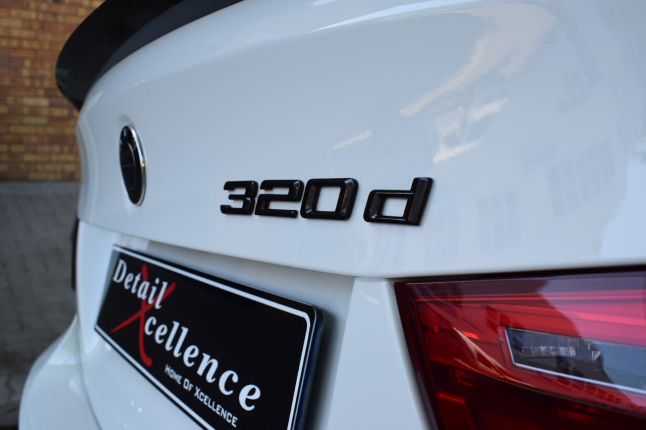

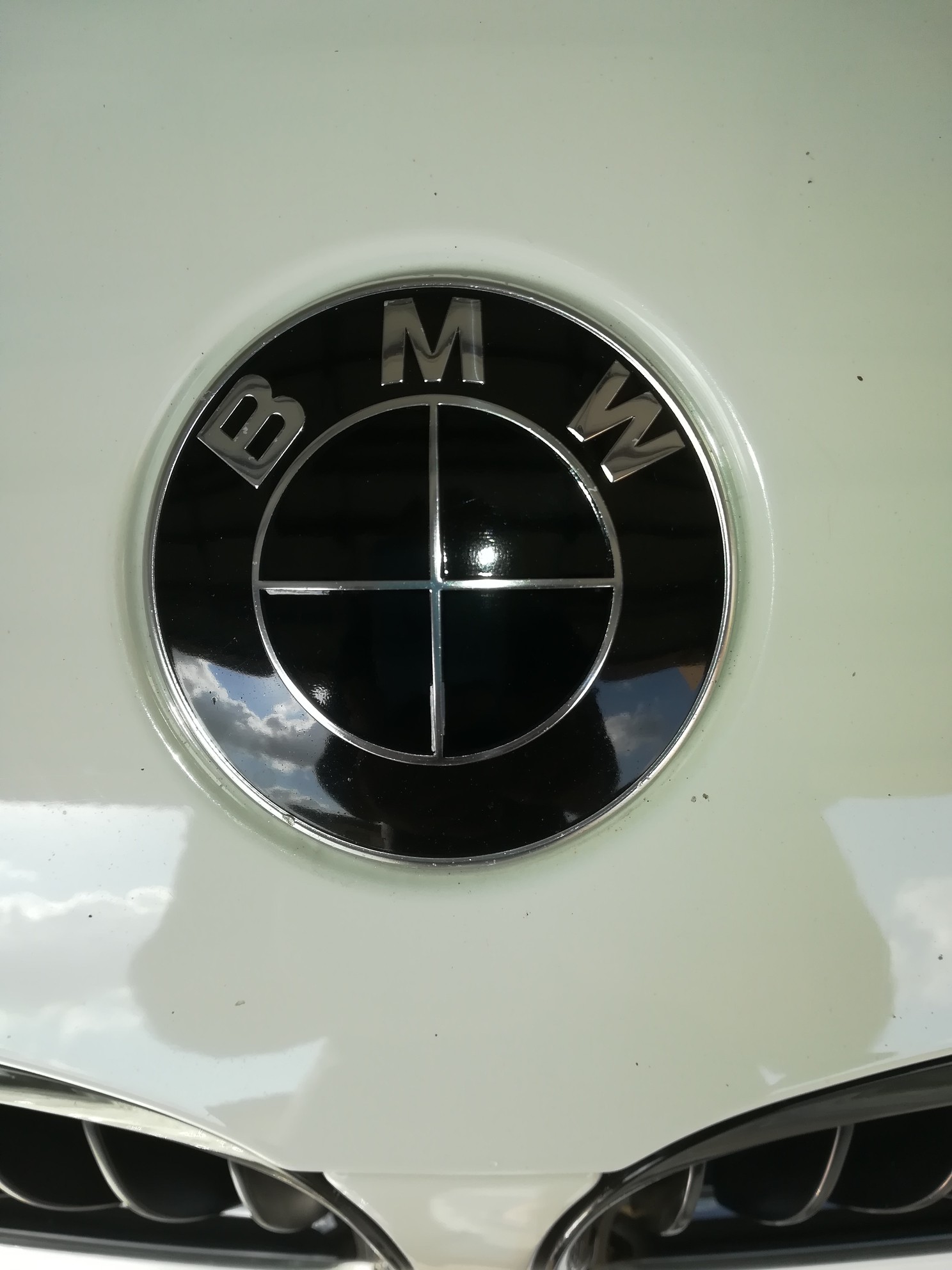

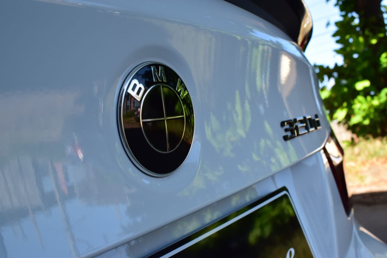

The aftermarket badges that I put on changed color. The silver on it turned to brown and it had like water spots on the entire badge. Changed it back to the originals put on a vinyl overlay. Thanks Riaad. Looks much better now.

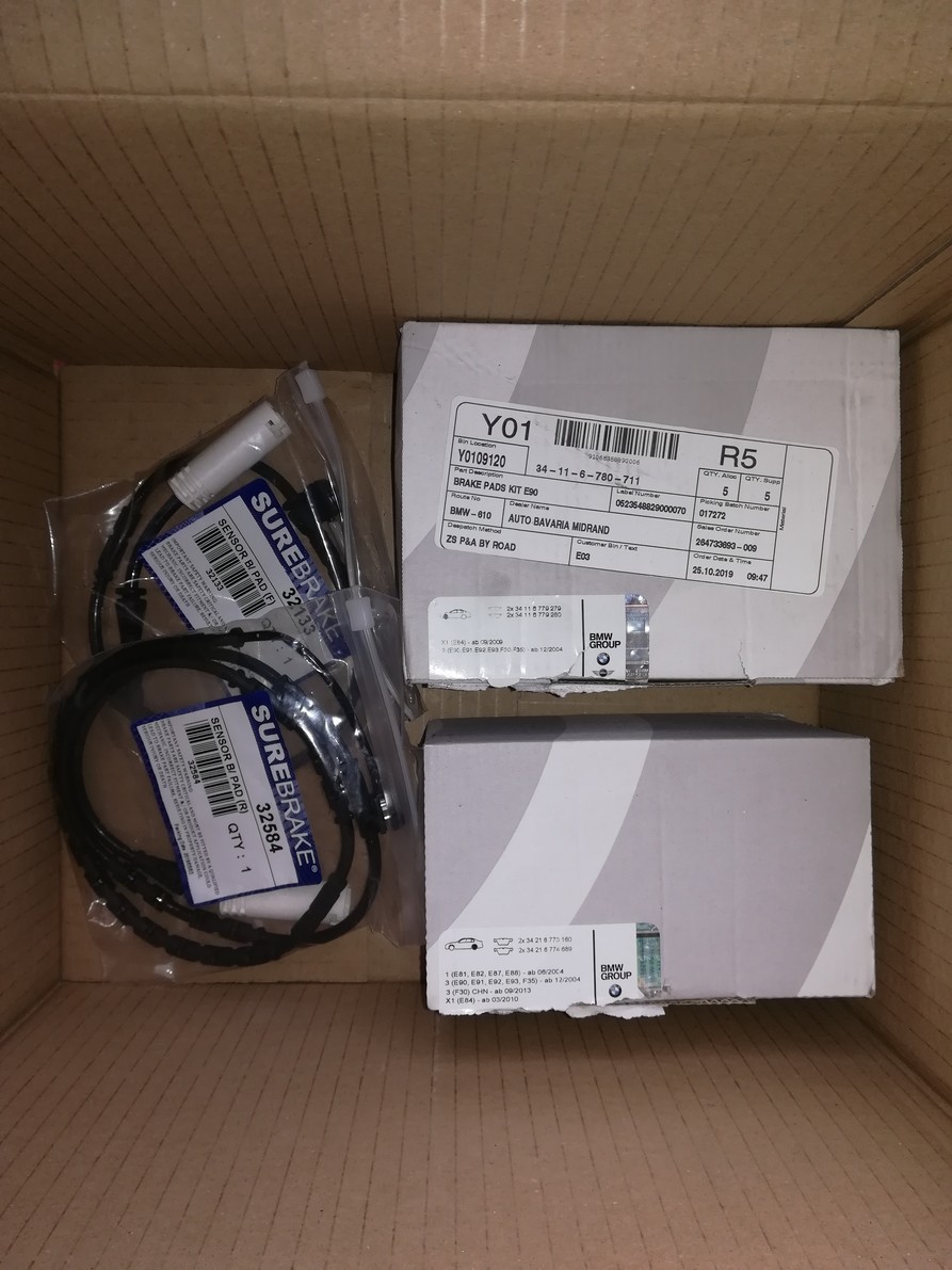

Yesterday I got the front and rear brake pads and front discs changed. The textar brake pads were returned and I purchased oem from ABM.

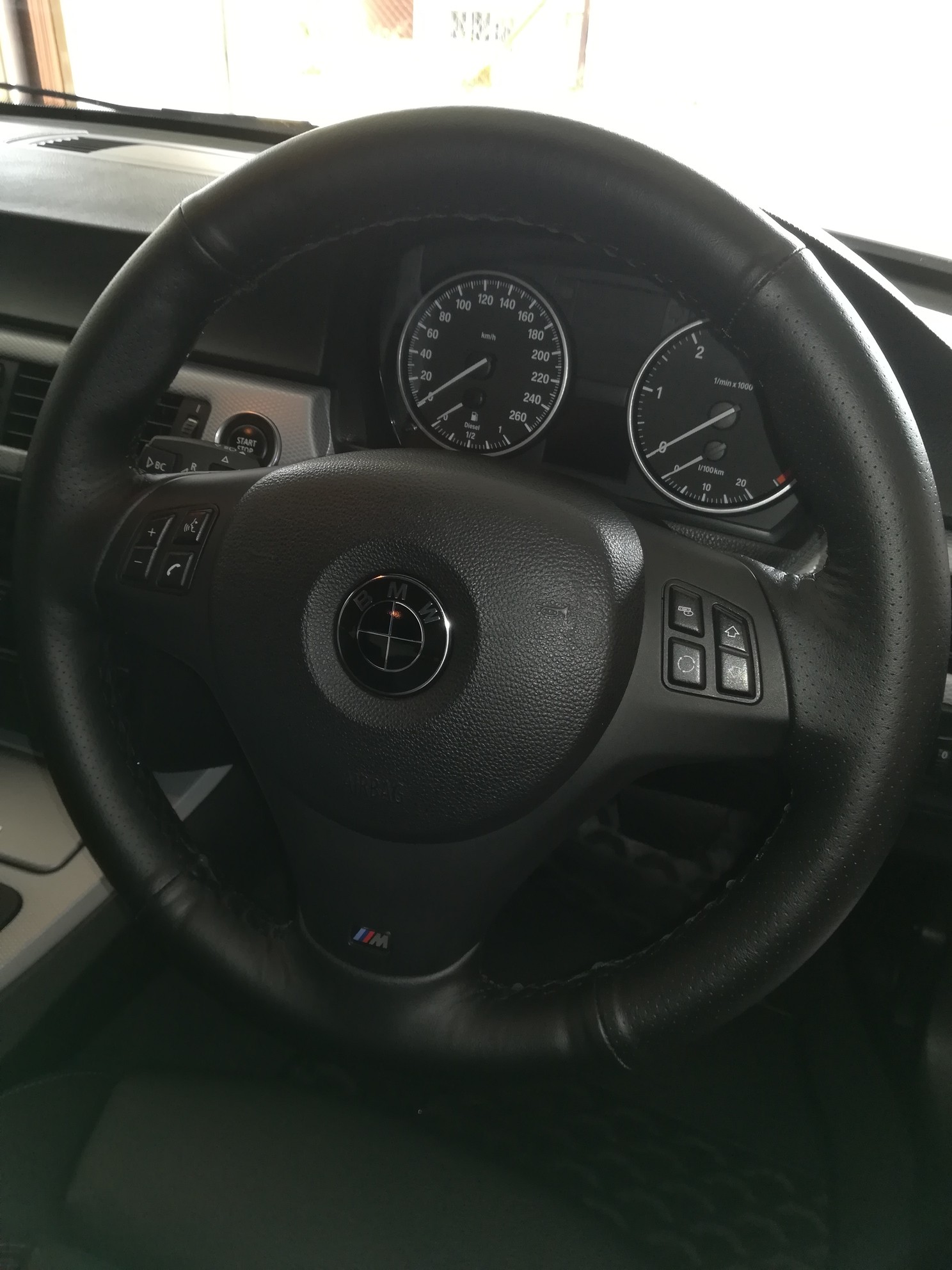

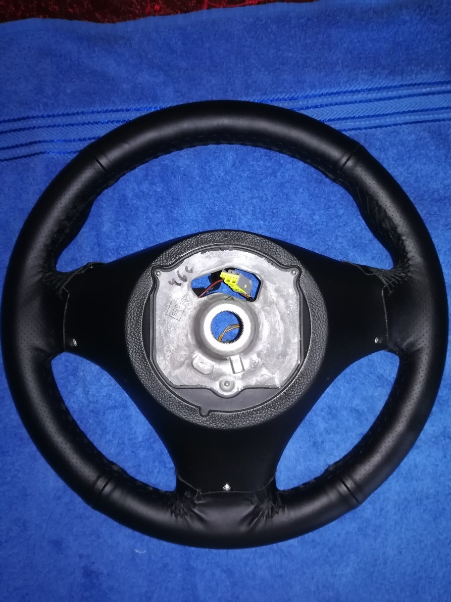

I still was not happy with the steering wheel leather cover. Especially the rear. There were creases at 6 o clock position. The leather was loose at the 9 and 3 o clock positions. Everything else was still perfect except for those 3 sections.
I undid the thread on those sections. Trimmed the bottom a bit and then glued those 3 sections down. Then restitched those sections.
Looks much better.

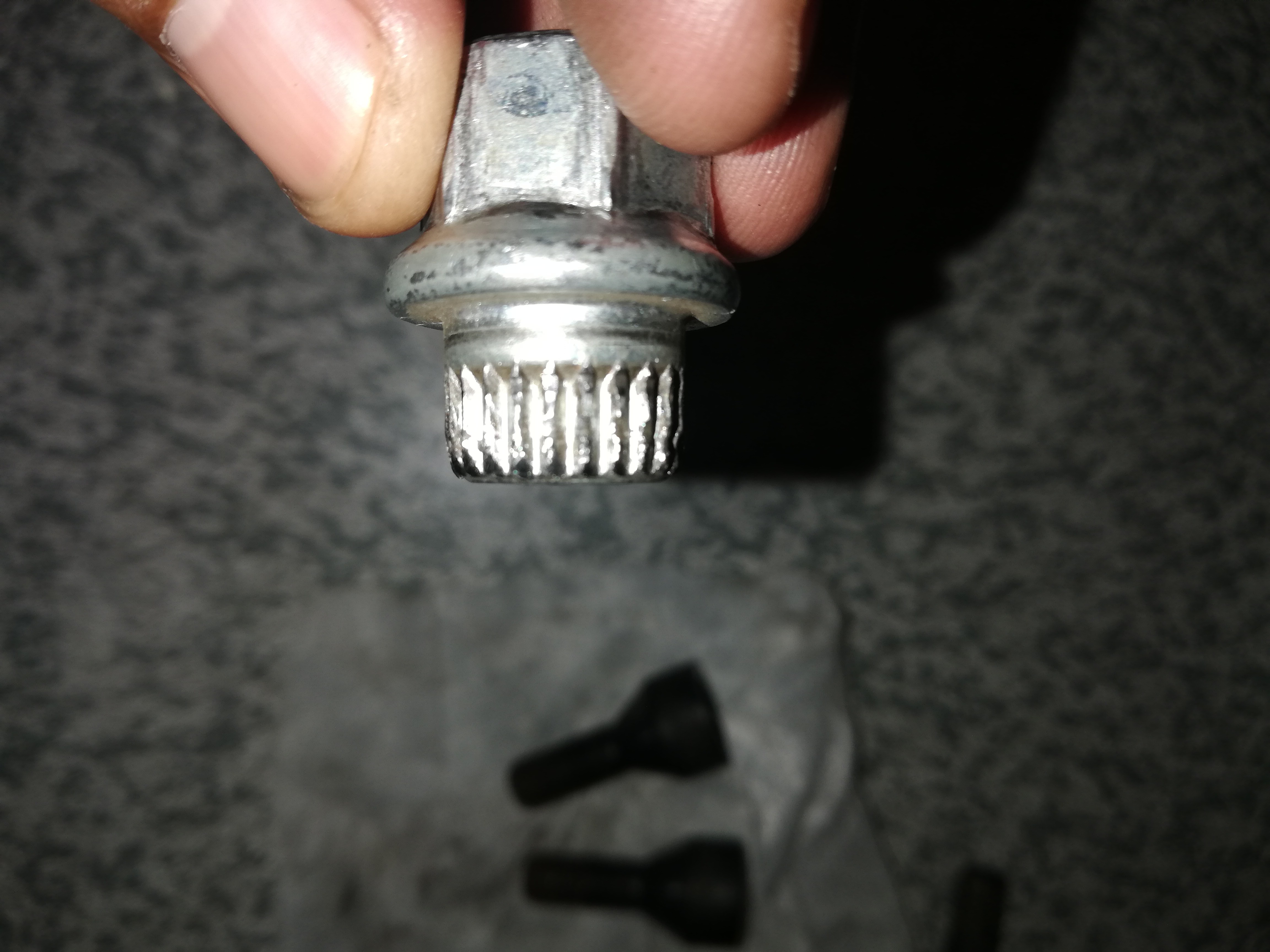

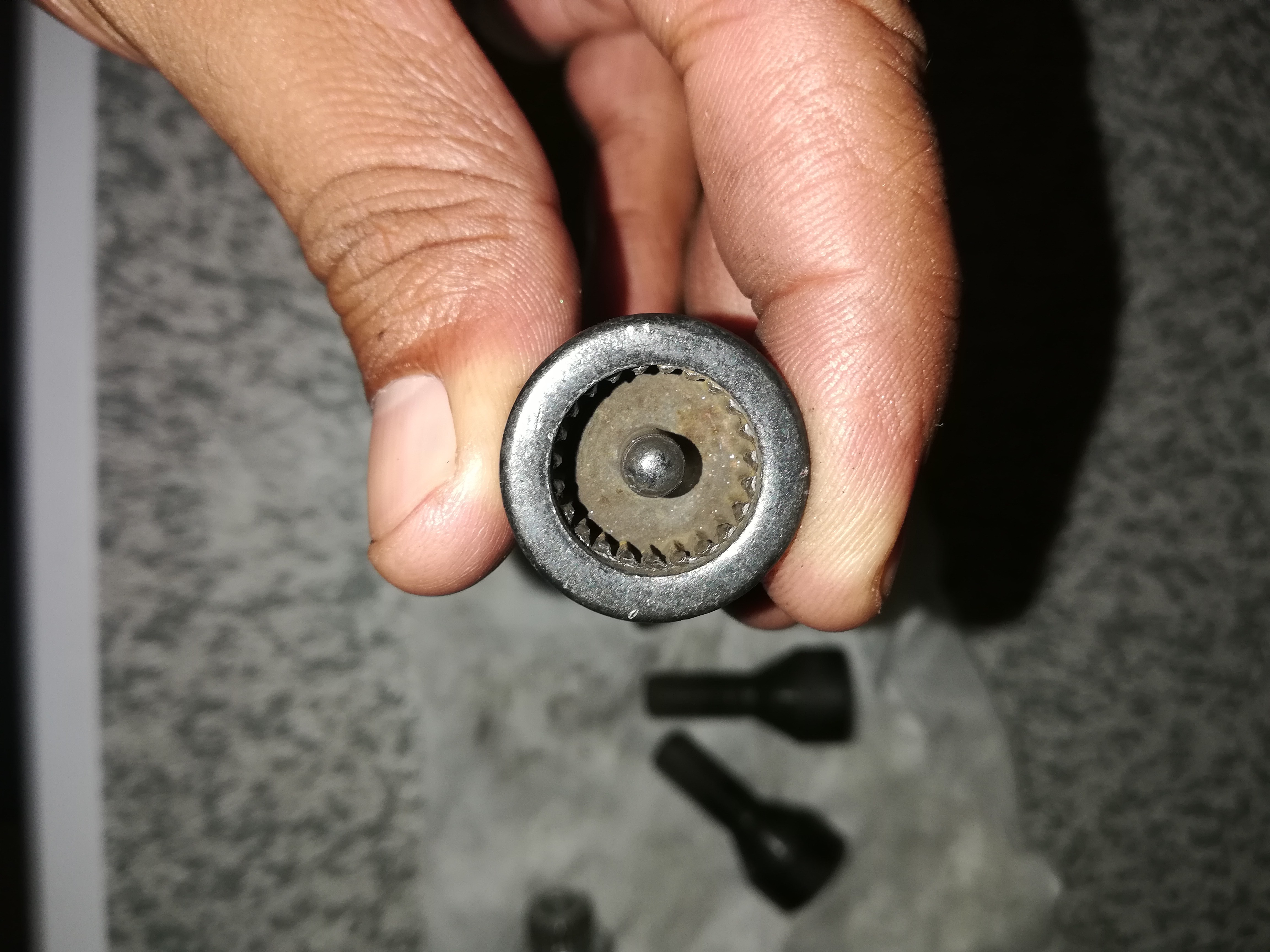

Got home and decided to loosen the wheel bolts and torque them as the guys at mintys did not when fitting the wheels on. The front right wheel gave me a problem as the lock nut kept spinning. I then noticed the damaged lock nut and lock nut key. I decided move to the other two and removed the lock nuts from rest of the wheels as l knew I would have to get a new set. Now I was in panic mode thinking how to get it off. Eventually after some research on the internet I decided to take a hammer and bang the lock nut key in. I just needed the lock nut removed so I wasn't interested if it got damaged in the process. After some time I managed to remove it. That was a relief. Now I have to go get a new set of lock nuts or maybe just normal ones.

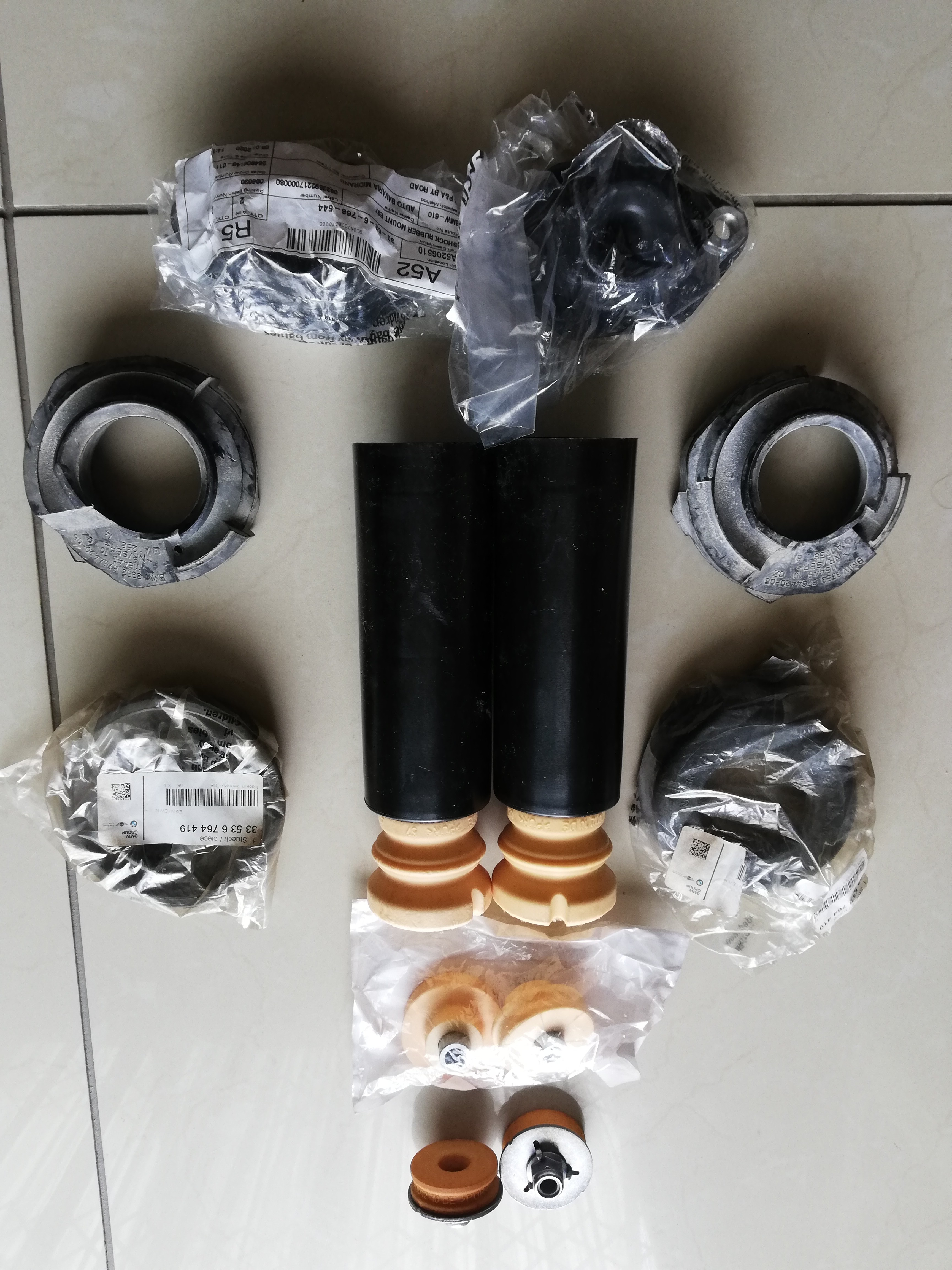

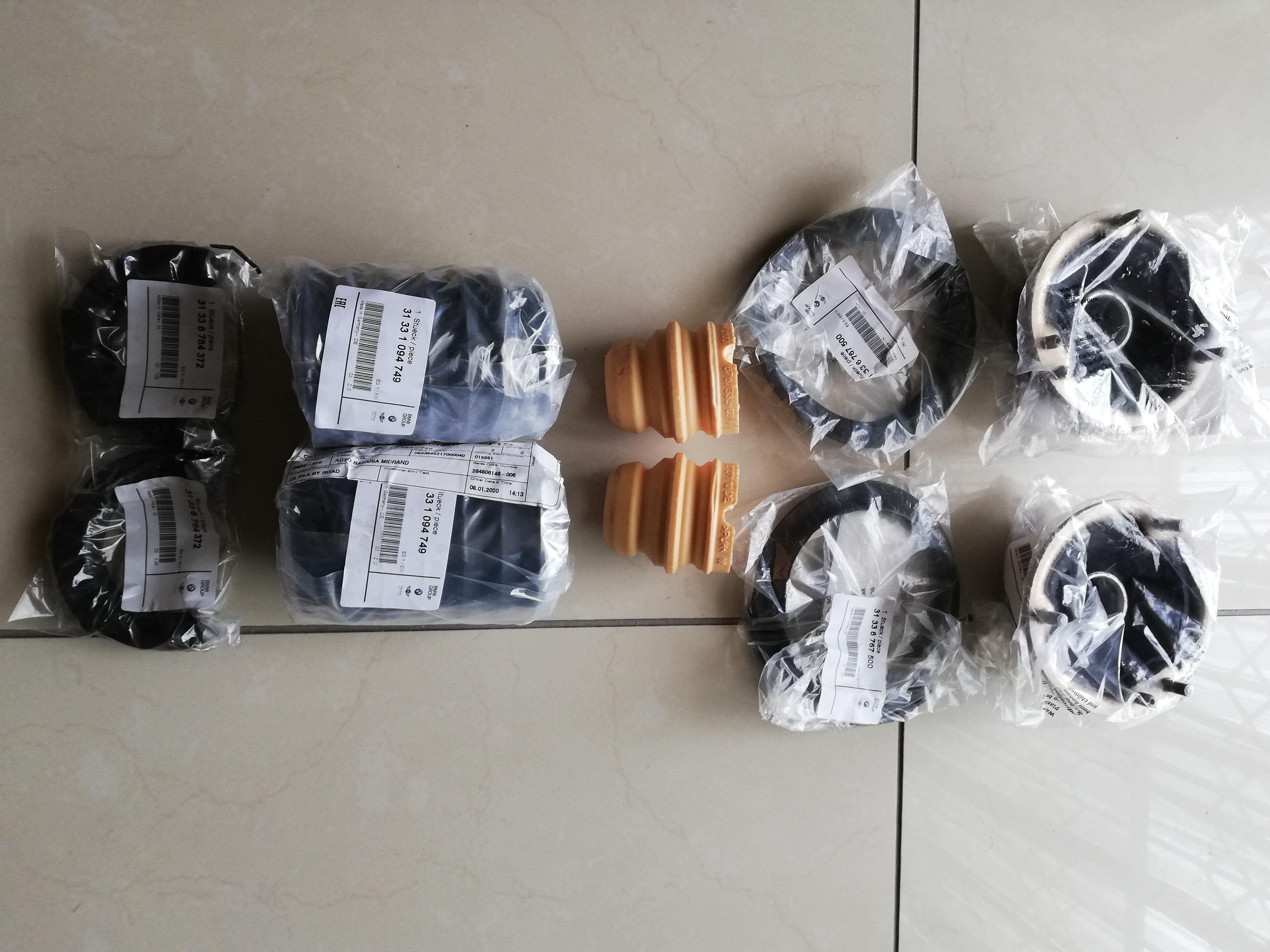

My suspension will sorted out soon. Got some parts from ABM.
Front :
Shock mounts
Upper spring pad
Bumpstop
Rubber dust boot cover
Lower spring pad
Rear :
Upper top shock mount
Upper bottom shock mount
Bumpstop and rubber boot
Lower shock mount
Upper spring pad
Lower spring pad

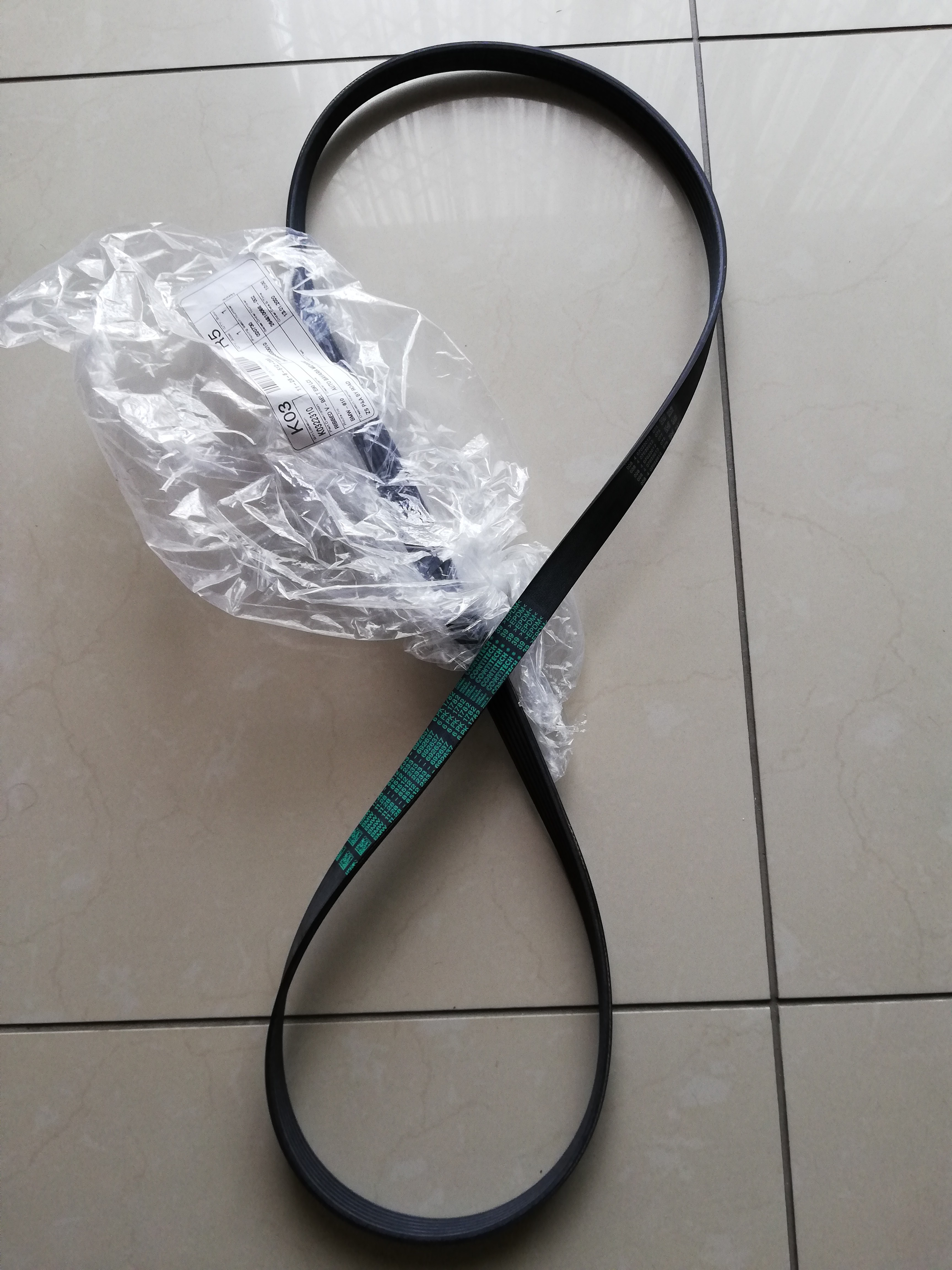

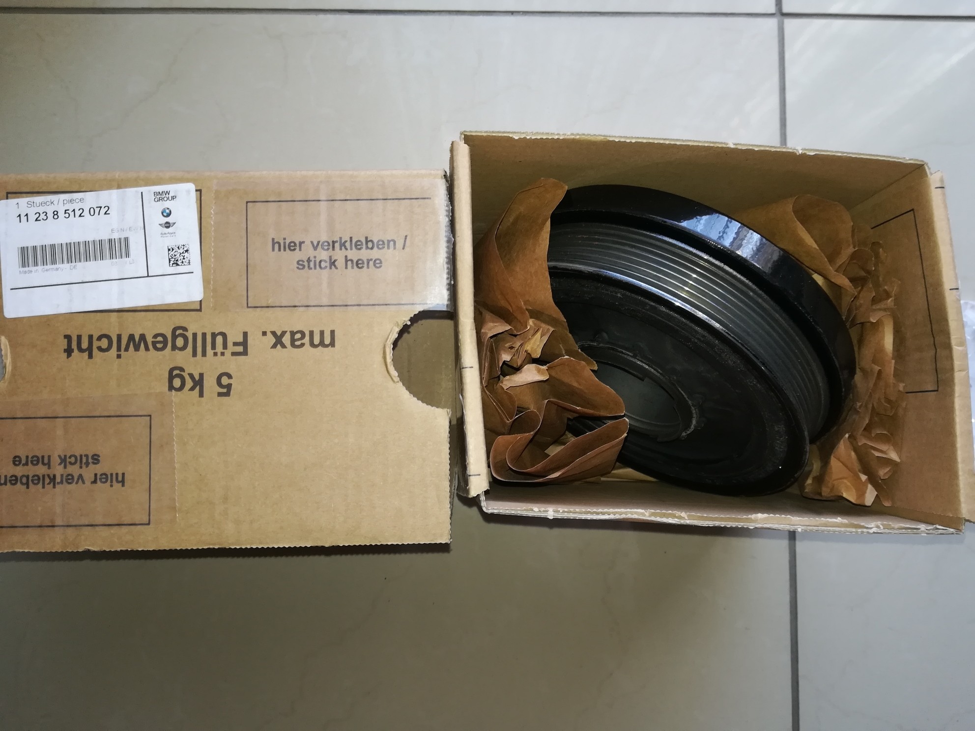

Also got 4 wheels bolts (normal ones) and a serpentine belt. Still have the vibration damper pulley stored away.

Also had the vibration damper pulley and belt changed.

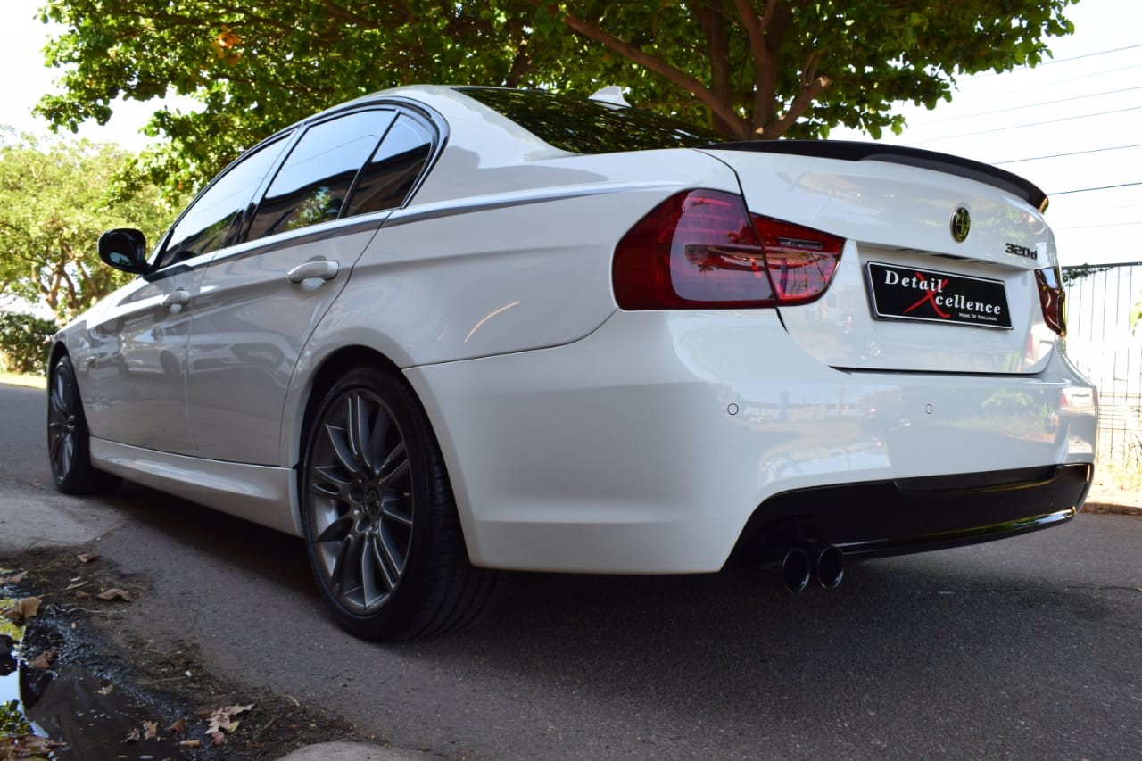

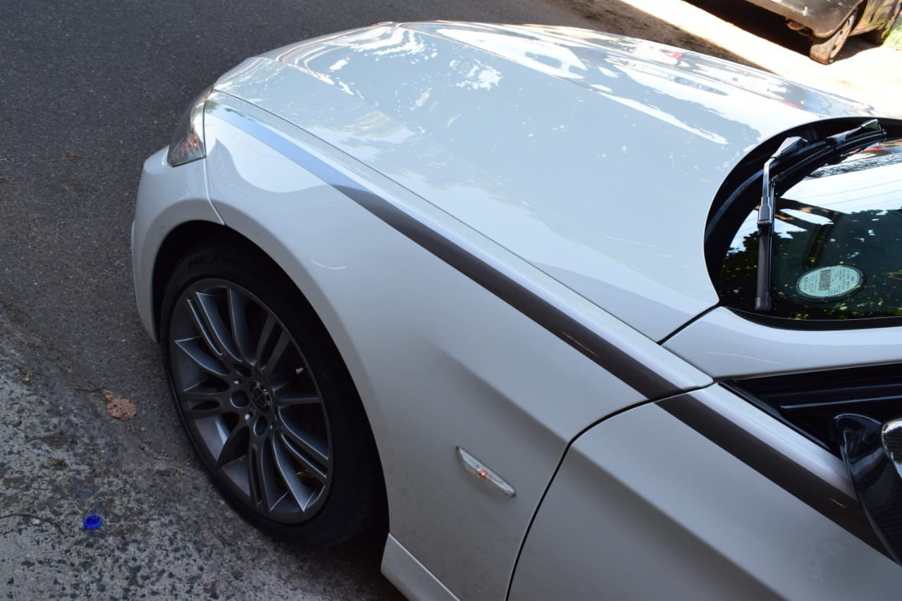

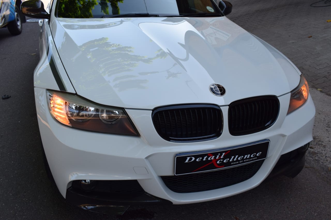

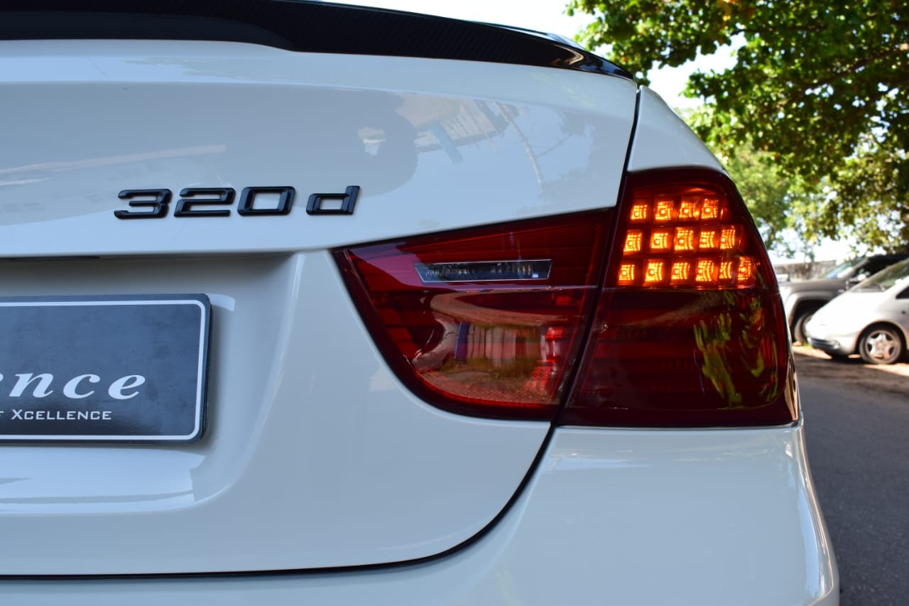

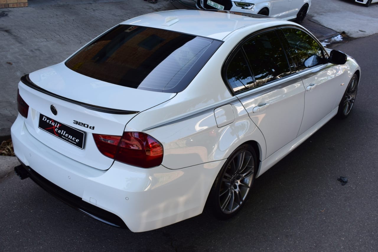

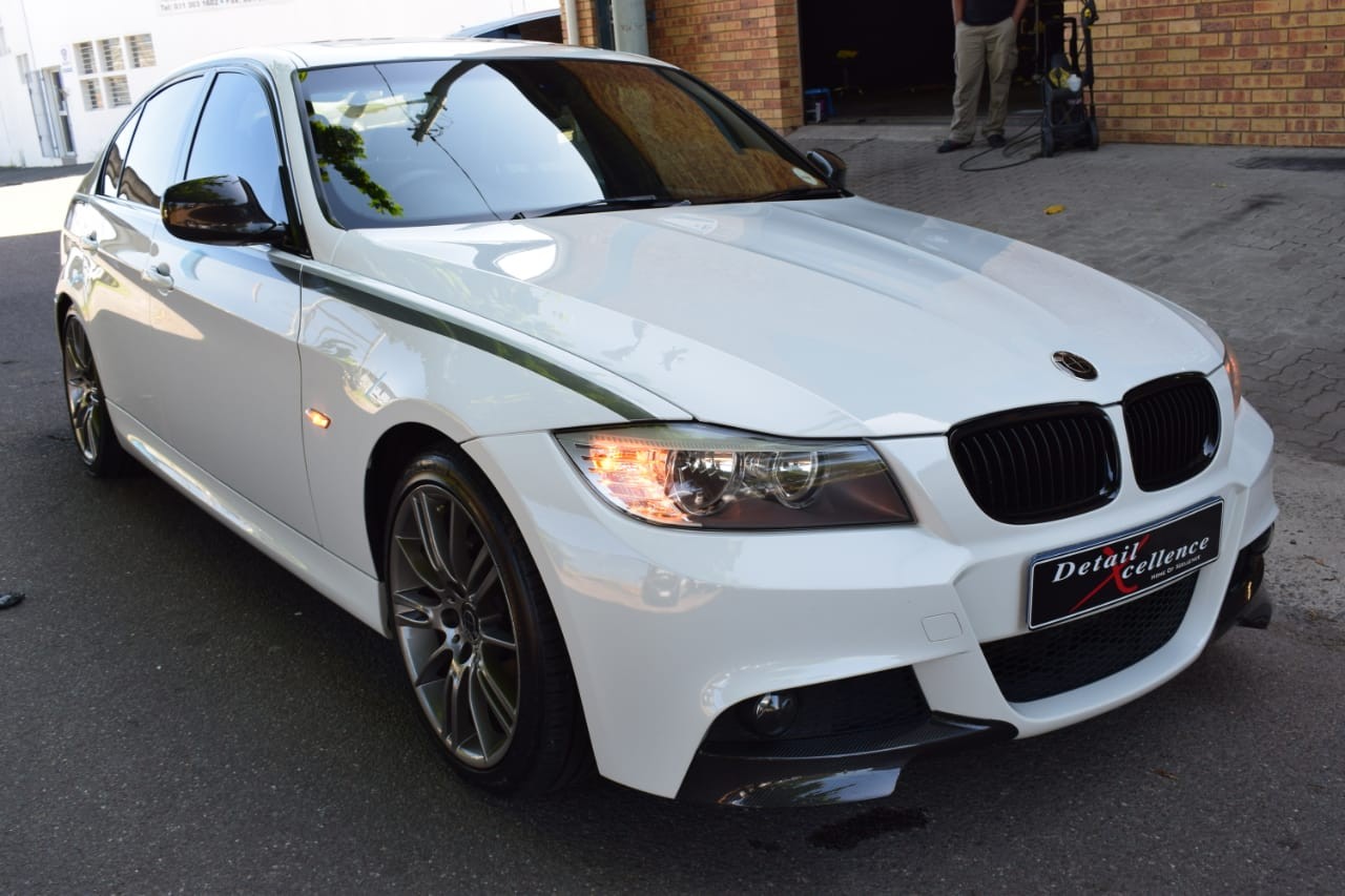

Yesterday I took the car to Detail Xcellence for a minor update on the paint work. It was much needed as the last time it was polished was in December 2016. As much I wanted to do a paint correction and ceramic coat I couldn't because of the time the process takes. So just a wash, clay, single stage polish and wax was done. I also replaced the ppf on the front splitters and added some tail light tint. Overall I'm happy with the results.

Love the tint on the lights man - something I wanted to do on both cars for some time now..

Where did you get those badges black from?
