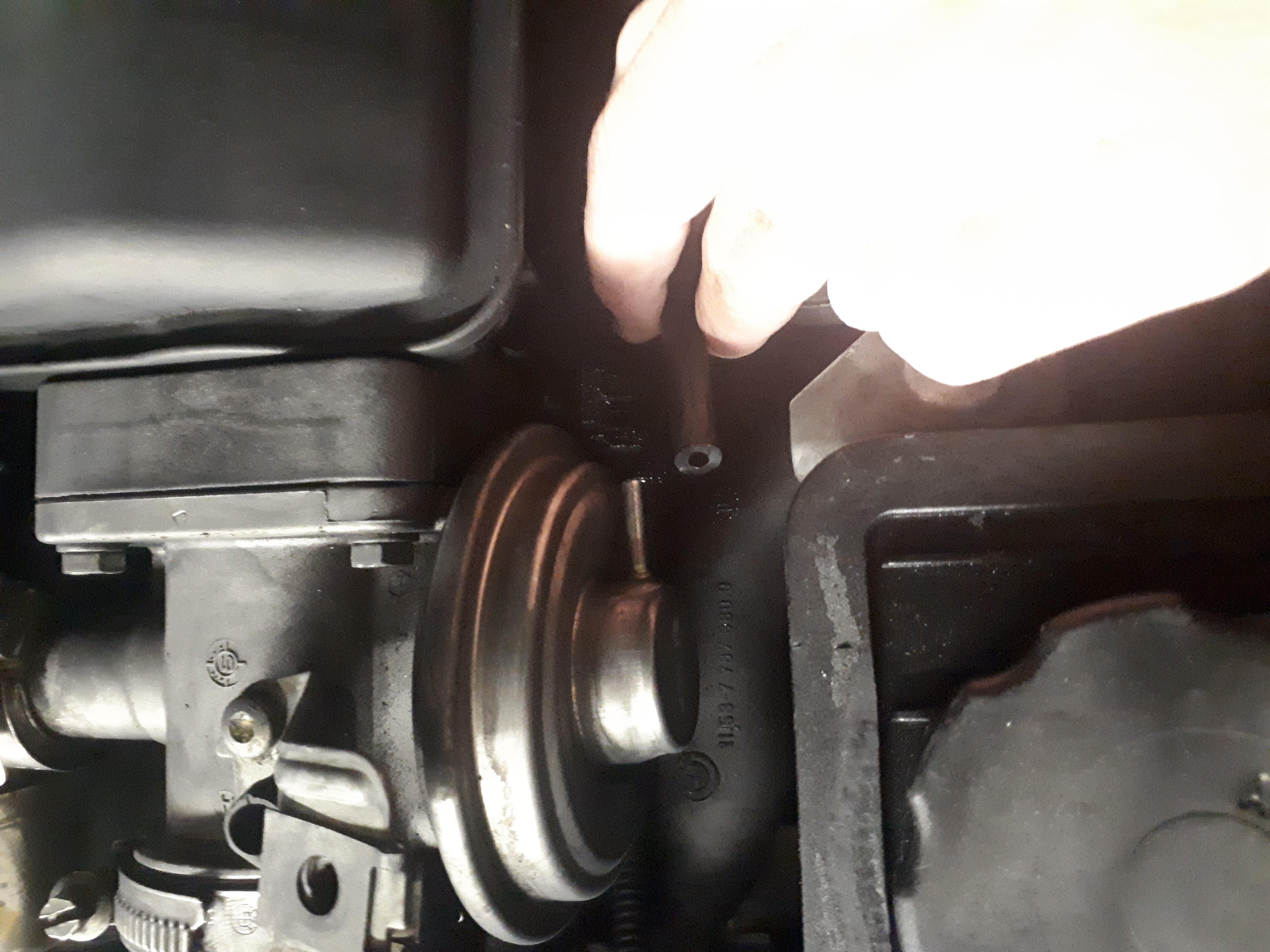

I have a problem with my car, i have posted before about the DDE warning but i found a pipe that had come off , looks like a small rubber air pipe that fits on this round thing wich is part of what looks like a throttle body. Put the pipe back and the car dosent start just white smoke, so it wes off for a reason.
I will appreciate any help i can get to fix the car

Yes, please block off the pipe as it is a vacuum pipe and the engine is leaking vacuum through it. Just plug it with a nail or something similar. The egr valve is fine without the pipe connected as it prevents it from opening and thus no more bad gasses from the exhaust going through your engine. I would also as soon as possible remove the swirl flaps in the inlet manifold as they are prone to breaking off and being eaten by the engine. Big repair bill if that happens! Google swirl flaps for further info.
Spannie
Take the EGR off and see what's wrong with it, may just need a clean. Strange that having the EGR valve plugged in would cause a no-start situation, hows the condition of the other vacuum lines?

I just bought the car so im not familiar with the engine, i will check all the pipes and clean the egr
I will post later on what the outcome was
