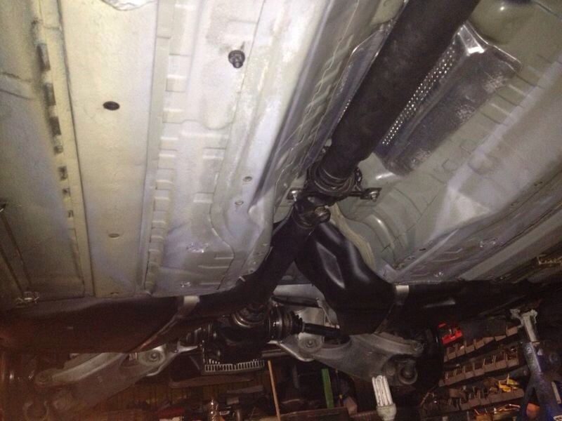

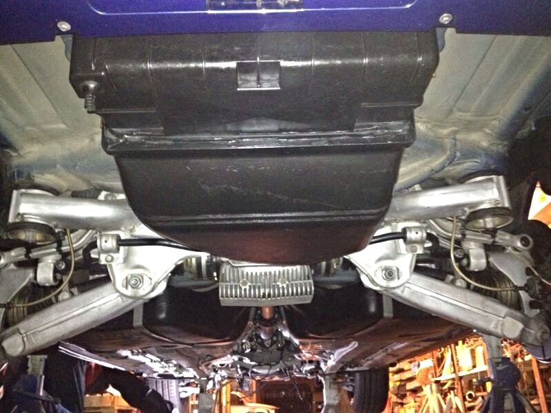

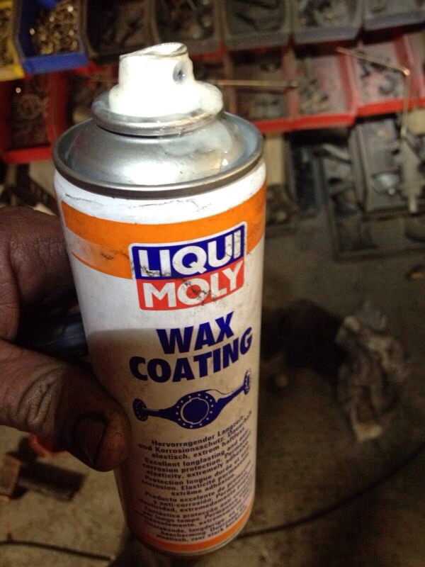

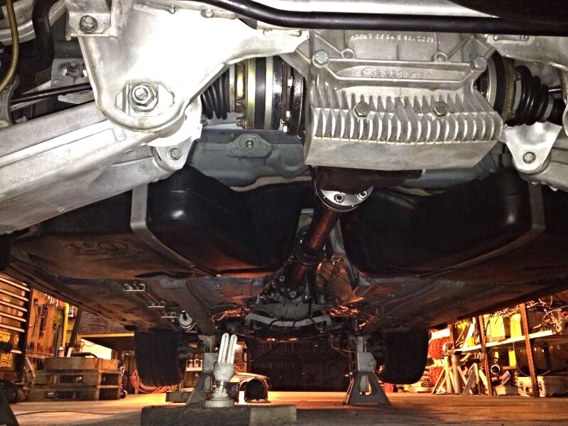

M5 under carriage finally finished this morning
Making sure she is sealed and protected from the elements and good to go a zillion K's

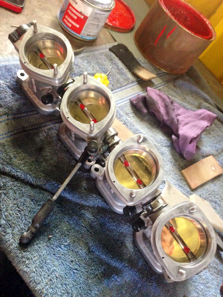

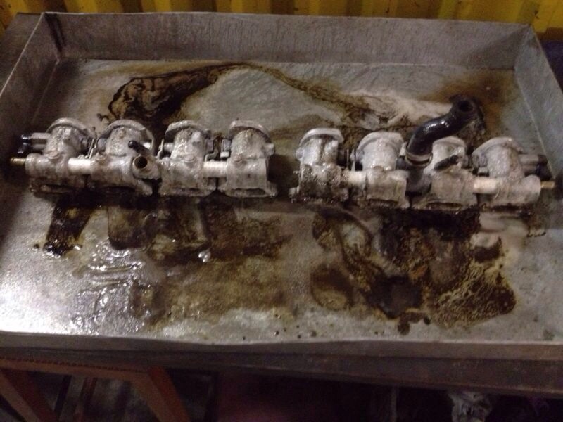

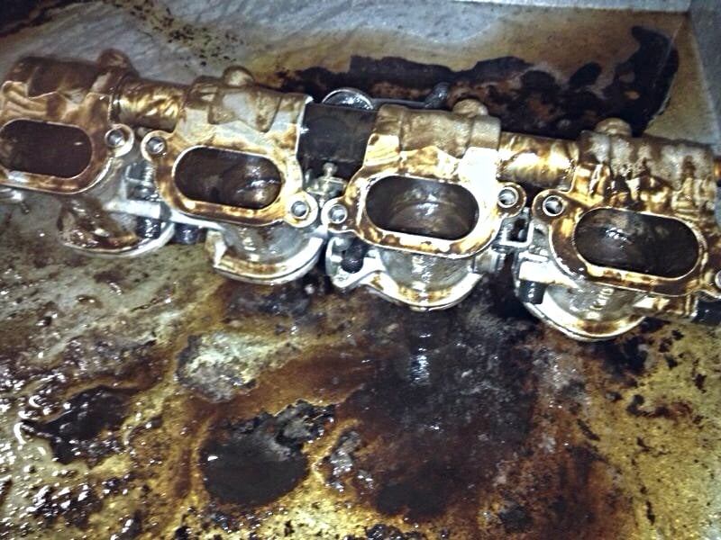

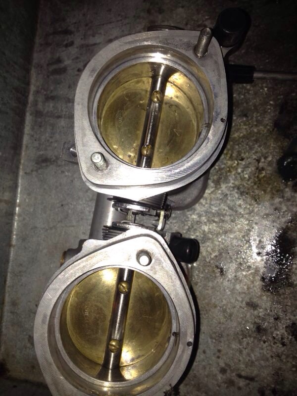

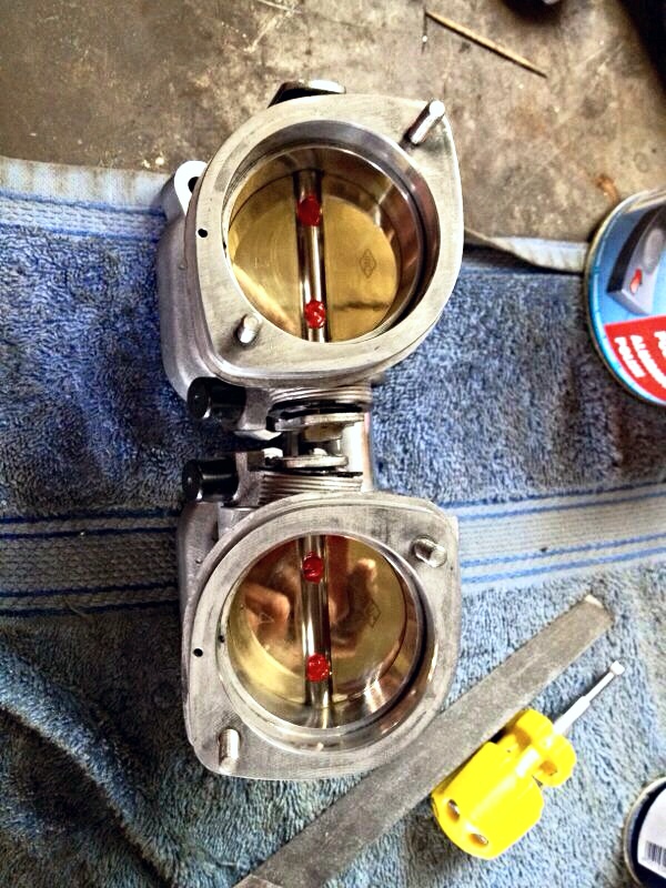

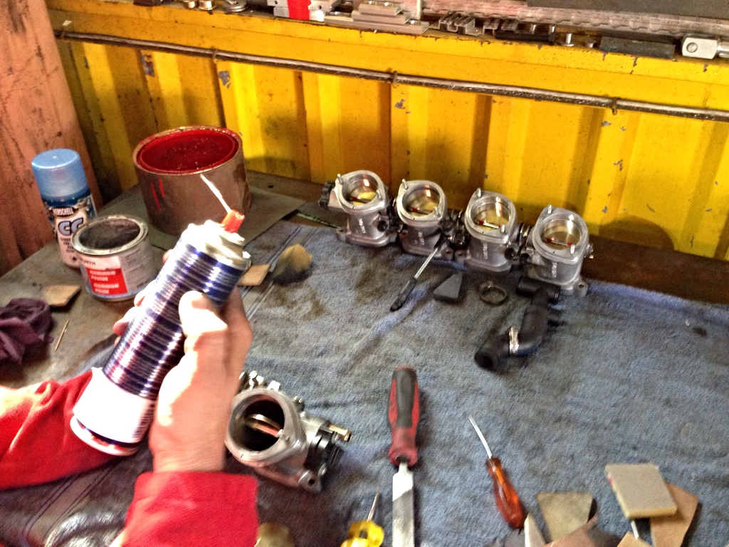

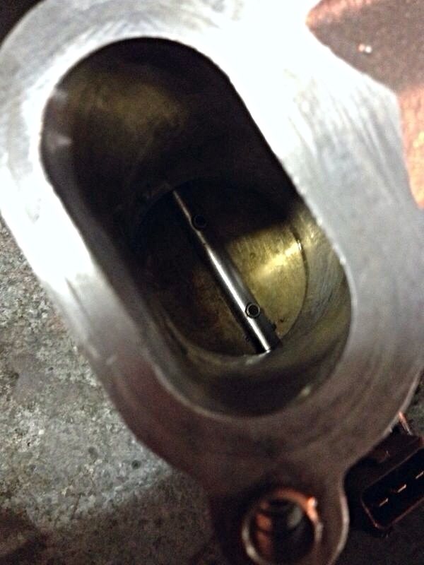

Some progress on Throttle Bodies
Finer cleaning by hand/finger lol
Finally seeing some light after Bruce's work he says.
They ready now for polishing stage from photos below. One more day and they going to be mirror finish perfect.

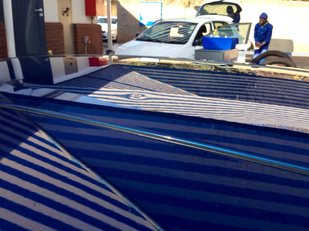

So I got caught driving amongst the striking engineers/metal workers this week.
Scary as hell experience.
They leave me with a token of appreciation. (One of the strikers decides to hit the top of the M3 with his knobkerrie)
Took a lot not to get out the car and take on 300 plus strikers.

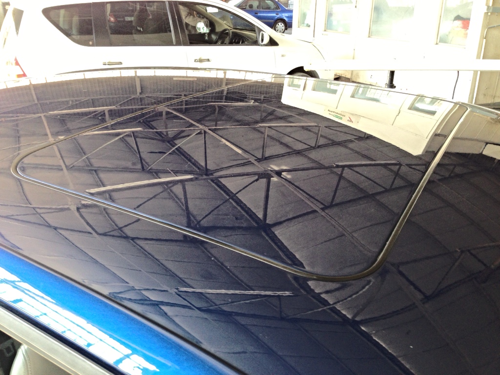

So off to dent doctor... Thankfully they were able to pull the dent.
Left it unpolished from them, as Bruce is still to do the polish and seal post spray and before protective wrap.
Man I was livered..... 😈

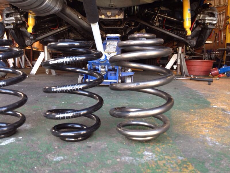

Some fender rolling and lowering Sunday
And off we go.
What a sexy ass she has
We started rolling.... Only to realize that BMW used sealant and some type of rubber in the fender
Fenders now rolled and re-sealed with Polycell rust cover and primer.
255 Wide rubber here we come

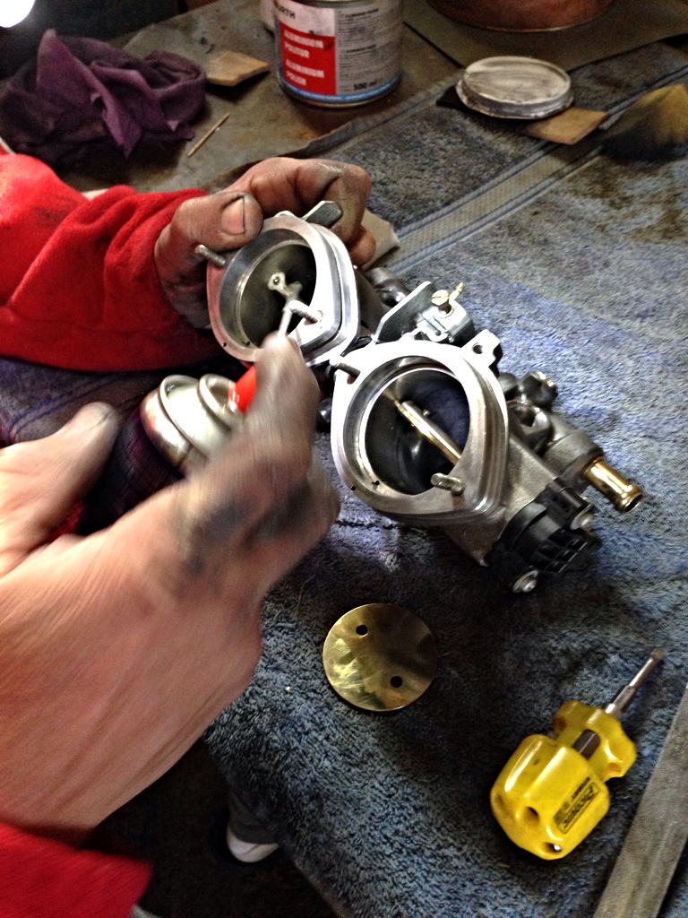

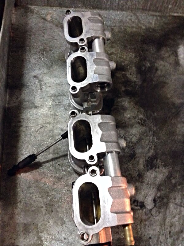

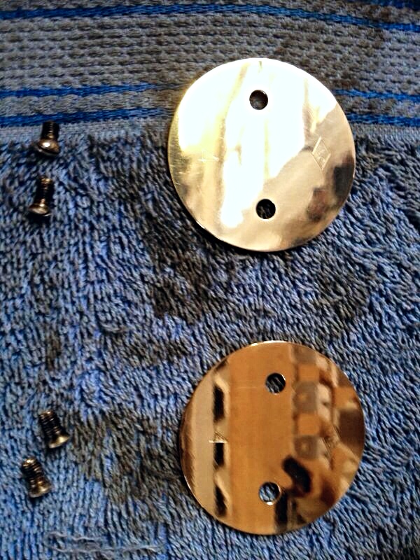

While I got the fenders done. Bruce was Finishing up on the M5 throttle bodies
Throttle butterflies ready
Bruce fitting butterflies and lining them up
Rear end pic polished up
First set ready
All coming together nicely
moranor@axis
i would be worried about taking the throttles apart for fear that they somehow come loose and get eaten by the engine :yuck:
Great work polished inside and out :rollsmile:

Fordkoppie
If this was a direct injection engine, then sure, but on a normal port injection engine one makes it less efficient by polishing the intake ports.
It looks all nice and shiny, but it will actually be slightly worse.
All this effort in the exhaust ports would have yielded much better results
:sorry:
Elton_LV
:sorry:
Bruce and some other mechanic were actually discussing it, so you could be right, I do know that there are certain areas you do not polish as you want turbulence/friction (can't remember exactly what they were saying)
Either way. I'm chuffed with progress

Peter@AEW
Agree with Chris on the inlet being rough and exhaust smooth.
All the same it is pretty.
