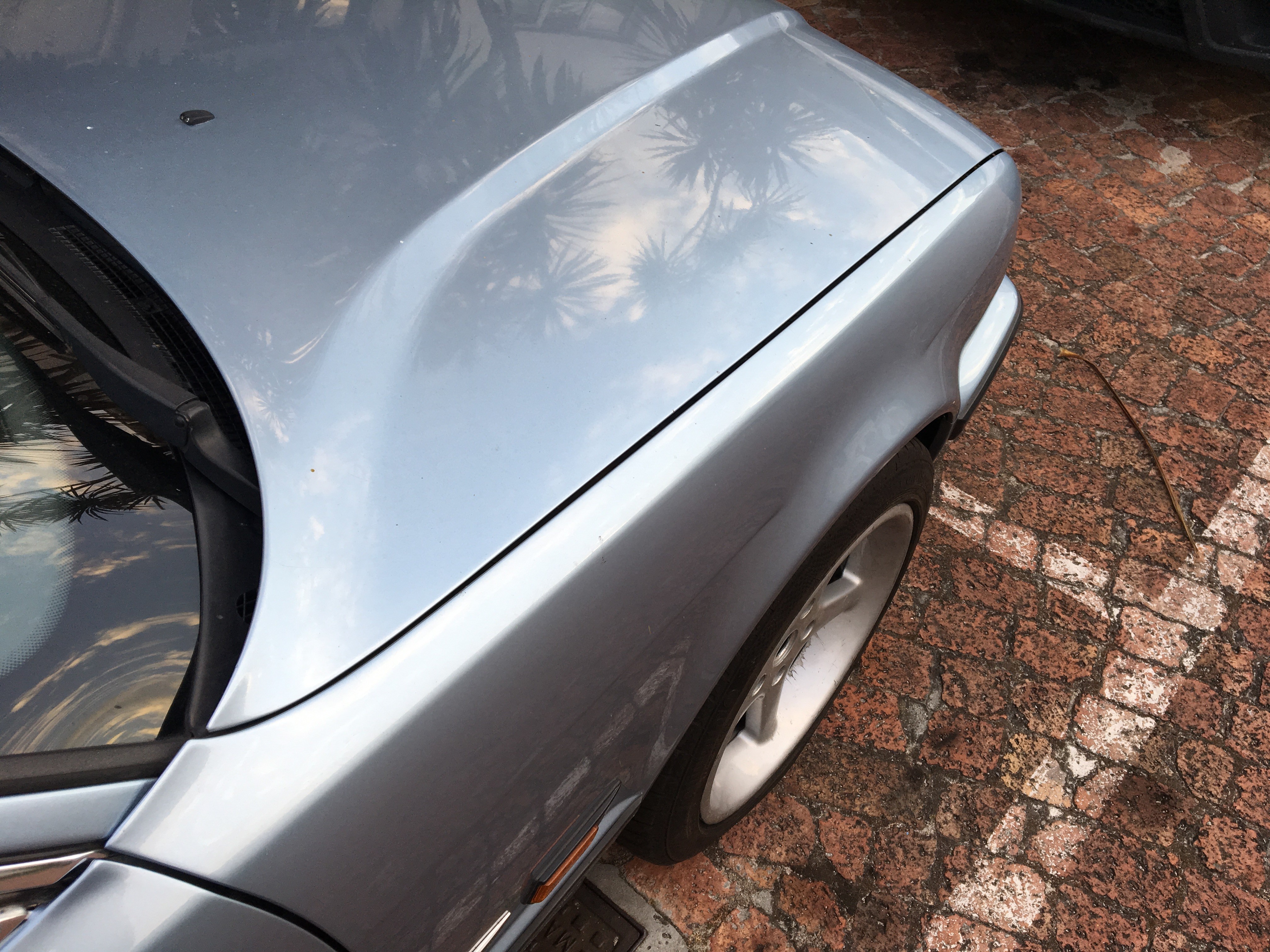

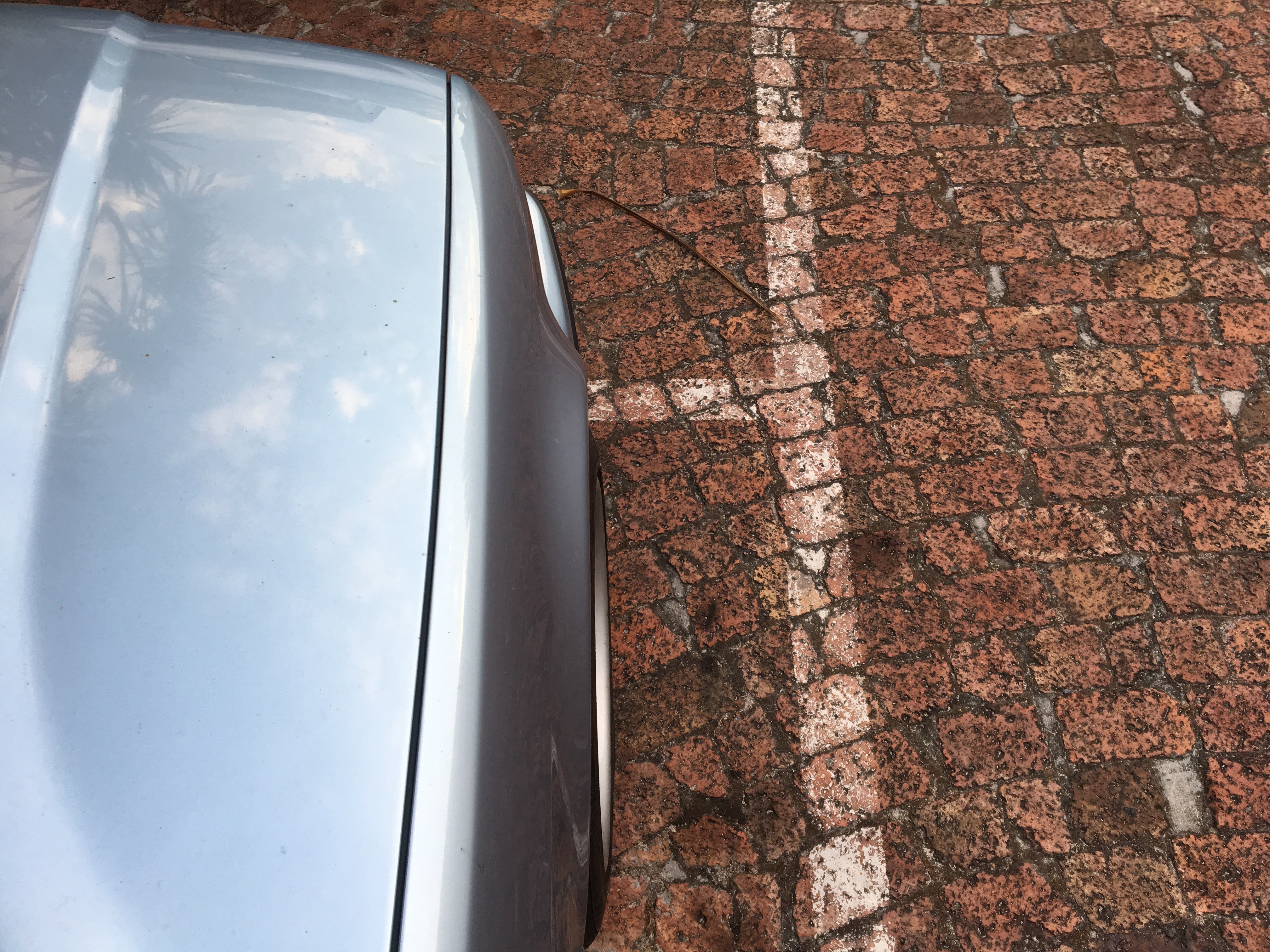

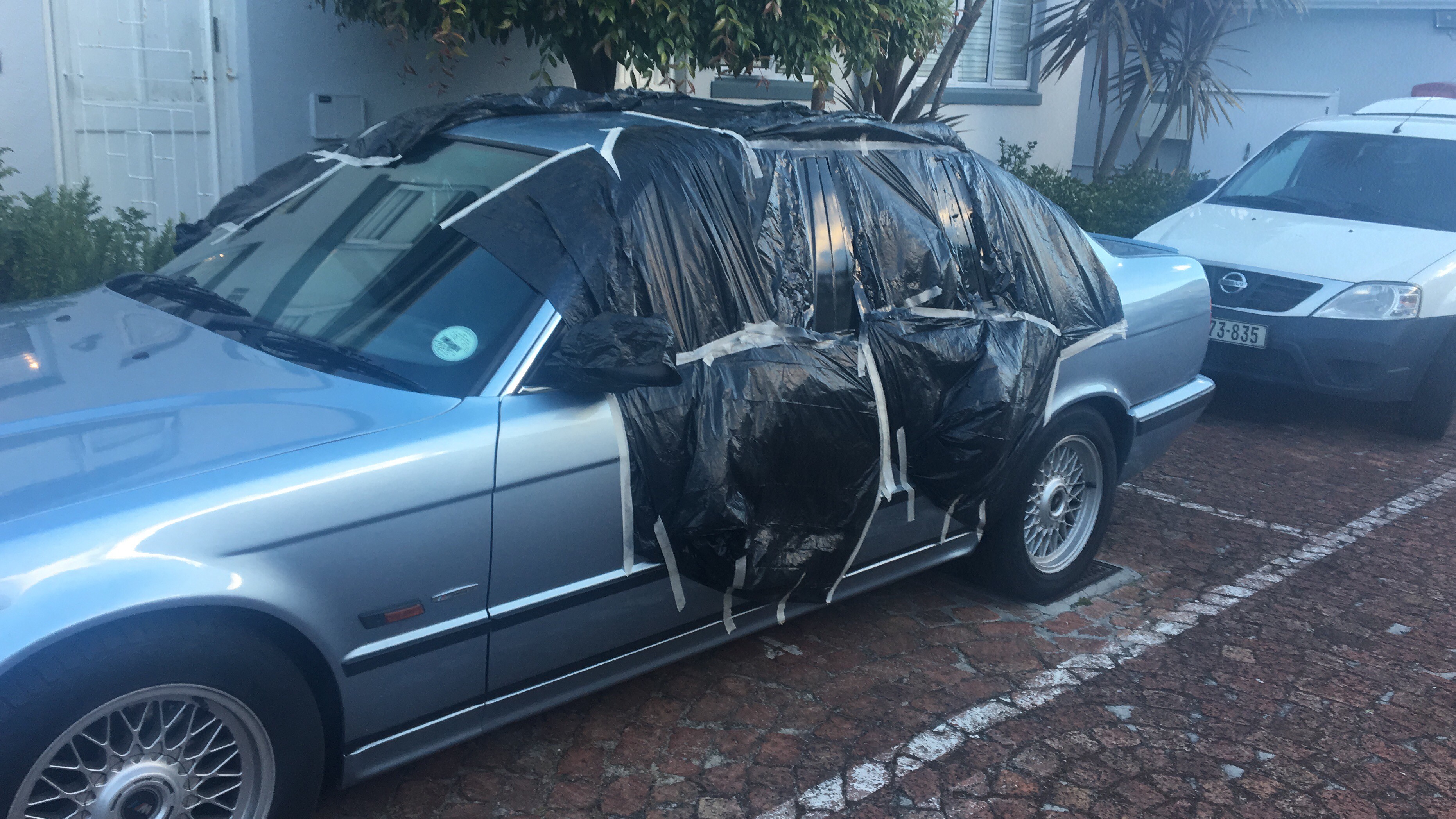

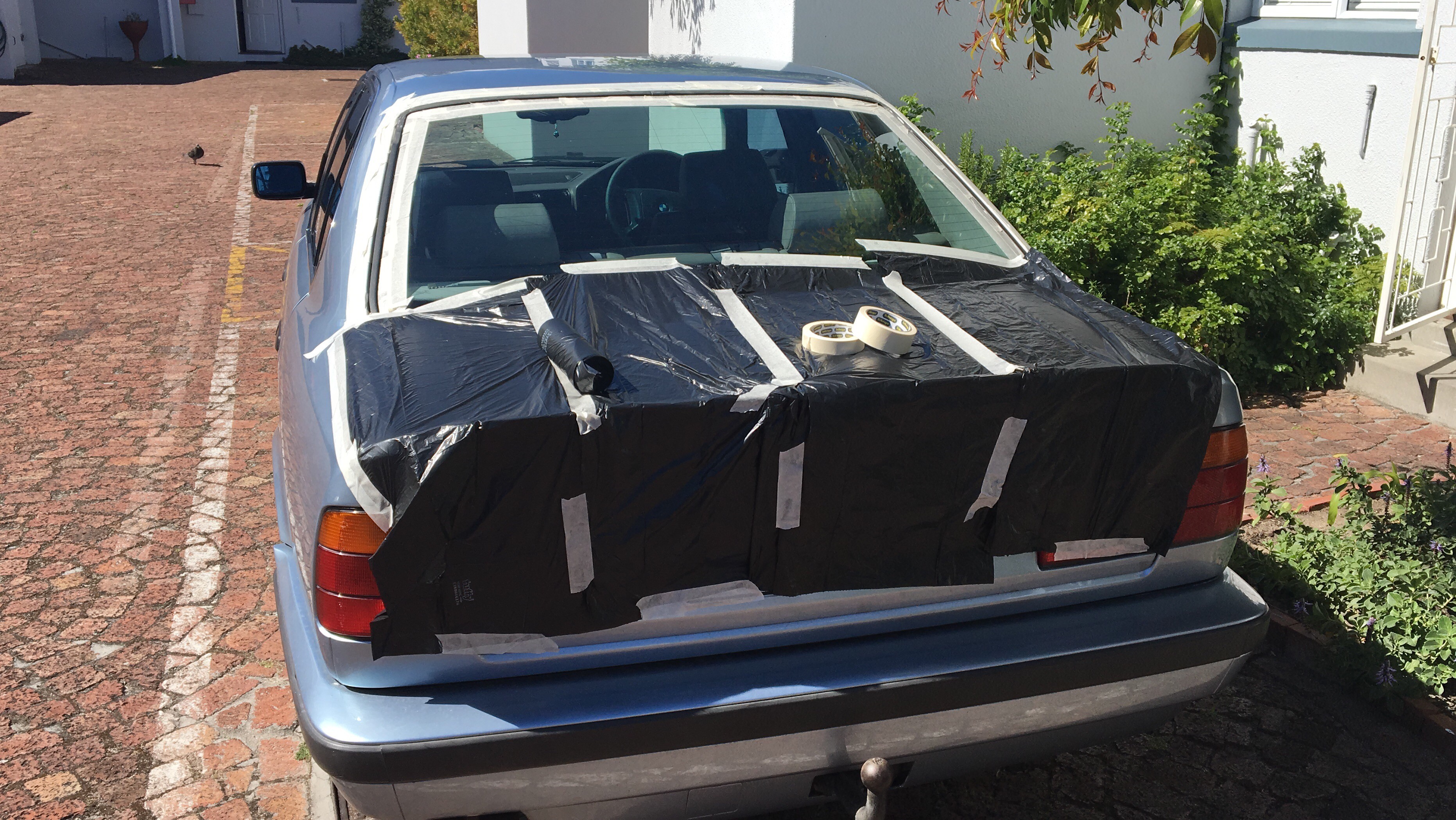

Some pics from the other day painting some chips on a few of the trim pieces
Ricky318i
I'm busy with that part of my car as well. I'm doing it gloss black. The B-Pillar tends to chip/corrode at the bottom where it meets the door.
Good luck.

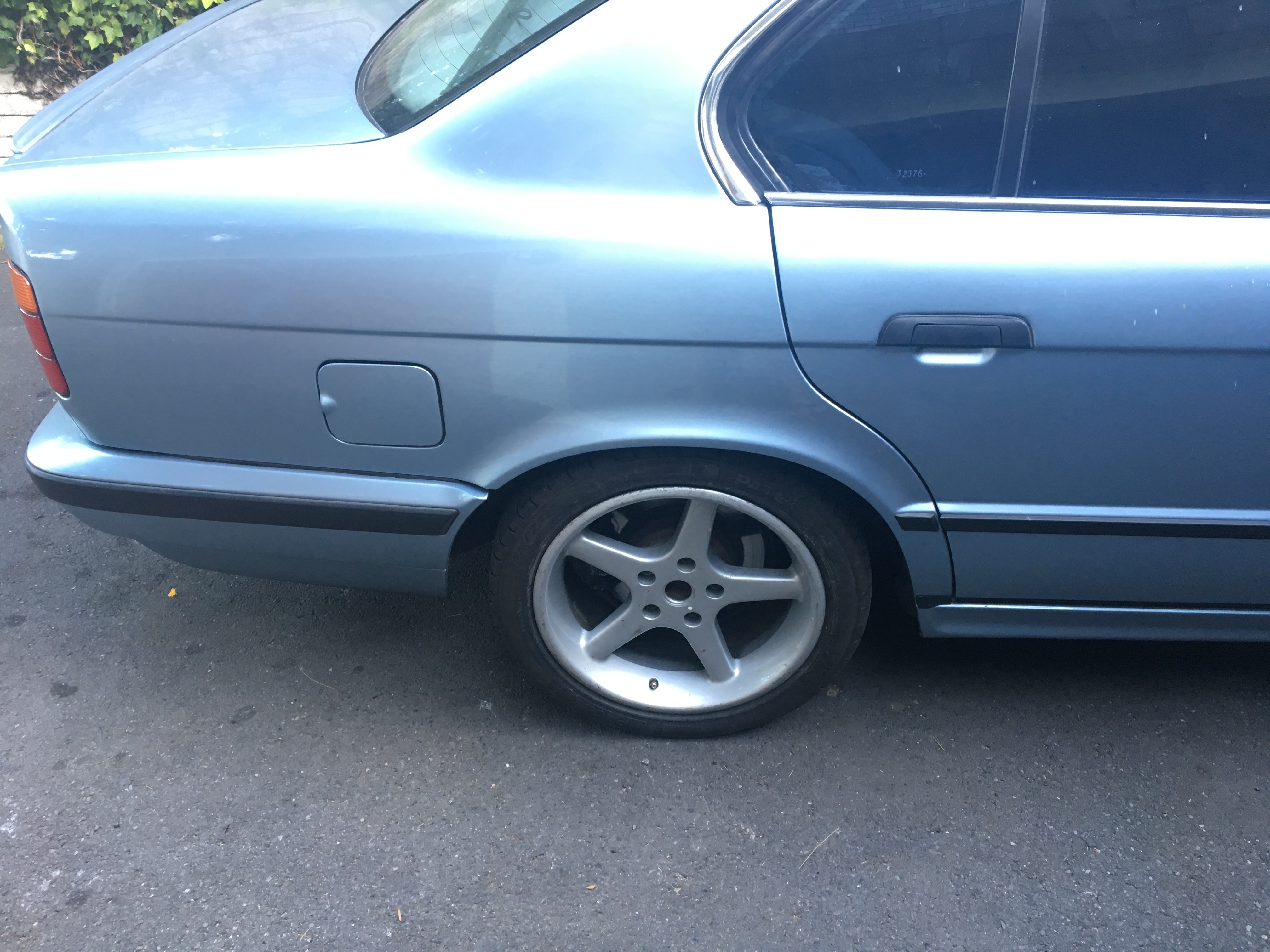

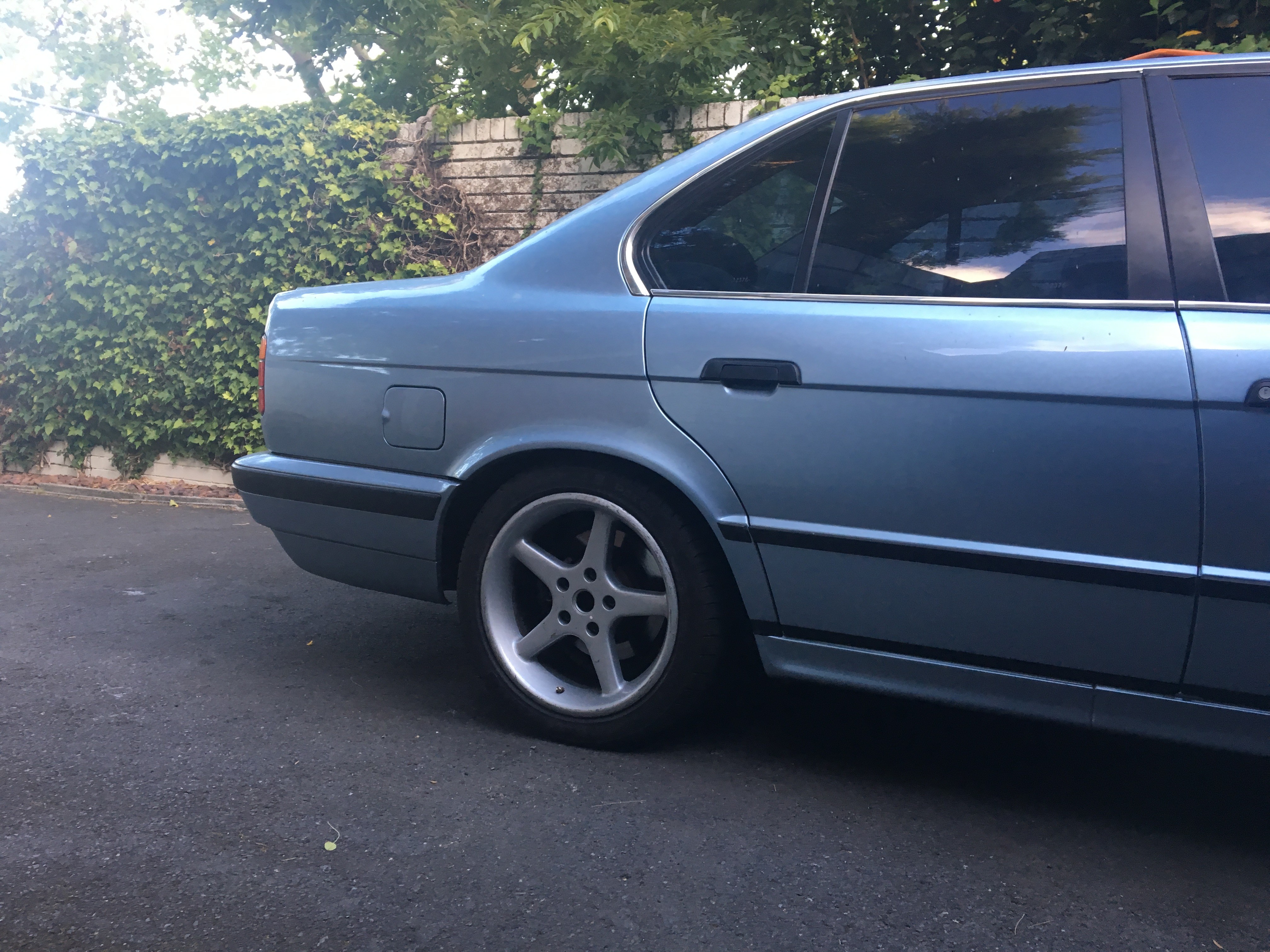

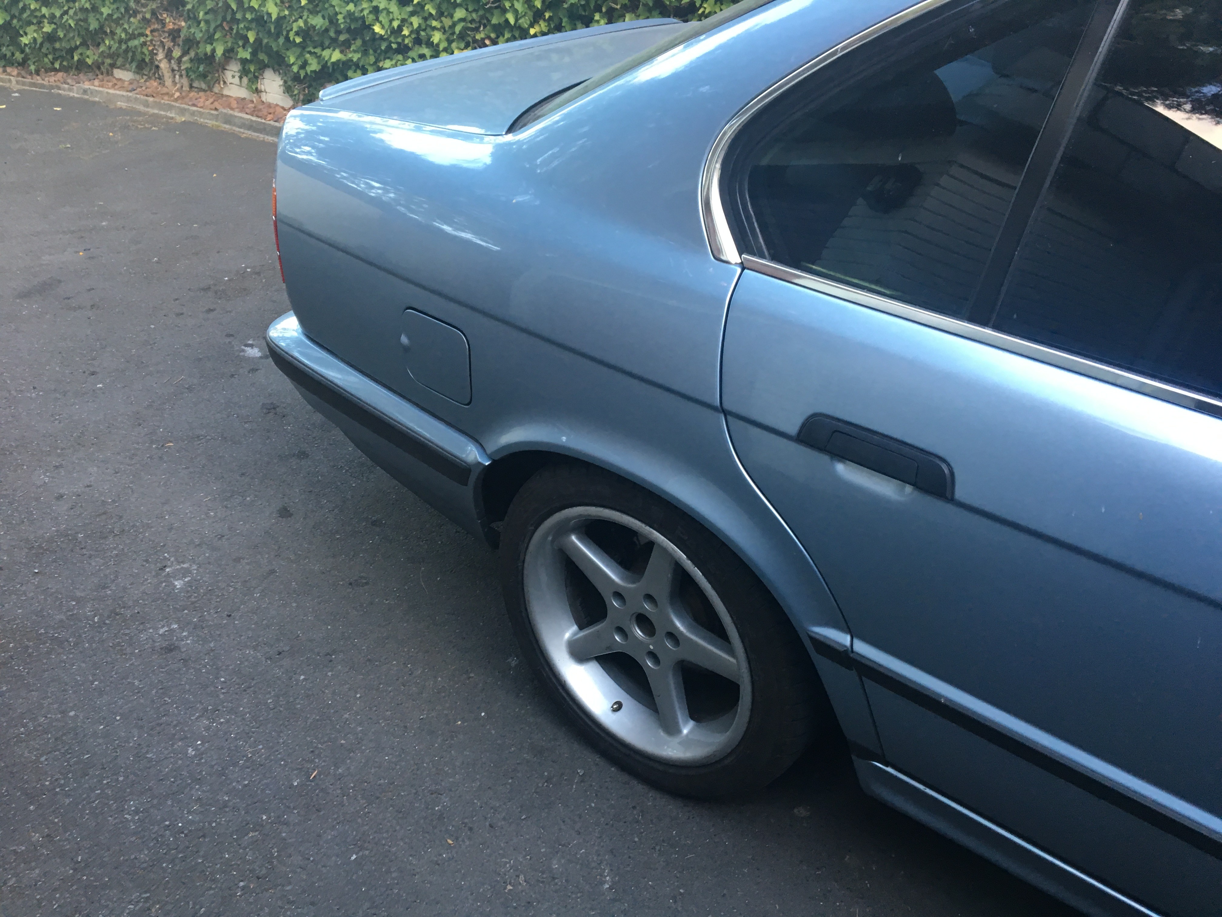

Fitted my rear wheels, but need spacers for the front:blueCry: they are hitting the shock body in the front
8j et15
8j et33
225/45/17
245/40/17
Want to go 245 all round when I get new tyres,
I think the style fits the car well
Need to refurb them, thinking going gun metal grey with them, or stay silver
rodga
Looks good. Keep them silver bud. Darker colour will make the look smaller imo

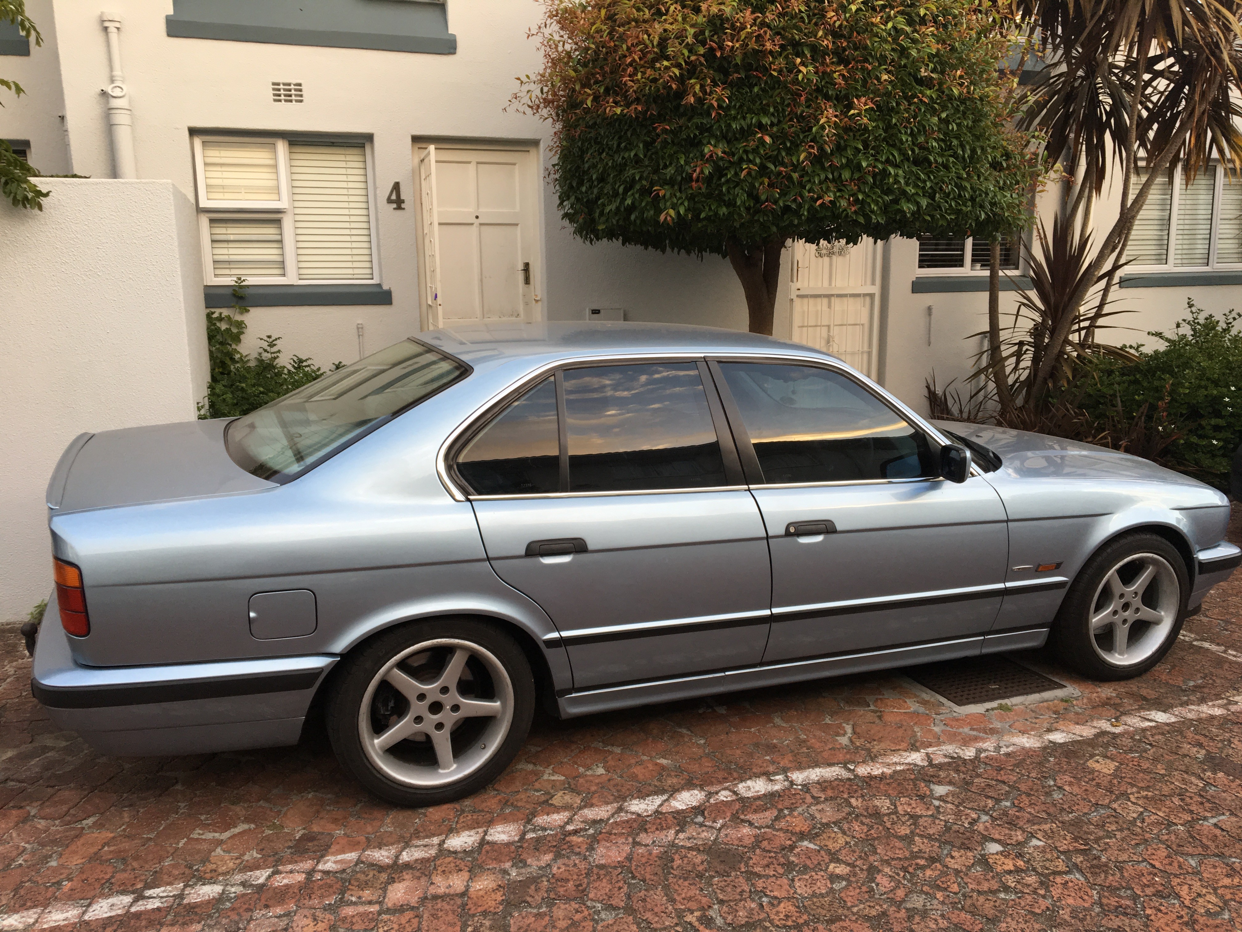

nirvash

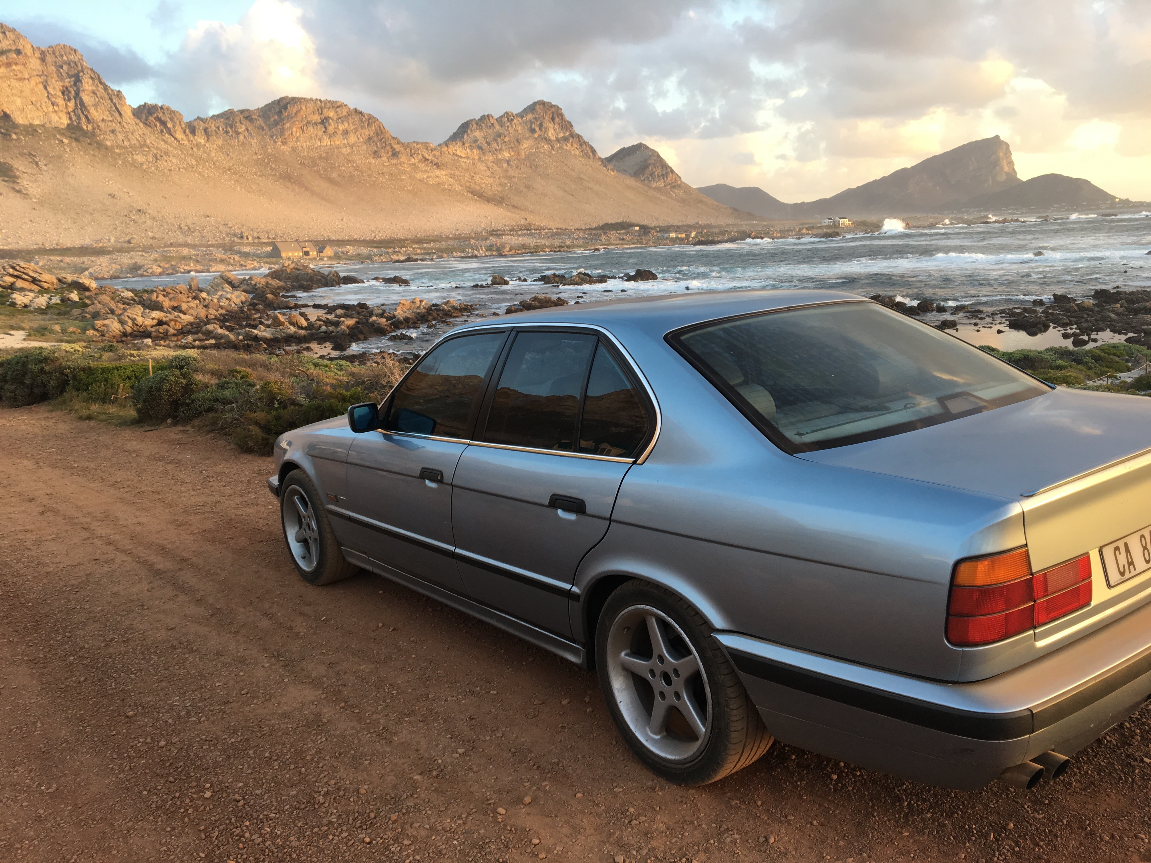

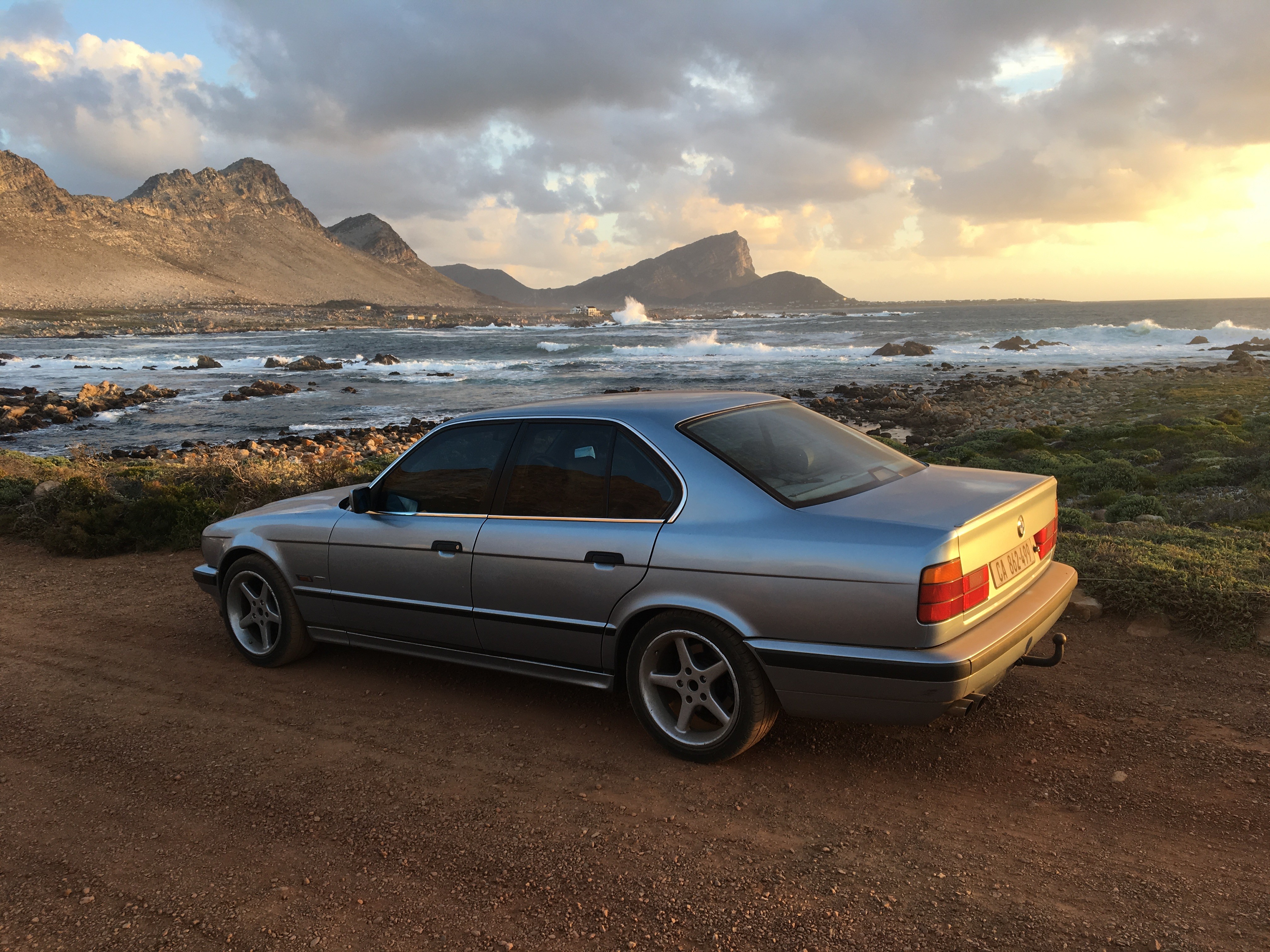

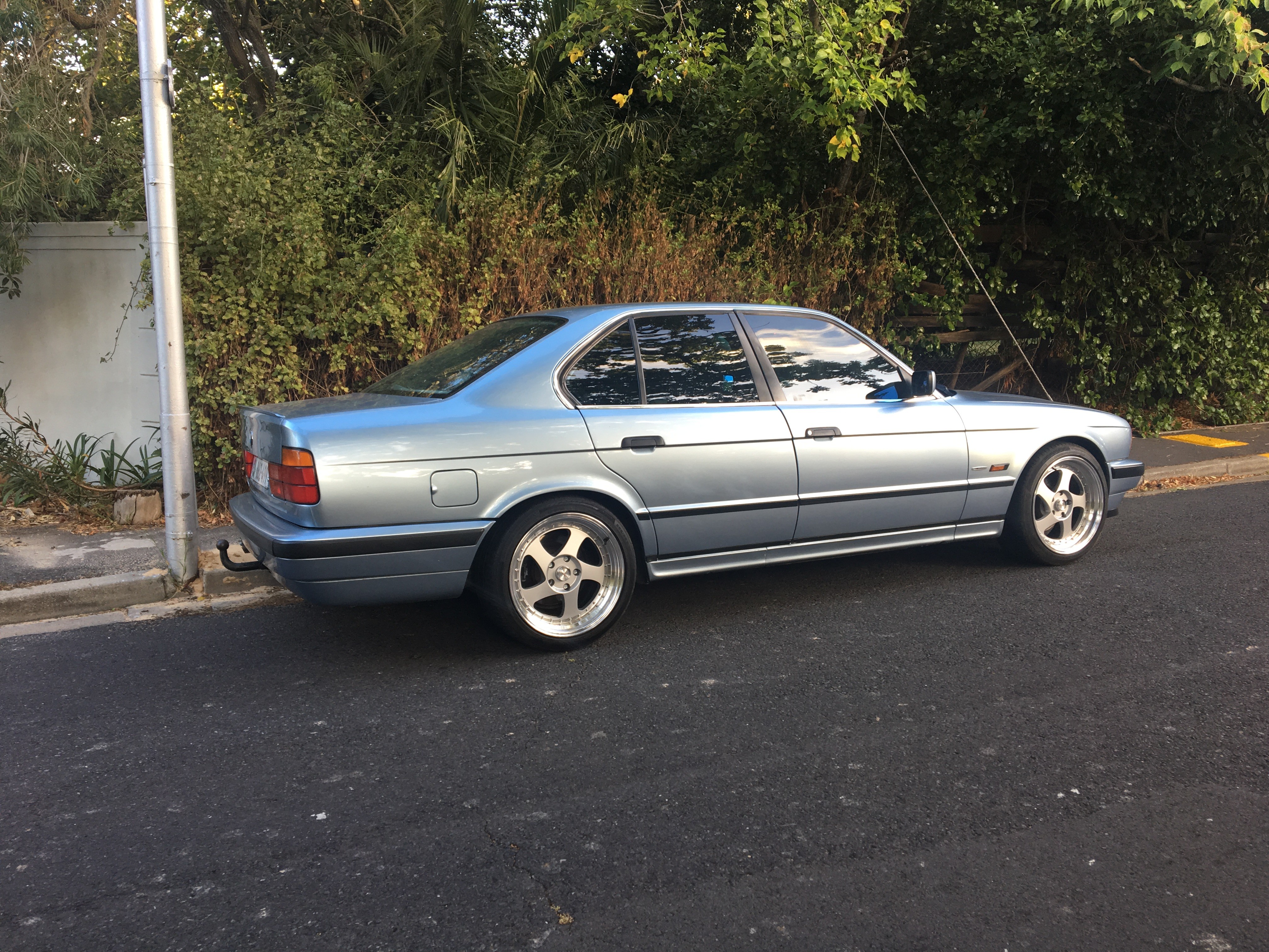

So I got my front wheels on today with 20mm spacers, I think they fit perfectly, when I fit springs I think it will look great.
Now I just need to space the rear, going to try 20mm and 30mm then see what looks best.
The fronts are 8j et33 with 20mm spacers. 225/45/17 ( I would like to fit 245's)
The rears are 8j et15. 245/40/17
Racing dynamics RGR 17
Love the simple look and style
Need to get low, space the rear, then take some nice pics

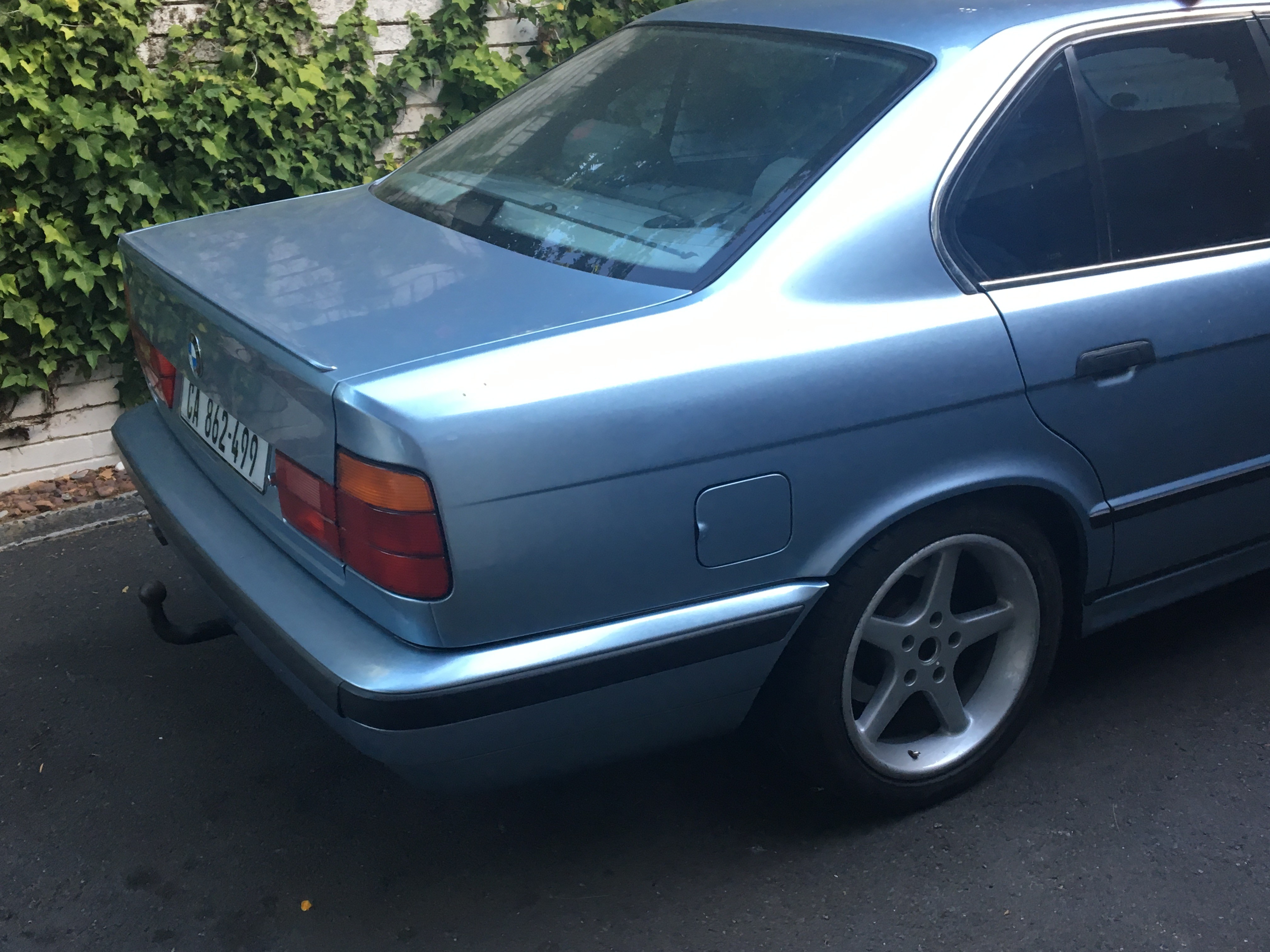

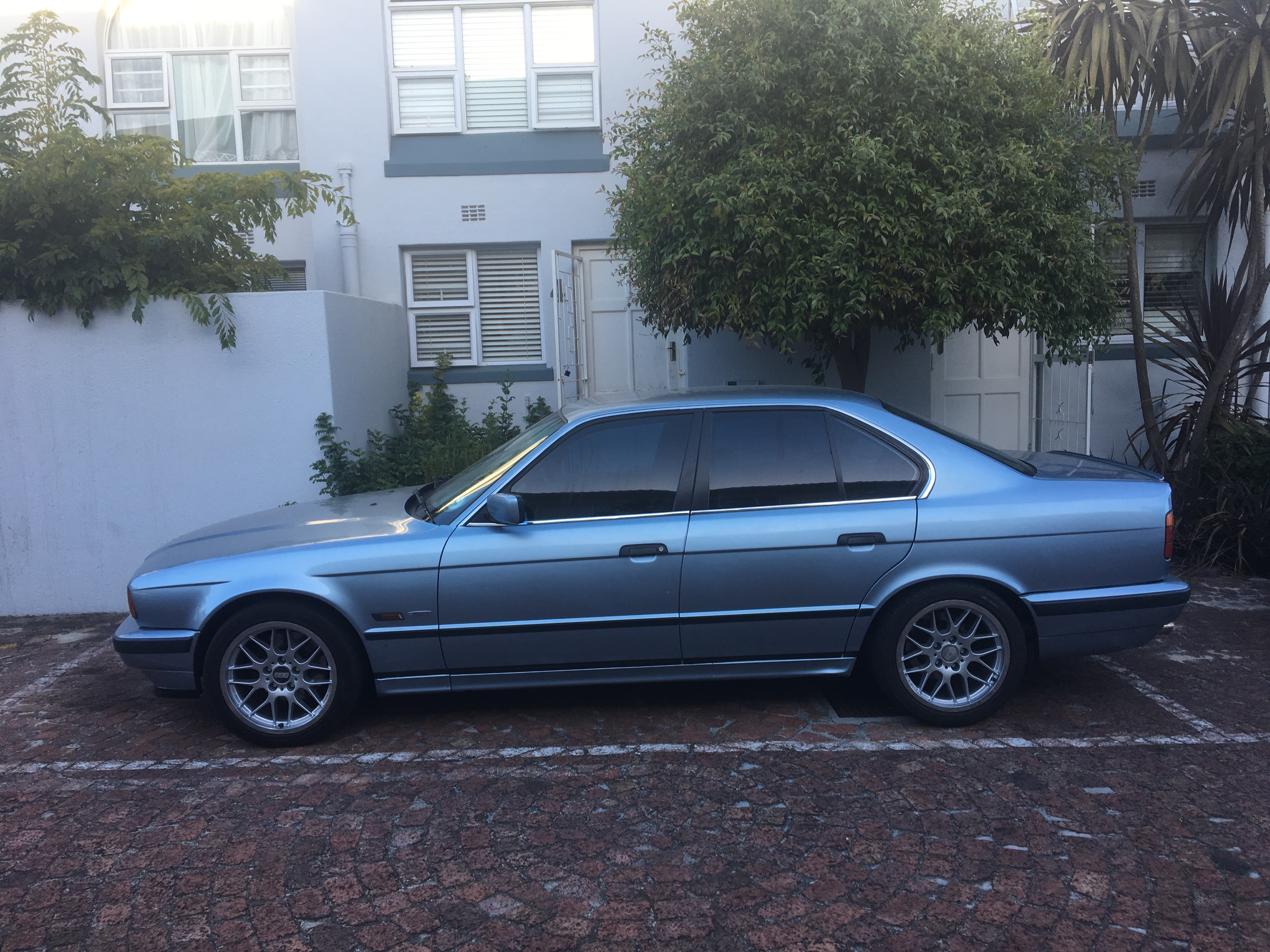

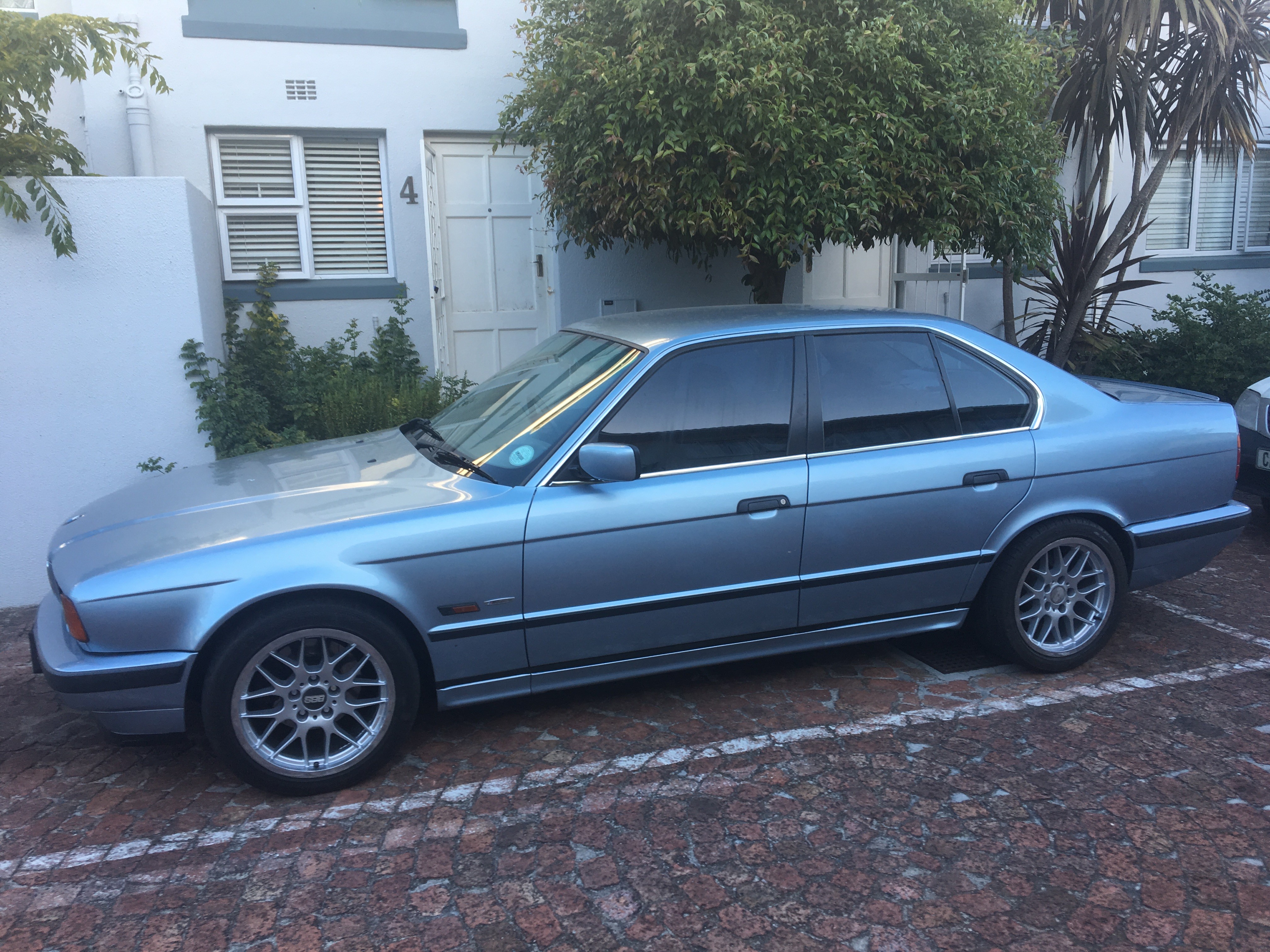

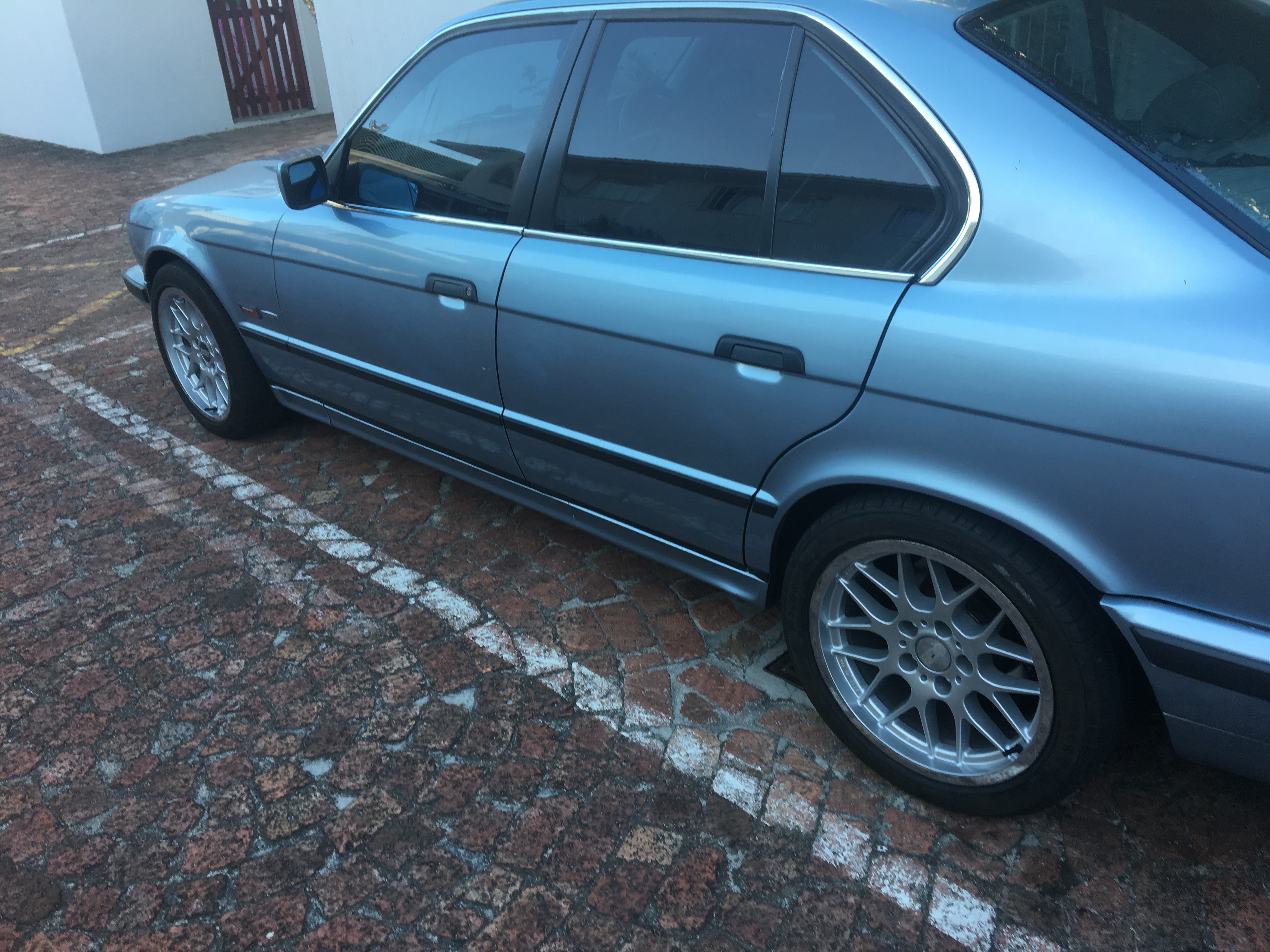

So I went from my style 5's to the racing dynamics rgr's, the to A line Jedi's -9j et25 square set with 12mm f 20mm r spacers, to now the BBS RX 203 8j et10 with 12mm f 20mm r spacers
nirvash
Changed it up today to no spacers front and 12mm rear,
I think it's perfect now, and will be able to lower the car with now rubbing now I hope,
Now just to save up for some h&r springs
Waiting for some parts then will get the lsd, m5 sway bars and koni yellows fitted
