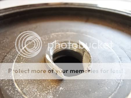

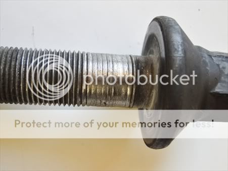

For some time my 120d was starting to vibrate above 130km/ph. I thought it was the tyres and replaced them and then had the rims checked and balanced as well as the wheel alignment done but the problem persisted albeit on a lesser scale.
Then two weeks ago the car just lost power while driving...I eventually drove it home very slowly. Got her back today after the repairs, which came to a hefty R9,000. But she is fixed and running like her old self again. :joy:

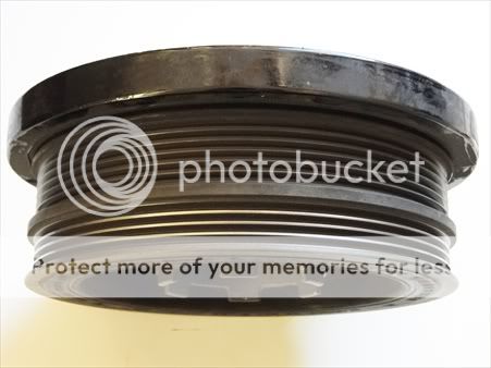

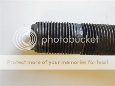

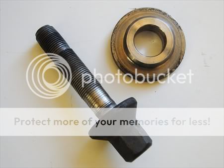

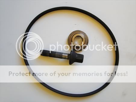

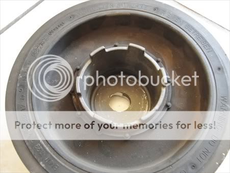

Shocking wear:

Nope. I was looking at many things except that. I was looking under the car near the front wheels because thats where i "heard" the noise...eish.

What mileage on the failure . A mates car bottomed out at 190 K. But he use to drive the hell out of it

180,000...its my daily drive. Use it for work and private...very very frugal diesel.
Philip Foglar
abmi0000 said:
Does this attach to the flywheel?
Main crank vibration damper pulley - so all ancillaries run off this and the vibration damper is there to protect them, just like the dual mass flywheel for the gearbox. 180k km is not bad though! Maybe a case of replacing these things every 100k km to play safe...
