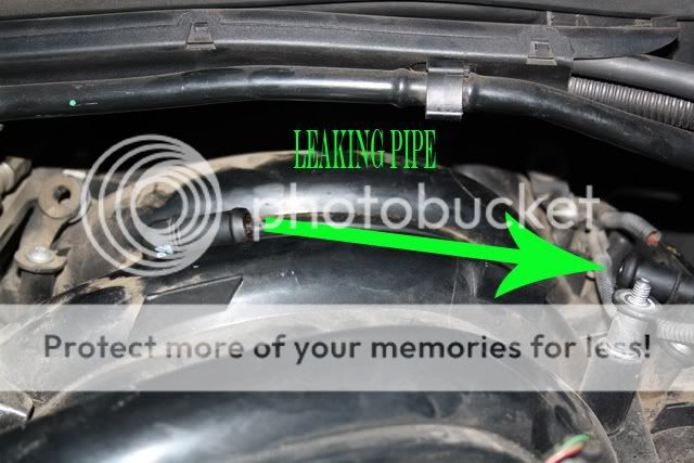

As you all know I have had a bouncing Iddle for a few weeks. After meeting with the big Z we read codes cleared and waited 2 weeks to read again. We did this to c if any funny codes pop up.
So the other night we read codes and got 2D29 all pointing to some vacuum leak. Big Z also heard a "sucking Noise" and gave me some advice as to where to look.
So today got home let the car cool as I want this solved before saturday for Dastec and here is what I found.

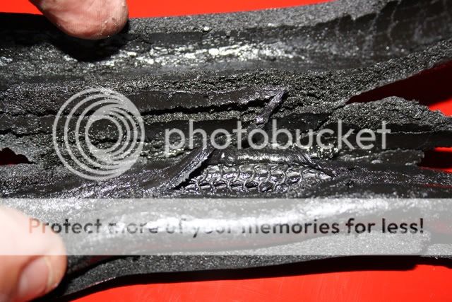

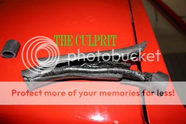

this pipe was leaking
I have baught a shrot term replacement till the Am tom so that I can get the part from The stealers as the Midas one is a tad to big (1 /2 mm) and is still leaking and cuasing serious rough Iddle.
Once I got the replacement I will post to let you know if the problem is solved.

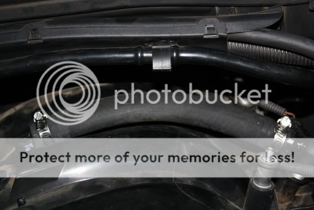

So still shopping for it but the current replacement pipe seem to fixed the bouncing idle.

The pipe that BMW wans R424.75 for
replacement. Pipe R31.00 Midas + 2 x clamps R8.
As I did this tonight I will report back as the vacuum leak seems gone but rich Petrol Smell in garage. Will c after tom's driving, sure PC needs time to reset.

Ok Now have done the following. Addaptive reset..... Disconnected batery.....And went for quick drive. Had the consumption running at 20/100km/l. Wifes tales or not there is a definate better pull. Might be the pipe is now fixed or what ever.
But I know the Idle bounce is gone.

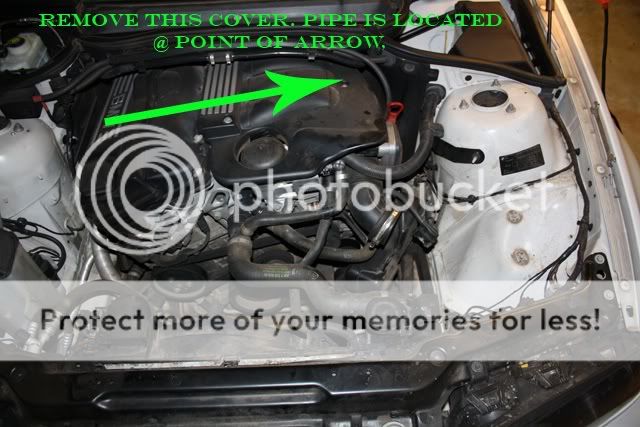

spy007 where exactly is this pipe situated?
i can here a leak on my car but i'm not sure if its from the exhaust manifold or a vacuum pipe :dunno:
Spy007
A2 Lunitic.
If you look at the first pic it is just above the Manifold. There is a funky plastic cover that you have to take off. Il find the pick with it on and hopefully that helps.
Below the cover next to the Dipstic (red).

Did the cover go back on alright? That replacement pipe looks a tad healthier than the OEM.. Also, did you come right with the heat wrap??

HAHAHA :biglol: My pipe looked exactly the same! That bugger really scared me, strange thing is the car was driving ok with it.. maybe it was compensating.
Nice pics though.
