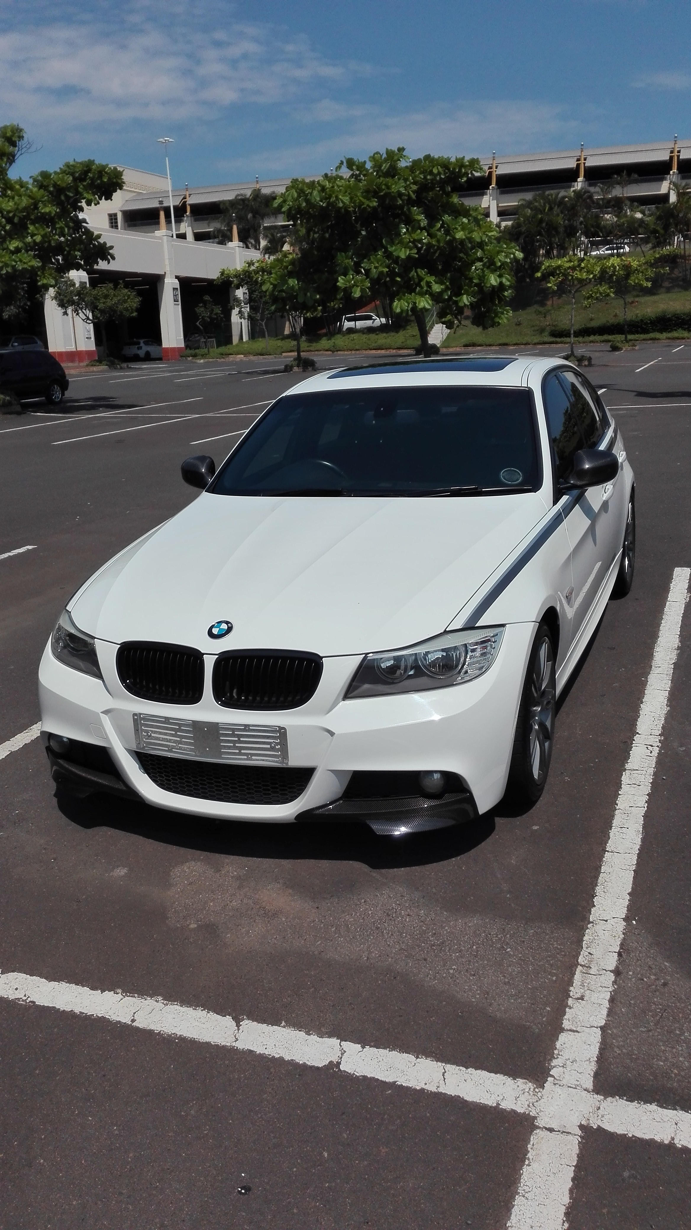

My 2010 Bmw 320d e90 DYNAMIC EDITION auto 107 000km
Diesel
Thanks guys. She gets washed once a week by me never in a car wash. It takes about 2 hours to get her spotless.
momo1
looks fantastic!
same colour and spec as mine, although mine is bone stock.
splitters and black grills make it look agro

nyc ride. I only get vibrations when I hit the brakes, but then my alignment is totally off and I suspect wheel balancing too.

Car looks the business :thumbs:

Where can I get that silver decal that runs along the doors?
Sent from my Redmi 3S using Tapatalk
Diesel
From a Bmw dealership. It's called a E90 performance vinyl stripes. I paid about R1200 in December last year and R300 to fit. The stripes look a different shade under lighting conditions as u can see in the pics.
