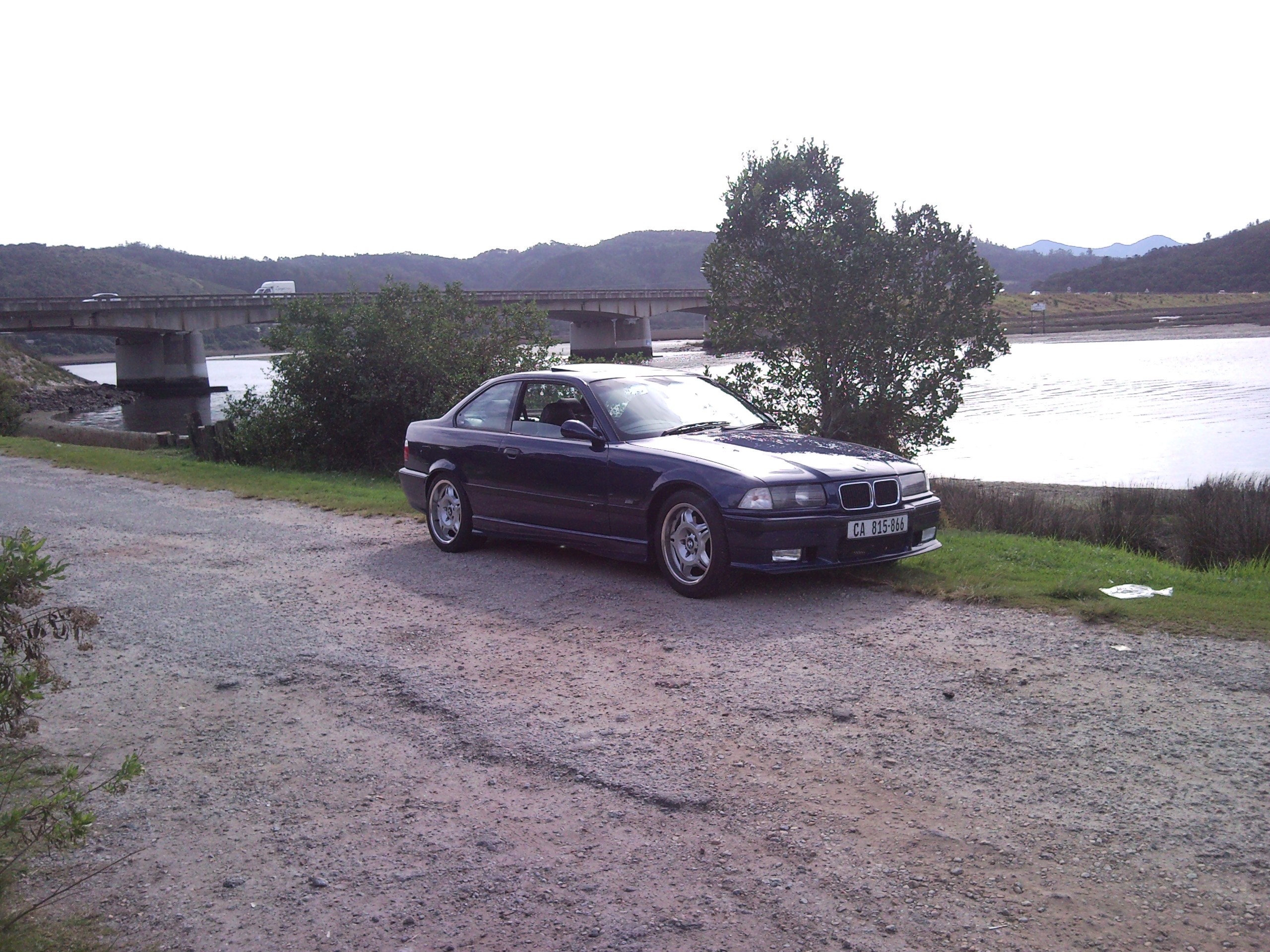

My e36 M had a substantial mechanical repair /restore in 2010 when my friend owned the car with me sitting with the slips adding to r62 g .I actually covered less than 20 000 k since I owned it after the repairs .So do I keep my car and just admire the later models from a distance or buy that AUDI S4 instead , cant afford to keep my M and another performance car.
