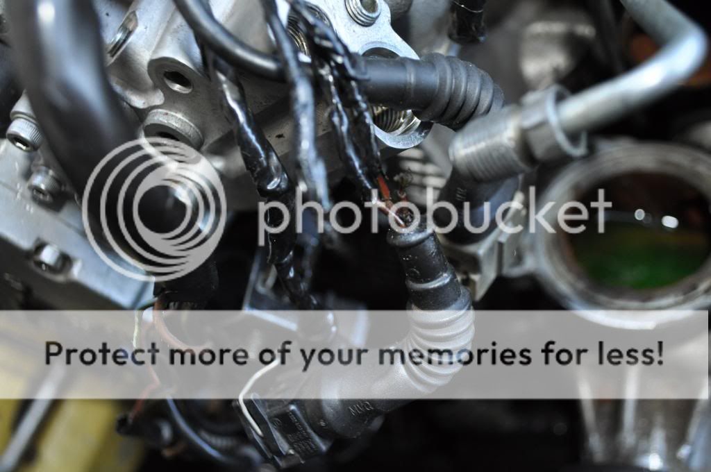

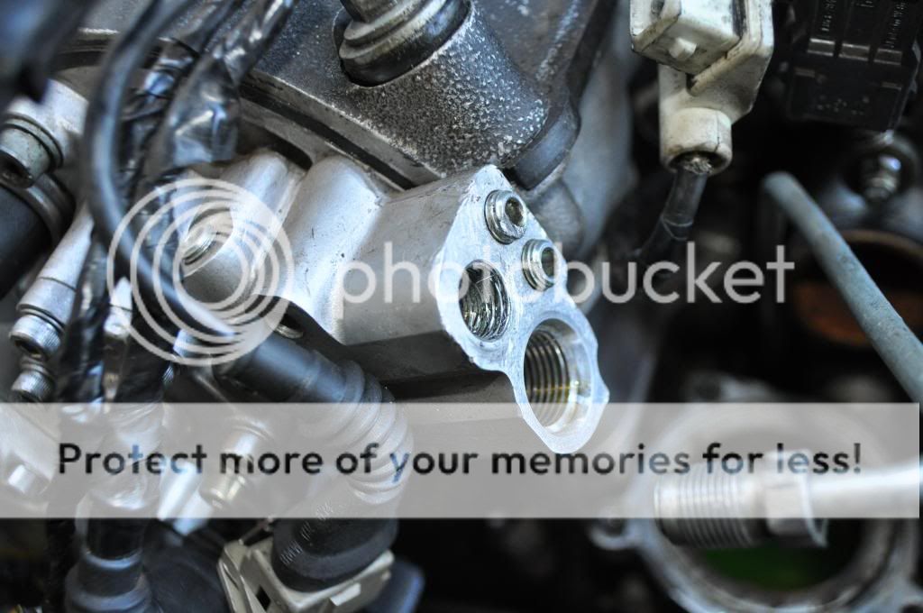

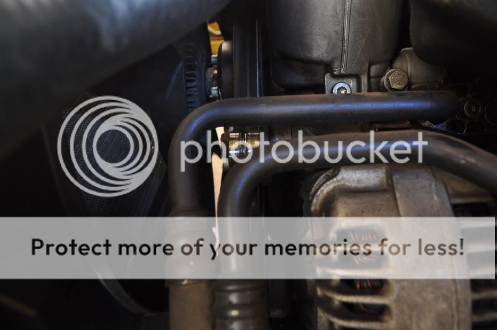

Below a few pics of what was found.
The tensioner pulley....well what remains of the tensioner pulley

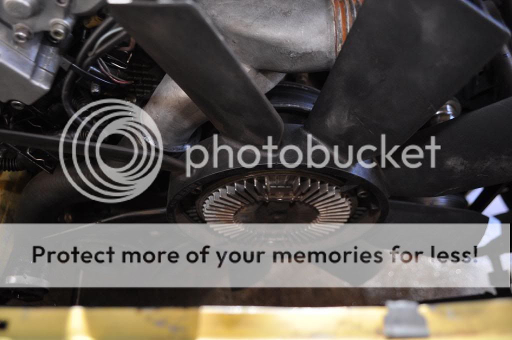

Wrong fan blade

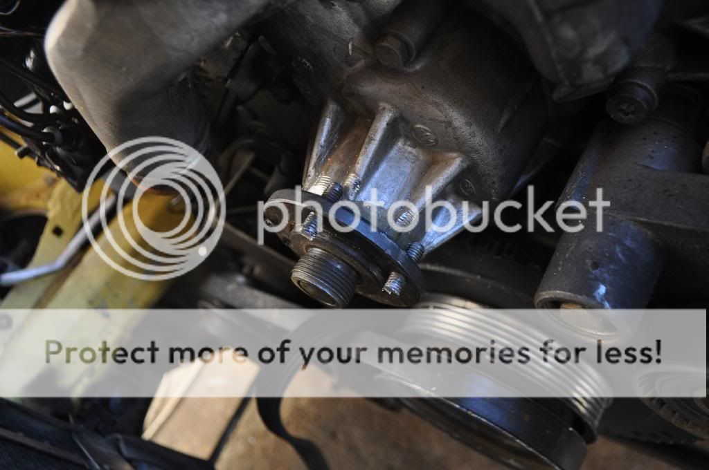

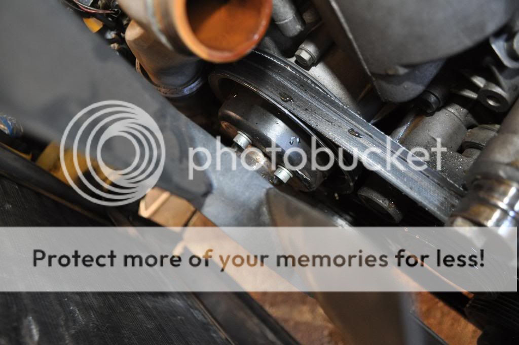

Wrong bolts on the water pump pulley which will lead to complications as a 32 spanner is not made that thin as to fit in the diminished space.
We will likely have to grind the heads so as to fit it in to release the viscous

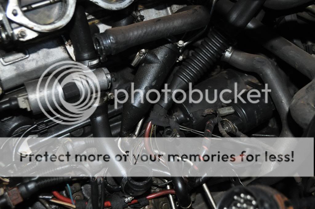

Note how the bottom radiator hose has swelled and how the incorrect serpentine belt is being used "being a 5 rib belt instead of the normal 6 rib"

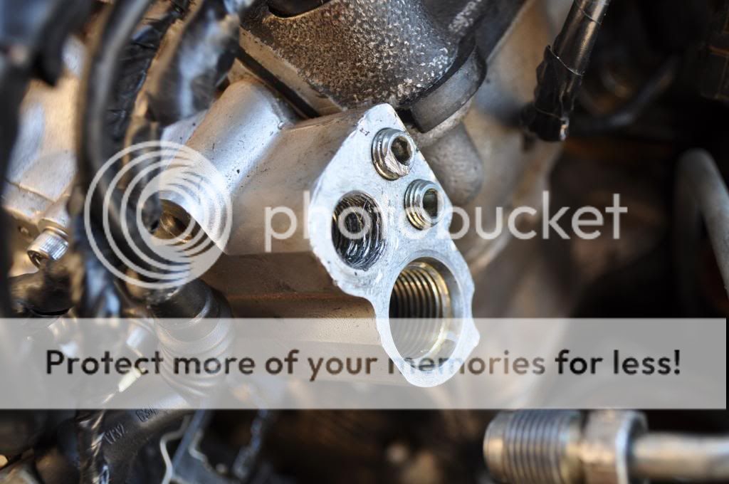

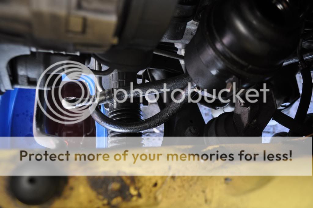

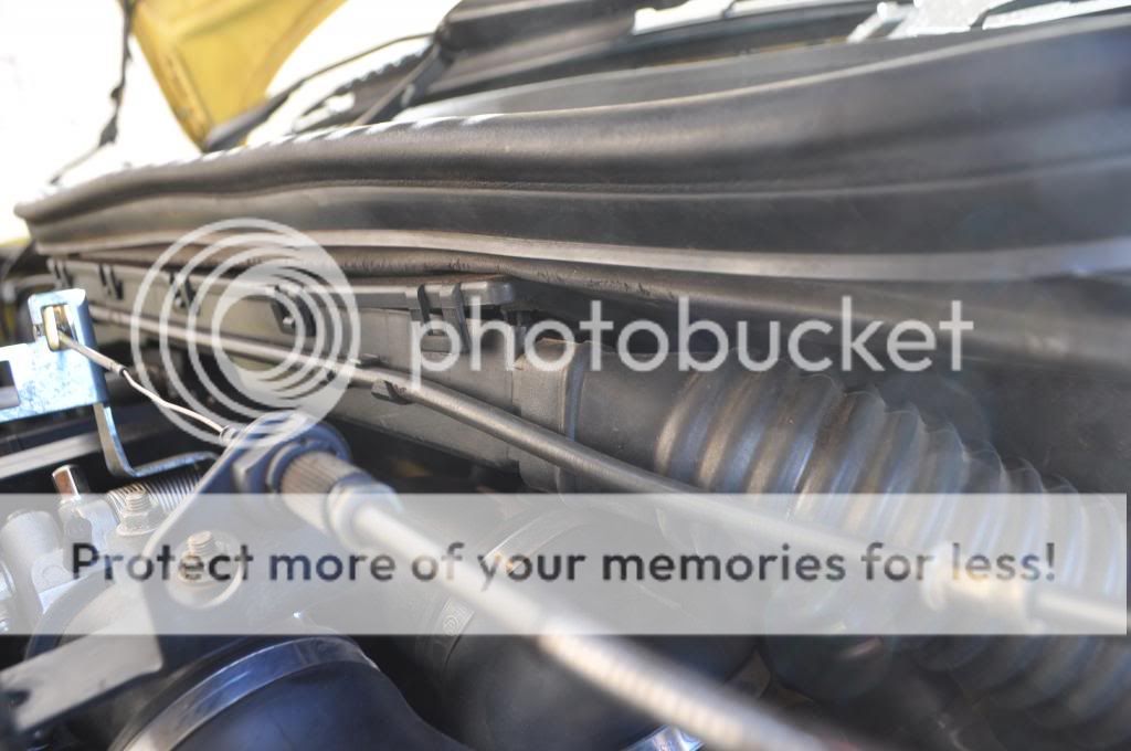

Leaking PS hoses.

Wrong fan blade

Leaking PS hoses.
