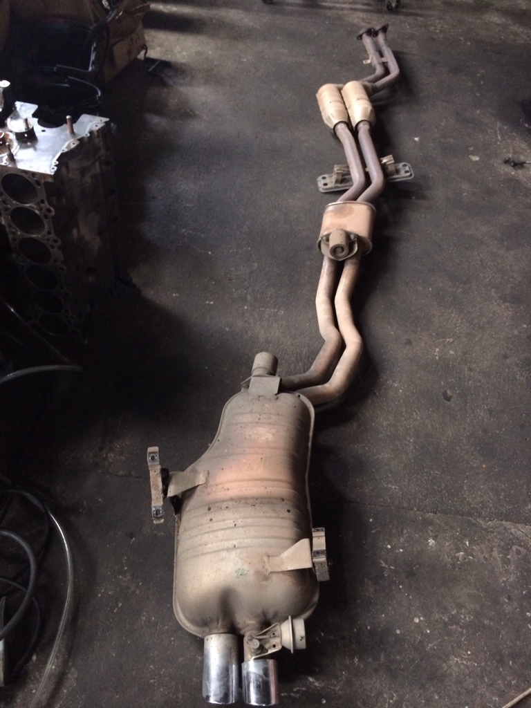

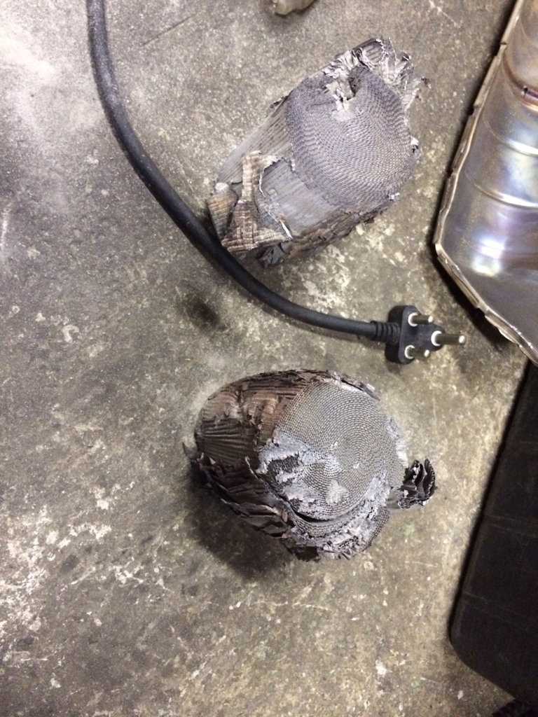

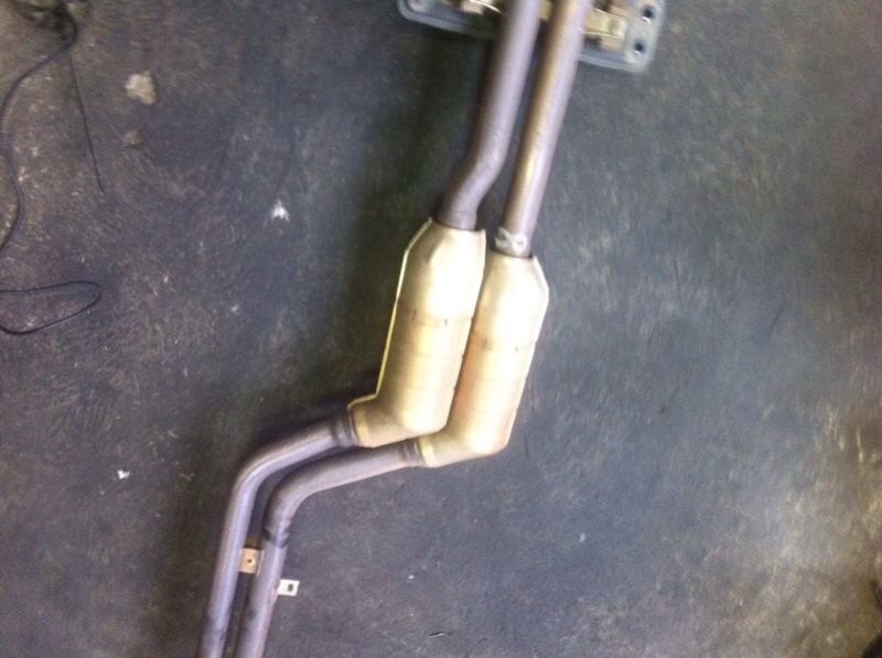

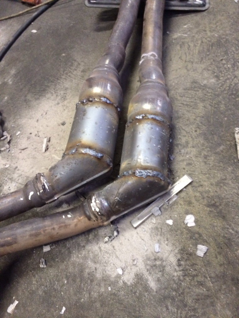

I finally took the plunge and had my car Decatted last week thanks to German Technik in EL:rollsmile: I had all 4 cats removed, 2 in the manifolds and the 2 mid cats. The pipes were cut open, cats removed and welded back together so everything still looks stock.

hollowing out the cat cases is not good in terms of flow dynamics...
the massive increase in pipe diameter kills the exhaust gas velocity this is bad for performance... you will get more out of this if you fitted pipe the same size as the rest of the system...
anyone else considering this should cut the pipe before and after the cats and use pipe to join :)

The strange thing is that a supposedly reputable company like Van Der Linde did the exactly same thing on the mainfold cats like Bavs car on Sankukuers 330.

it is the easy way to make sure pipes are not miss aligned this is the only possible reason why they would do it this way...
ask any engineer if this void would be good for flow and he will tell you no...
reason why the diameter is so big around the cat is to compensate for the volume taken up by the cat with it removed it is too big...

Yes I actually discussed this with Yuben and GT. I figured I would see how it performs like this and if I'm not happy with it we can always replace it with a resonator or straight pipes later. I'm actually quite happy with it performance wise:rollsmile: The only thing that I think might get to me is the raspy sound in the cabin. I will see how she runs over the next few weeks and look into resonator options to reduce the rasp:thumbs:

This is exactly why we did it like this. So that the alignment is perfect. We also checked if 328 or M3 manifolds would fit on my head, but my head for some reason does not have the extra holes to accommodate those. We would have to drill and tap into the head to get the studs aligned. I think only the pre 2003 heads came with extra holes.
