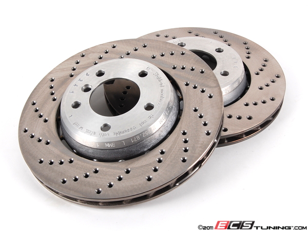

But why don't you buy the BMW Performance discs for your 330i?

ATE pads are definitely not noisy, unless you use them with the BMW Performance discs. You here a funny vibration noise due to the drilled discs. They do tend to make a bit of brake dust though.

Where can I get the performance disks from? Stealer prices are ridiculous for the standard disks as it is:fencelook:
wow sp33dyv those look flippin nice:praise::thumbs::inlove:

SP33DYV said:
ECS Tuning.
http://www.ecstuning.com/BMW-E46-330i-M54_3.0L/Braking/Big_Brake_OEM/ES2228825/
thank you but NO thank you :roflol::nonono::cry::argh::thumbdo:
to rich for my pocket, maybe one day when im big:thumbs:
