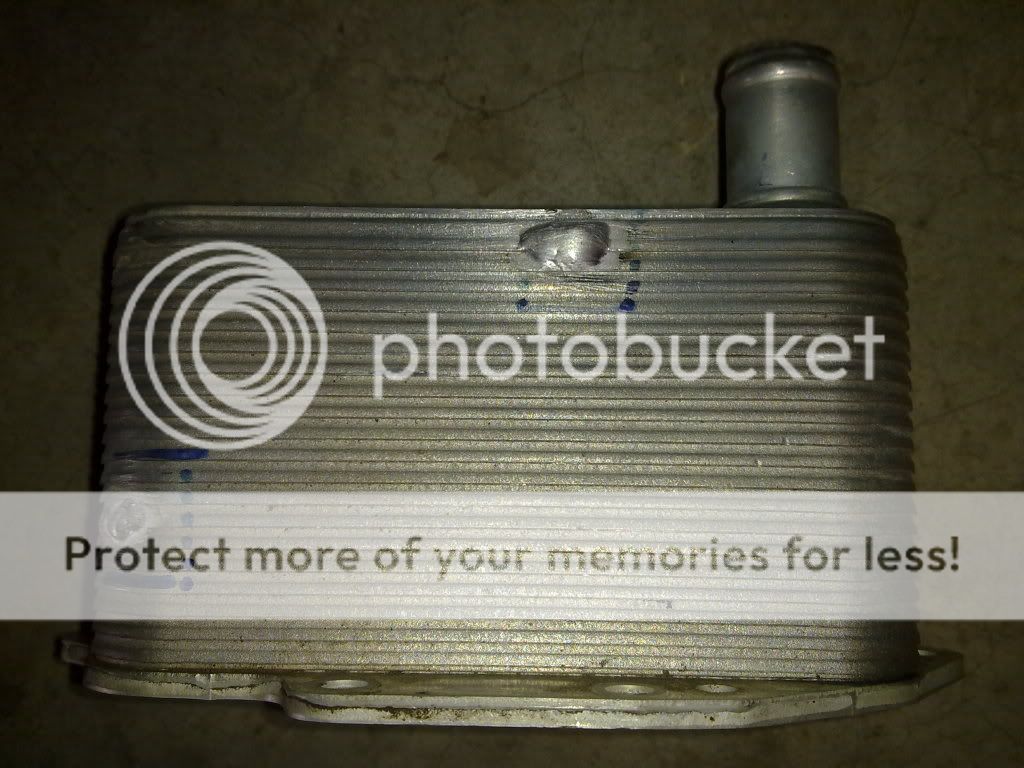

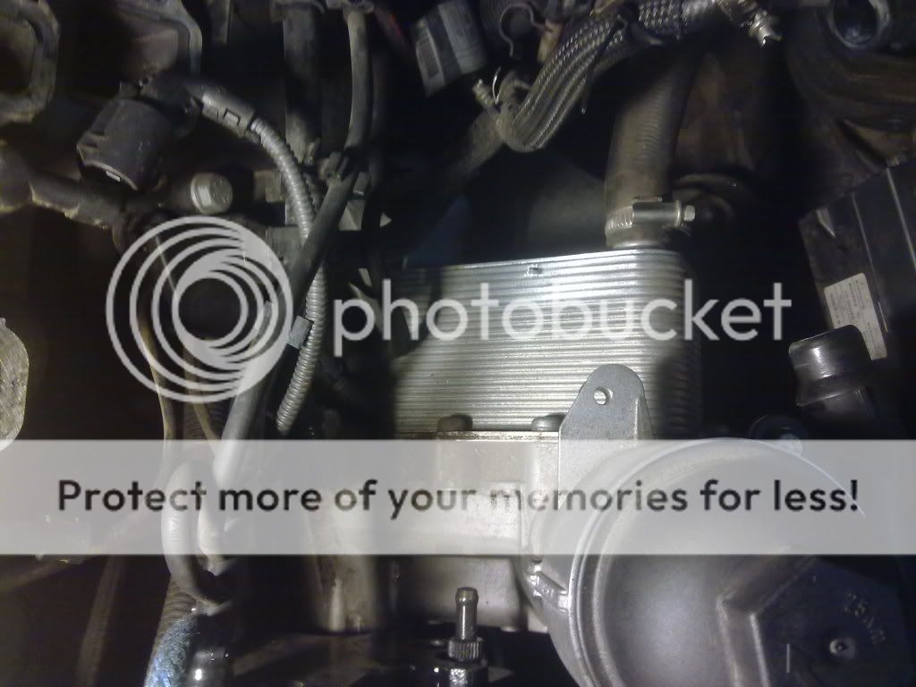

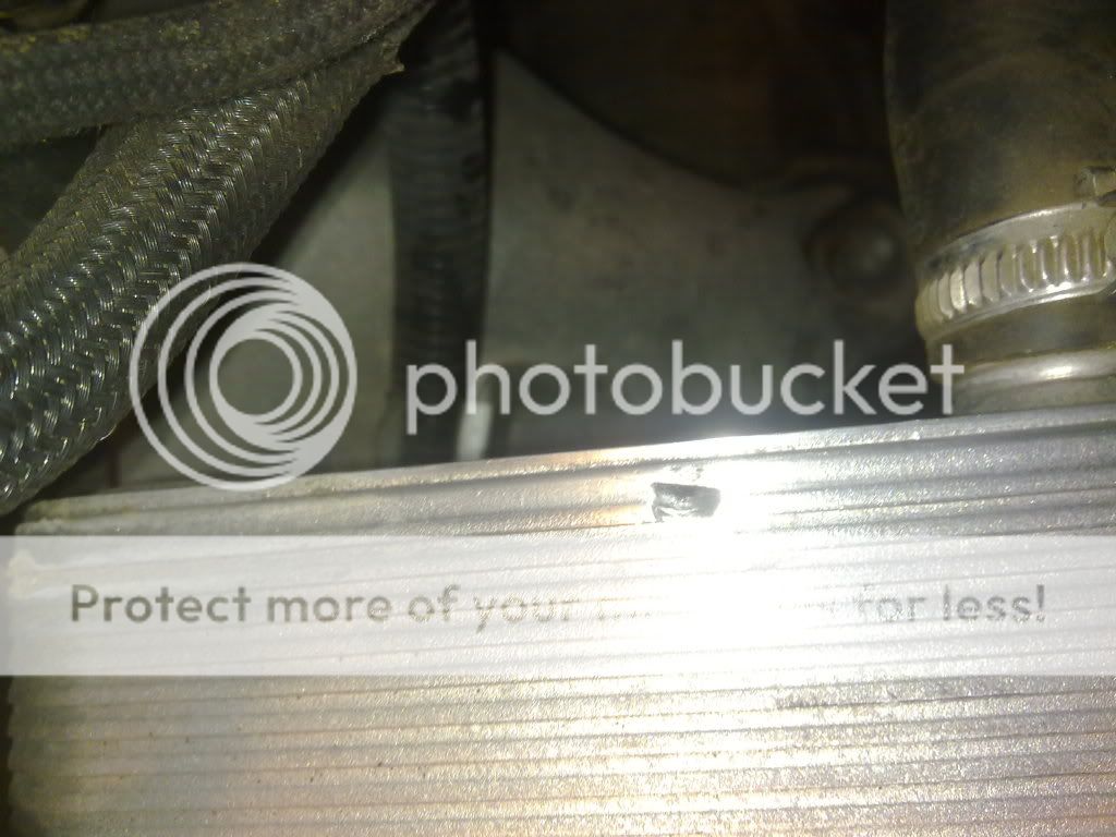

none of the usual suspects yielded any results, so i stripped away more and more of the engine, eventually removing the inlet manifold in my search.. and there it was, one of the fastening clips on one of the diesel feeds touched on the oil-water heat exchanger, and had managed to wear a slot into the cooler.. creating a tiny pinhole..
with lots of swearing i managed to remove the cooler and have it welded shut.
so add another location to the usual list of leaks on the e46, hopefully this helps someone out there..
