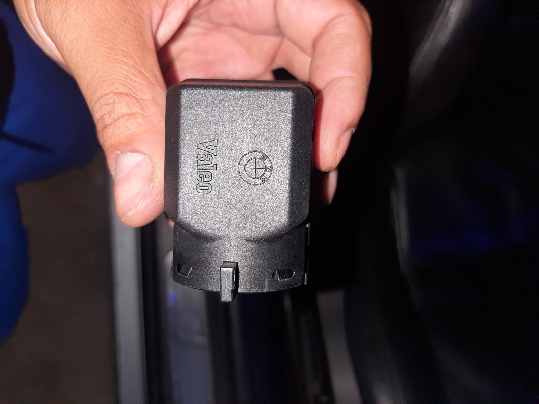

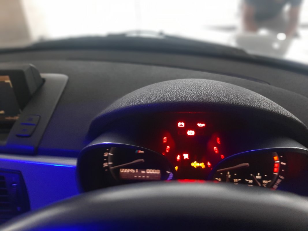

Bruce88
Wasssuuup!!
Oem R1690 , part no: 61326901961
Non oem: R412 , part no: 32102
balling on a budget this month so went non oem (moto euro) the notchiness is still there. Old gal lit up like a Christmas tree.
So the circuit wiring is ignition position 2 will unlock the DME, cluster lights and Fuel Pump. Position 1 will unlock the starter and the alarm system. So if you getting to position 2 and you getting the starter going but none of the p2 electronics you are having ignition switch failure.
