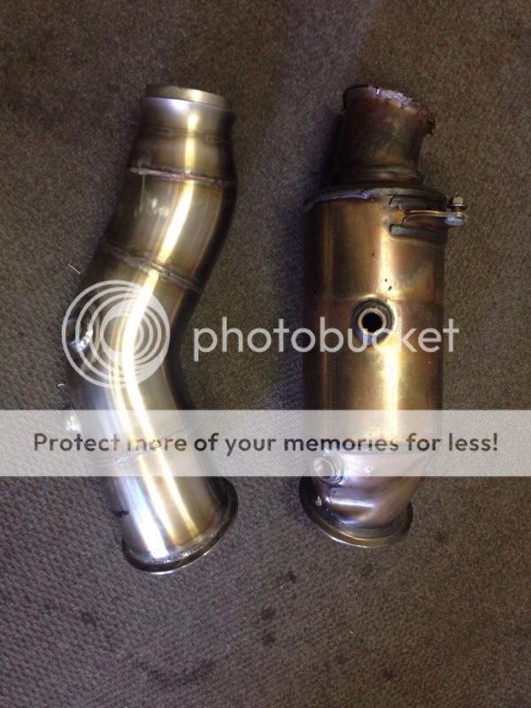

Hi bud 23.6 kw very impressive just a dpdvst8 said:Xcede/XFlow N55 104mm downpipes now available for EWG enabled models.
Made from high grade stainless steel and Tig Welded.
R 6500.00 installed.
Pic next to stock DP

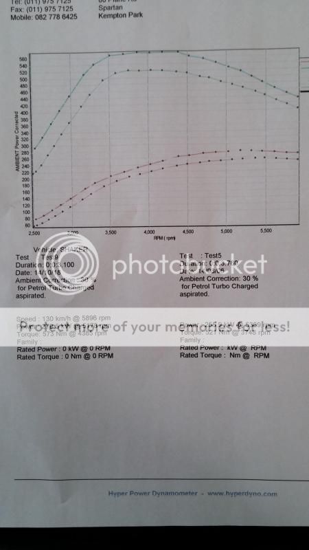

Dyno Graph with before and after runs

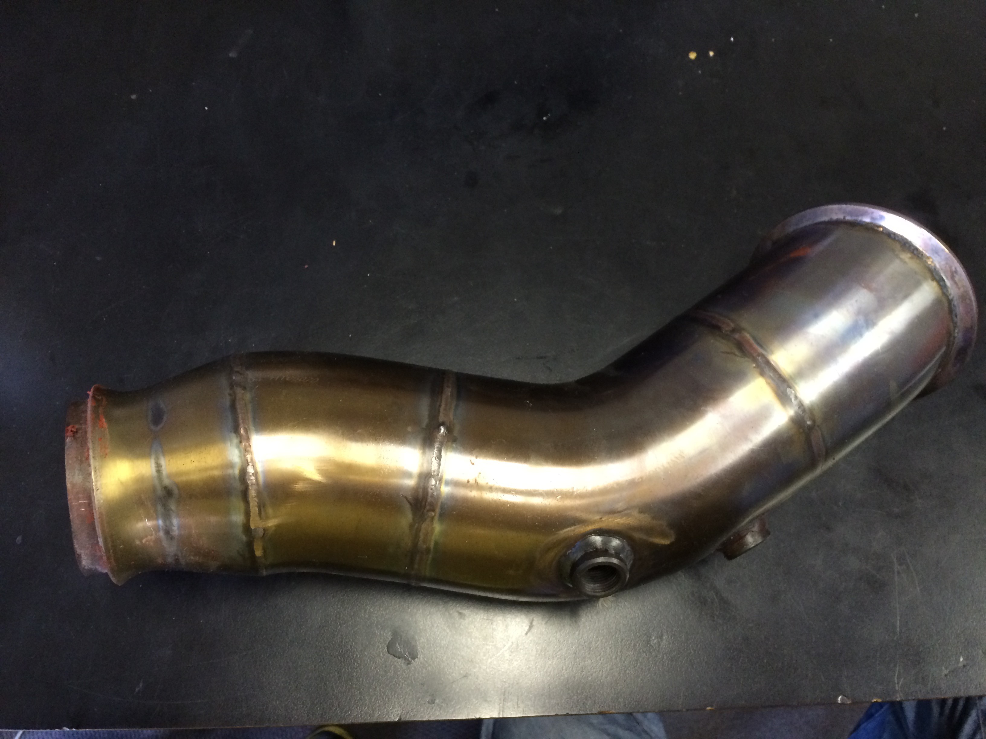

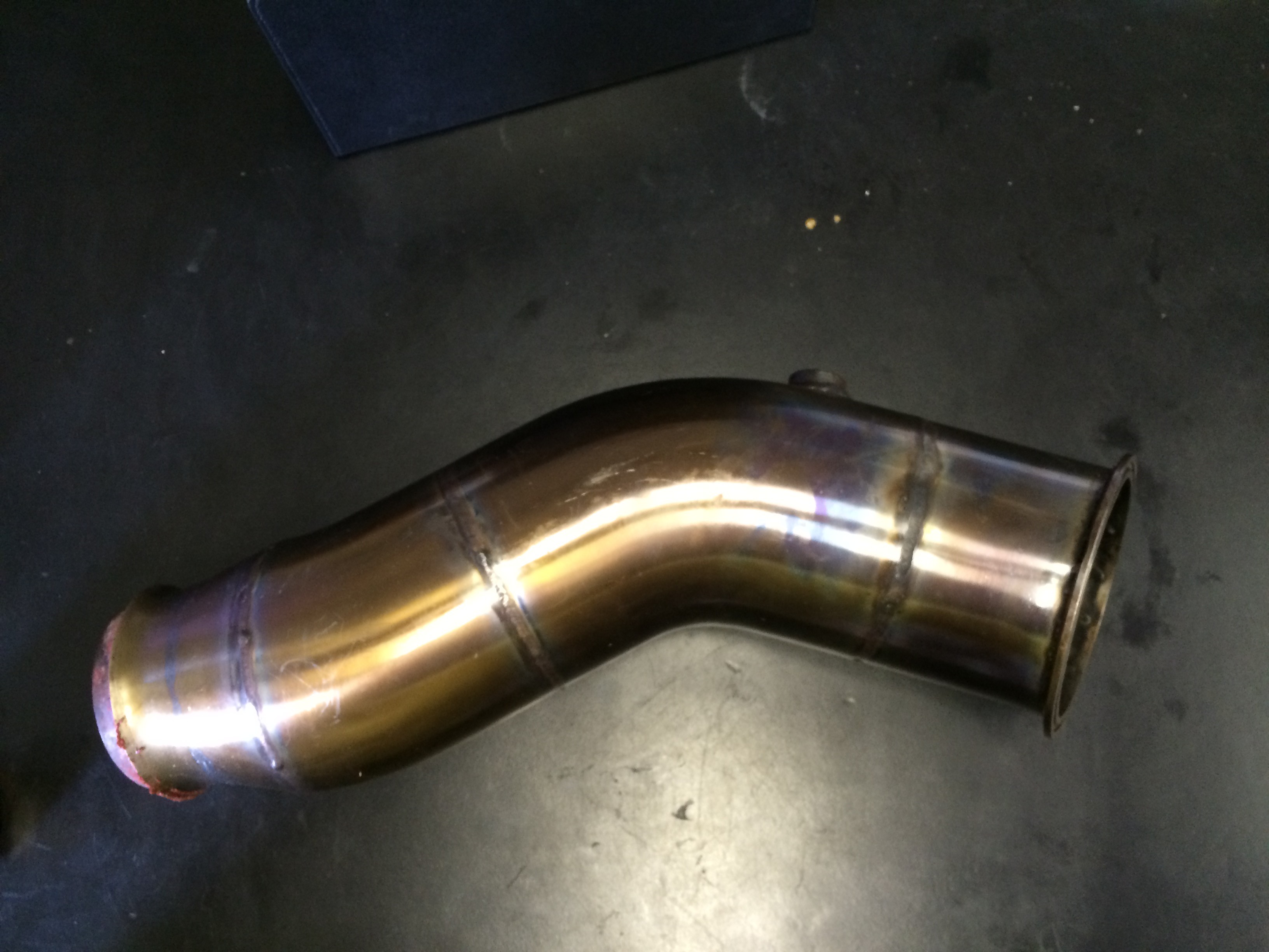

Sherwin@xcede said:That pic was before cleaning and grinding
Dhp507 said:Fair ......
But undercut refers to a seam that has little weld material between the join. Looking at the seam (vetical) the welder uses an S motion as in stiching the two.pieces together . One will be able to see waves created by such motion.
Where undercut is found the weld will be a weak spot an will fail overtime.
Im not even goin to ask did he purge an use stainless rod when he welded.
