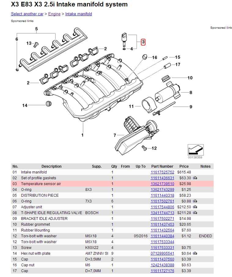

Hi all.
Please help don't know what to do. I have a 2005 x3 2.5i e83 m52 engine. When i start the car in the morning it cranks and starts only after 2-3 seconds of cranking then starts off very rough like its misfiring, black smoke at the back and a smell of patrol. The revs start out at around 300 then gradually go up to 800 and then its fine and runs smooth with no smoke, doesn't cut out revs smoothly till the redline. If i turn it off and start it up again, its starts normally no smoke, but if i park it for 30min or so the problem comes back.
I scanned for codes and found P0113.
Any help will be greatly appreciated
