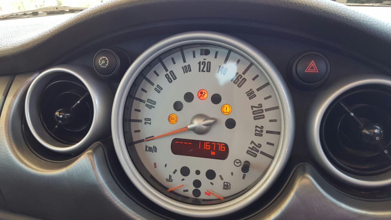

Who can guess whats going on here?
fluffy
2006 R63
116 000kms
what could be these warning lights....
the esp light stays on ... regardless of the switch.
the abs and tire lights stay on too... obv the "!" was just the handbrake
zippy320
You need to fill petrol.... My light only comes on when there is wheels spin or a bump or something , Karsh is right check the sensor and maybe check your tyre inflation?
I know when I worked at the bank , one of the E90s had this issue , It turned out to be tyre pressure.
Willy
the "!" is your tyre pressure warning light, not hand brake.
That is like mentioned: wheel speed sensor or abs pump.
Most of the time it is a wheel speed sensor.
