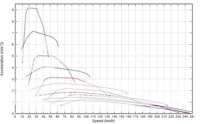

After going off topic (sorry) I hope my following contribution would be seen as useful. After looking up data about these very specific cars, both needing to be 2007 models, I placed them in my sim. The specs I use ar the following:
330d: 170kw, 500nm
330i: 200kw, 320nm (strangely, its more powerful than the one currently selling)
The first graph represents the acceleration of the car in each of the gears,
330d being RED
330i being BLUE

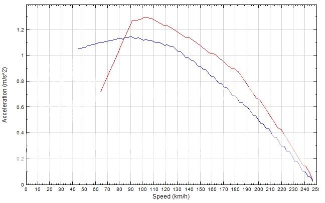

But coming to the actual question, of highway driving, lets take 2 use cases. First, both cars doing laid back driving and NOT shifting down from 6th gear. I think the normal overtaking scenario is from 80-100km.
The conclusion (which is painfully obvious) is that the diesel has a lot more torques, which gives it the edge in 6th gear.

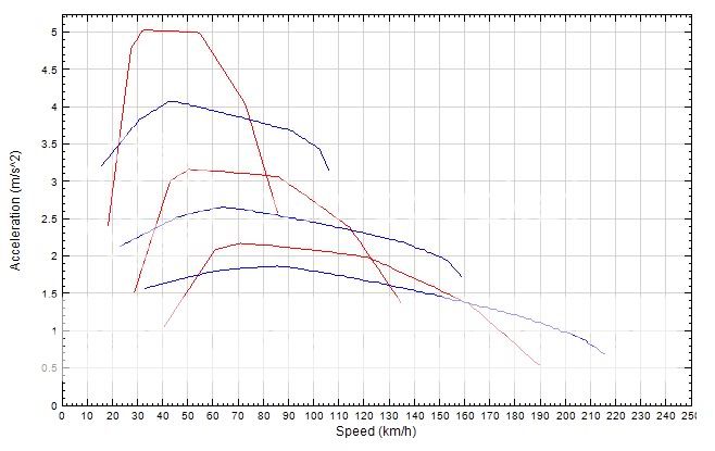

The second scenario is where moranor is driving the 330i and shifts down to 2nd gear. Here are the acceleration graphs for 2,3 and 4th gear:
The conclusion is that the 330i will brutally kill the 330d, doesnt matter what gear the diesel is in.

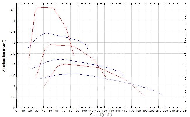

These are all simulated for the coast. Here is one for the guys at the reef( same 2, 3 and 4th gear):
The conclusion is that there is a drop in performance for the 330i, but not enough for the 330d to win. The power advantage of the 330i is to big.

2nd is a bit short for the high way :rollsmile: but 3rd and 4th still show the results...
Both cars in 3rd, the 330d will win. except if you want to go beyond 120km/h and have a date with Bubbu....
But thats the problem with the 330i, high revving engine for the lose if you don't drive the sh!t out of it...

drugekull
Jees look at the curve in 1st and 2nd on the 330d
I wonder do they have to reinforce the driver seat in the 330d compared to the 330i
In 1st you won't really feel the acceleration, because by the time full boost comes in, you are at the red line. 2nd gear should be more realistic...

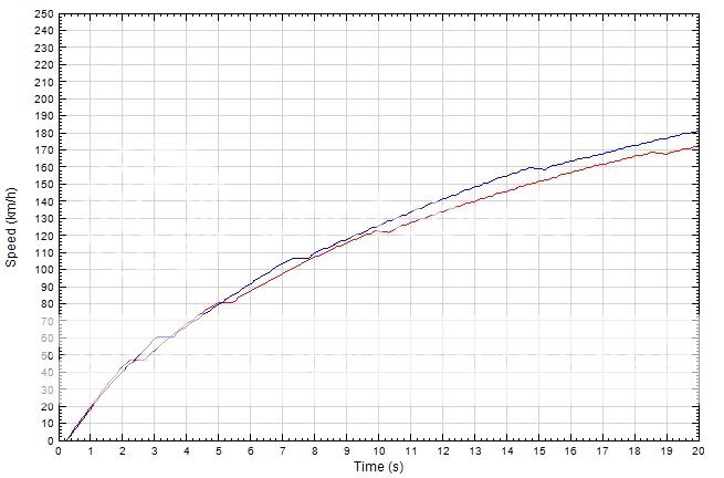

acceleration from start

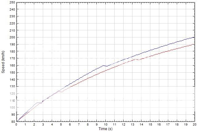

acceleration from 80km/h, 330i in 2nd gear and 330d in 3rd gear:

these cars are pretty damn close depending on what day it is ether could win...
yes diesel had caught up to petrol in this case (there is no point in splitting hairs)
if the 330d is ever so slightly slower than the 330i how can it be = to the 335i?

I don't know about this Diesels are getting to full boost at 1800 rpm now days so you have a 2500 to 3000 revs of full boost and full torque before the gear changes. If you have a auto box the gear changes to second and brings the revs right in the middle of the boost so 1st and 2nd seem like one long gear. Its lovely.

But full torque isn't available instantly in the diesel, only when you have a load, and only after 1second (if you are way below torque peak rpm). What I have experienced is that when placing your car in 1st, and crawling along, you don't get the full acceleration when putting your foot flat. It makes a little bit of sense, because 1st gear should take 2 seconds to complete, where by the time you hit second #2, you are already at 3500rpm where the torque isn't the full figure anymore. The auto is another story, because the torque converter slips the engine to a higher RPM where spool up is much faster etc. I can't explain it, but that is what it feels like. Maybe someone could give a better explanation....
