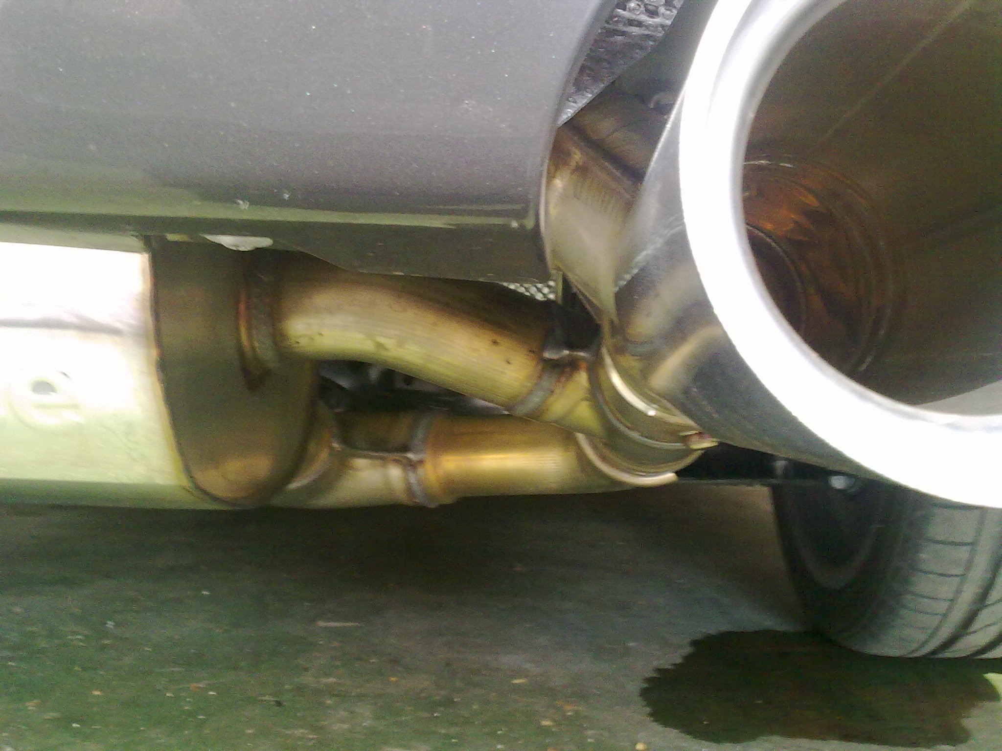

Then the toys.The exhaust system can be altered on the I drive and sounds different on each setting.This is due to exhaust flaps that are opened and shut on each setting.In other words gasses from the motor will either run with both exhaust through silencer,or one exhaust runs through silencer,or gasses emit straight out without silencer.Remember the days when you changed exhaust systems.All done by pushing a button.In sports + the system is completely open and sounds awesome.Cracks and pops are the order of the day.On the open road this setting is no good as there is drone.Easy enough push to comfort or eco and everything goes all quiet.

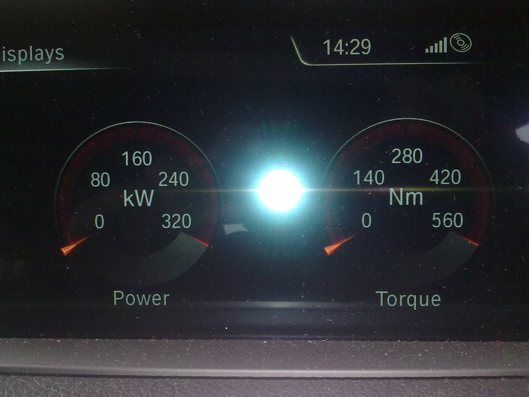

Next how the MPPKS is identified in the car.Push to the sport dialls and these are the figures that come up.
The standard car has 240 and 450 as limits.
I always use 10% ethanol ,as suggested on fuel cap, and have seen figures of 275kw and 520nm come up.

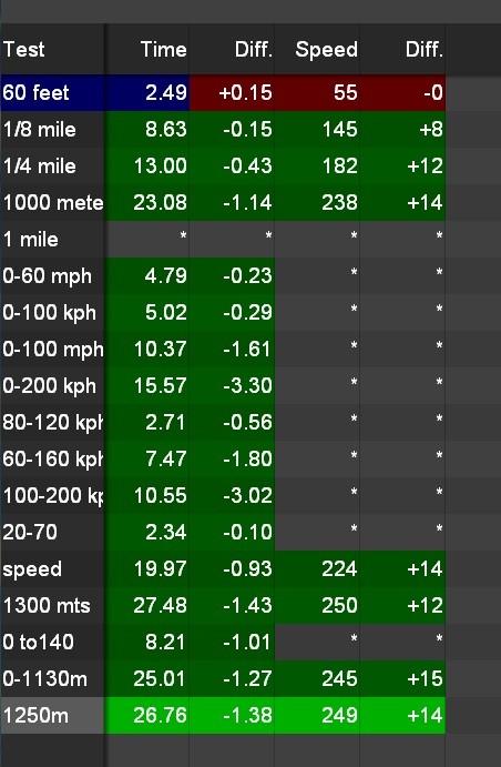

Now the best part for the performance orientated guys.The 340i is very quick.Due to the longer diff ratio and the bigger turbo there is a bit of lag on pulloff but after that ther is no comparison to the 335.
Below is the performance log done on both cars using same track,same testing equipment and similar weather condition. On the sheet is the comparison how much speed difference over distance and time difference. Note the 100 to 200 time in particular. Due to the bigger turbo over the 335 there is no longer a need to change at 5800rpm and the car revs and pulls strong all the way to 7000rpm.
As can be seen the car does not need more than the track length to hit the speed limiter.
