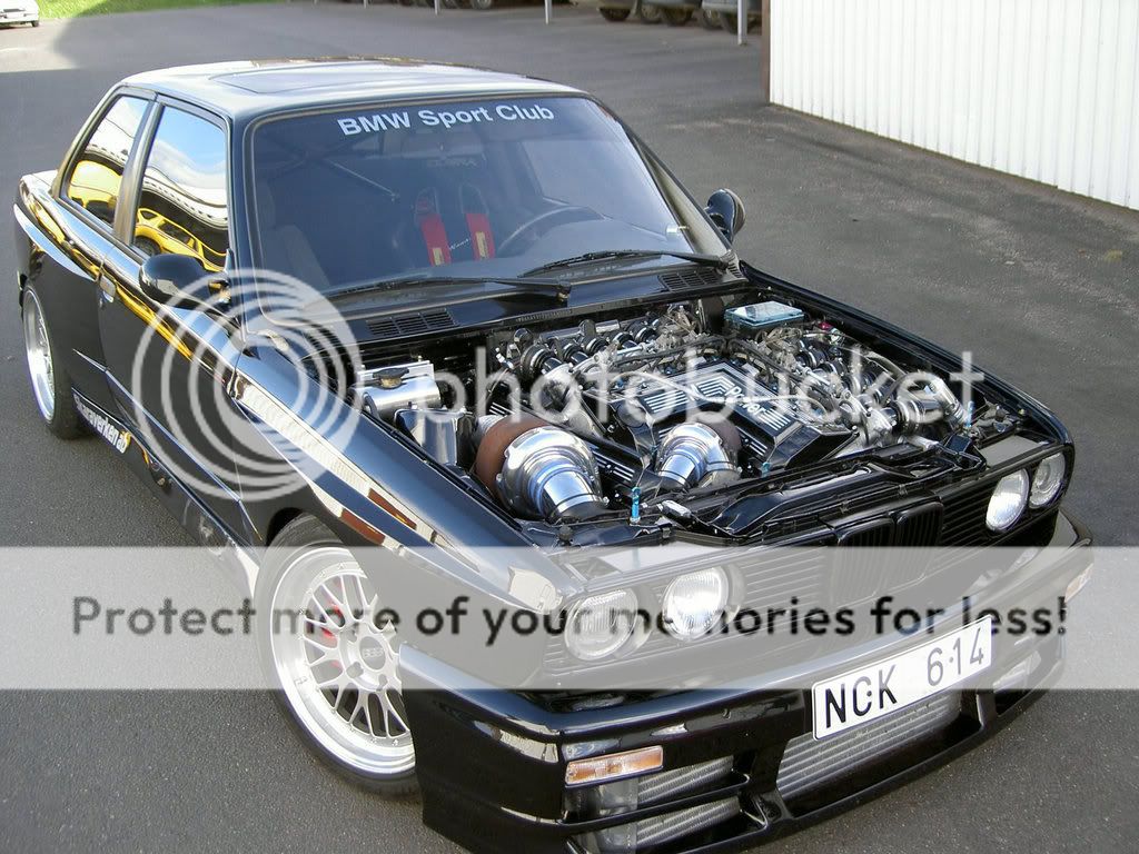

How about this....just an idea....lol
What the hell is that?
hehehe...some photoshoped pic that i found on the internet.
