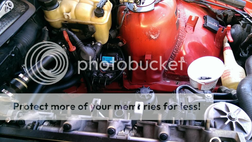

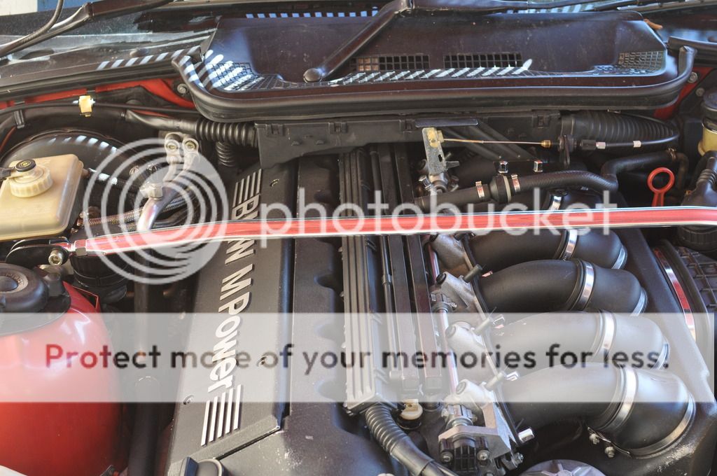

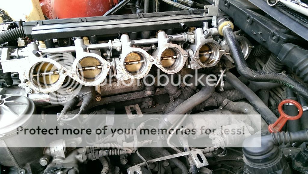

Some pics of the car ....well the engine bay really.

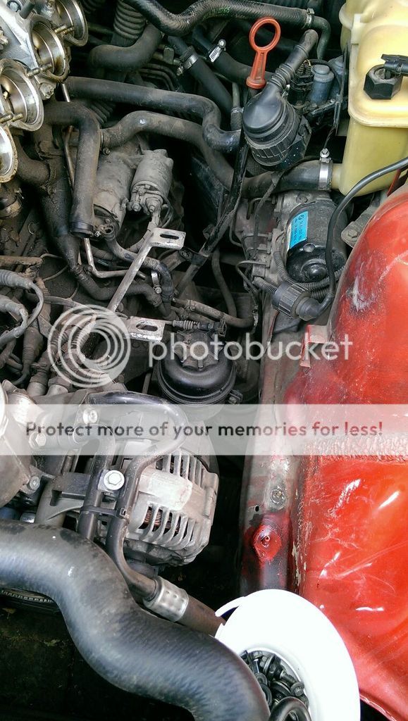

Before

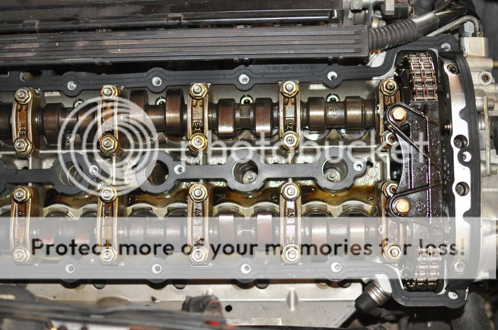

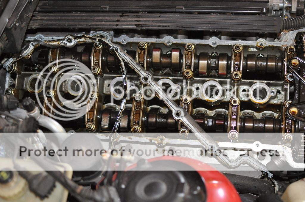

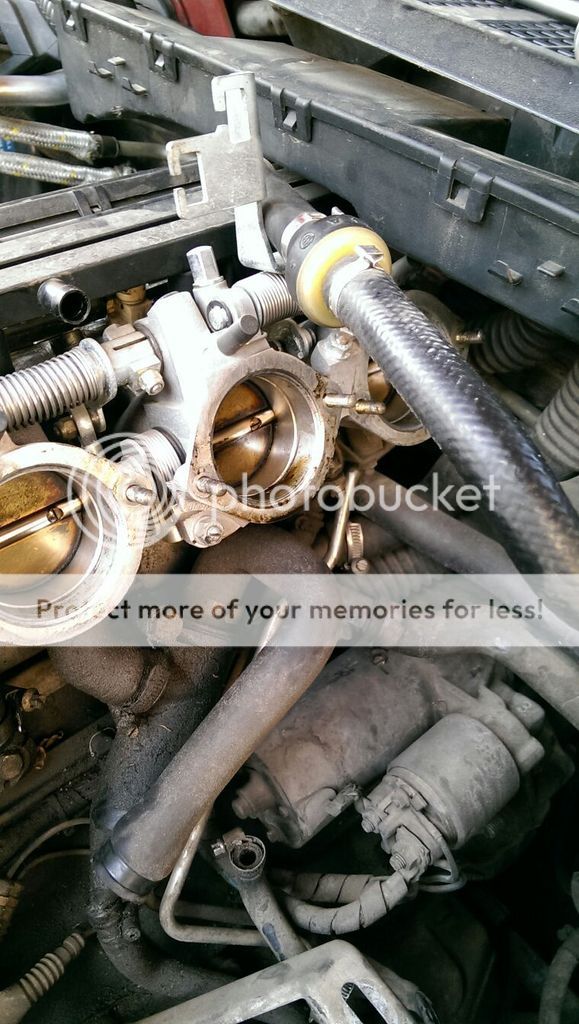

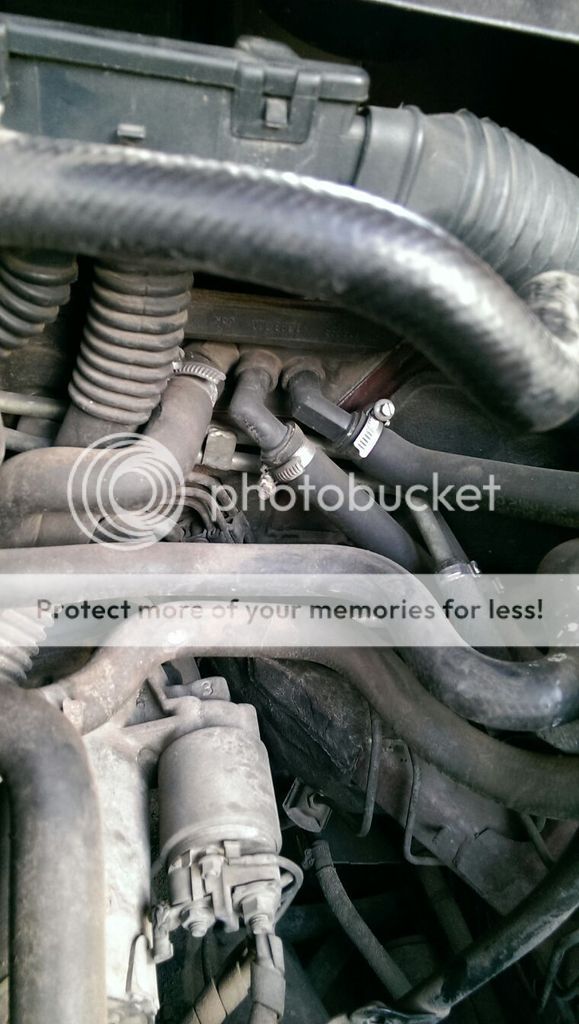

Brand new gasket destroyed by liberal use/excessive use of sealer.

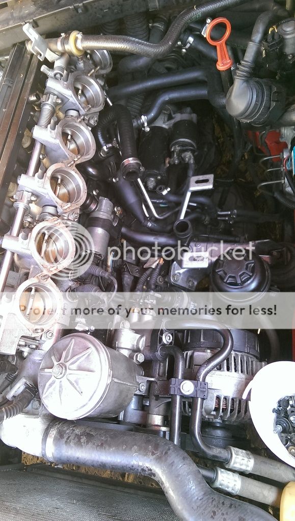

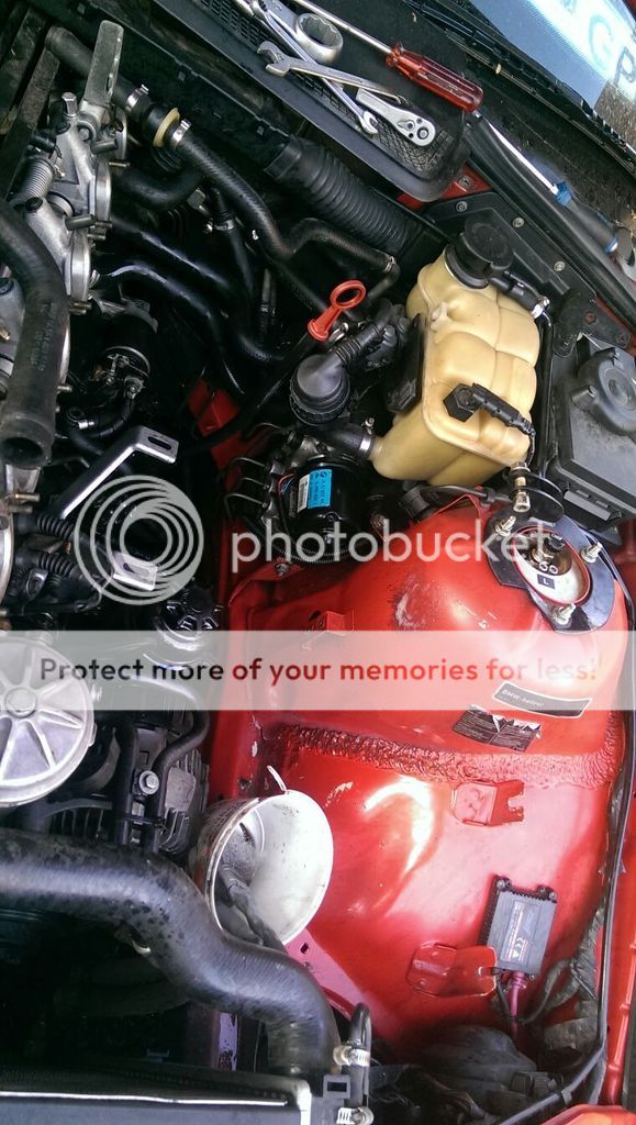

After
Peter@AEW

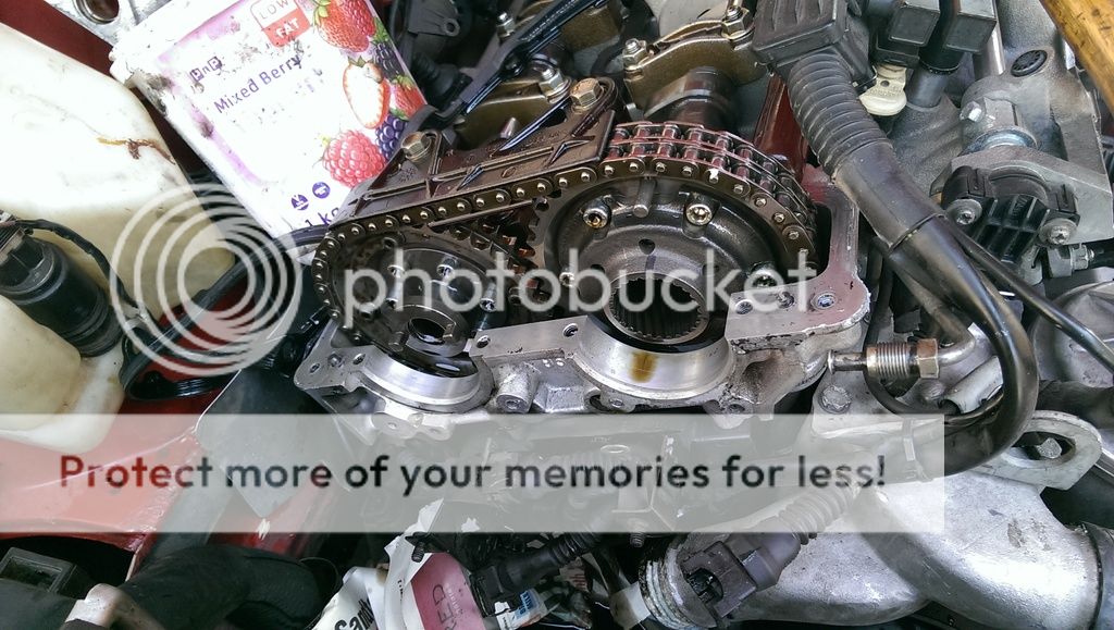

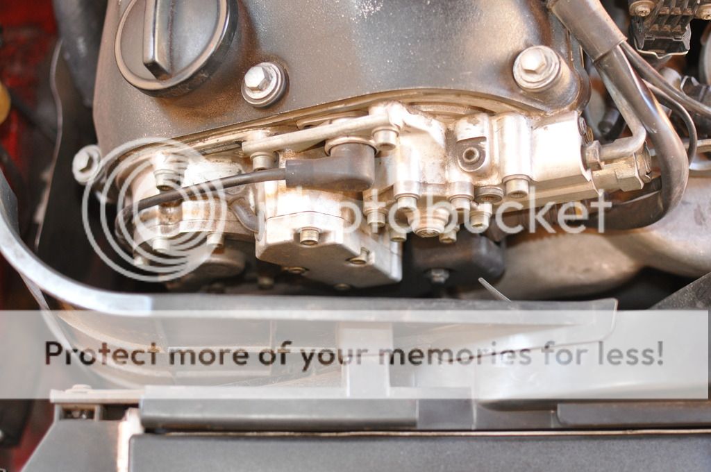

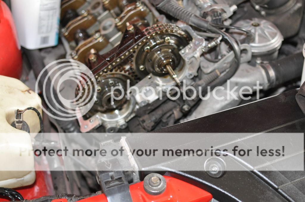

Car came back for erratic idle and the infamous rattle.
It is rare to get the s50b30 rattling however changing seals can lead to more pressure on the spline shaft and it can rattle.
Thankfully the s50b30 has only one spline shaft so I could not get it mixed up on re installation

That's some good elbow grease being applied there!
Nice cleaning, very hard to get deep inside those crevices!
