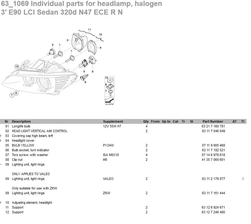

Does this help at all:
momo1
Thanks Bud
Yip this helps, I think il take the dead one out first before I buy a new one.
il have to be in the mood though , seen some youtube vids and the wheel needs to be take out as well.
