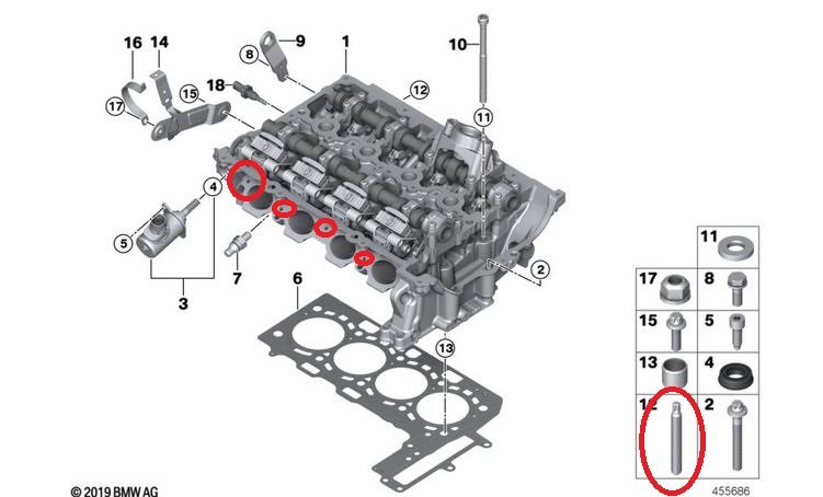

When I removed the bolts that hold the turbo onto the head , these studs unscrewed with the bolt , The bolt was really stuck onto the stud ,
I spoke to BMW and the tech there and he could not tell me as there was nothing on their system , for reinserting the new studs .
Does anyone know what they could be ? These are stretch studs im told .
I have the torque specs for the bolt itself , which are 10 10 10 10 10 then 16 16 16 16 , but not these studs that screw onto the head . See below , Iv marked it in red ,
They screw into the head .
Do I just hand tighten them in?
Thanks Guys for all the help!
