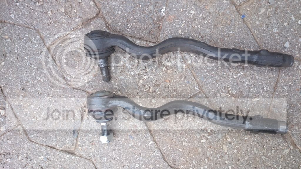

Some of you may remember me looking for Tie Rod Ends, for this lovely //M3 of mine:
Did a quick DIY on Saturday in between the rugby,a few beers and have a look at New VS Old.

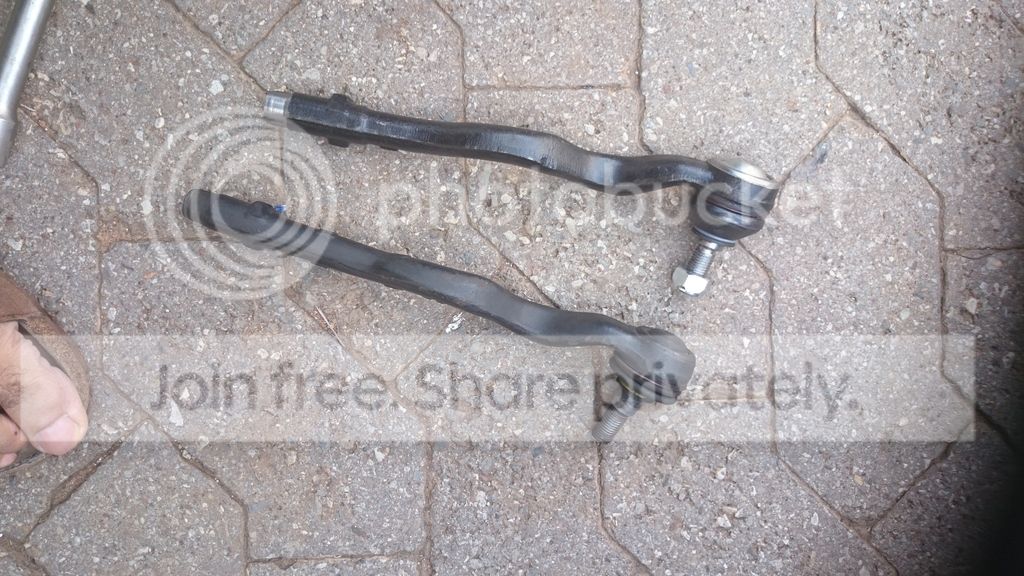

Note how compressed the old Tie Rod ends are:
Happy to report, no more shudder or vibrations, iam doing the alignment tomorrow...:=):
Peter@AEW
The rubber gets compressed and not the ball joint.....
Well done all the same now wheel alignment time

That's also as far as my talents goes, next trip is to your front door :rollsmile:
