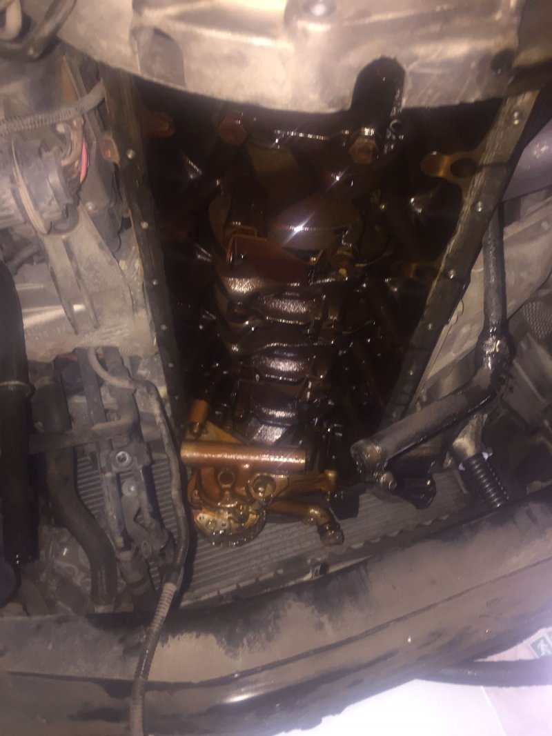

2. All the engine Gaskets need to be replaced. (Stripping job), expected it its a 20 year old car, it still has the original Gaskets.

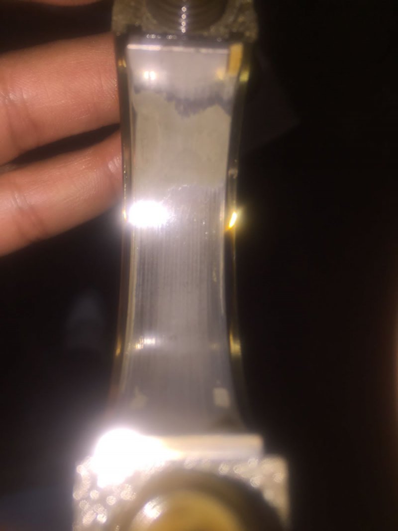

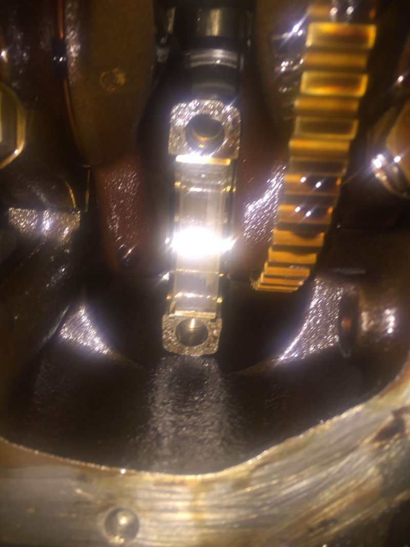

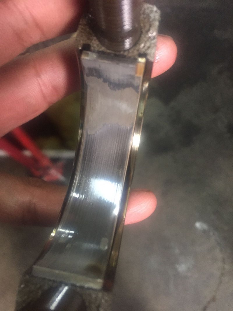

3. Big end bearings,  check on the wear, will make a call, (expected it)
