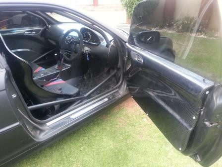

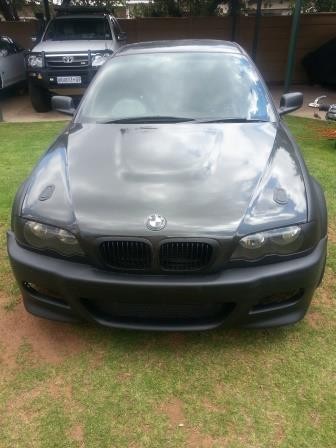

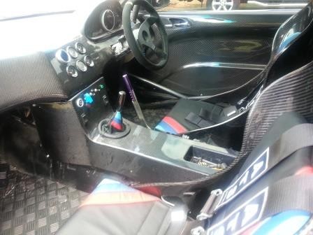

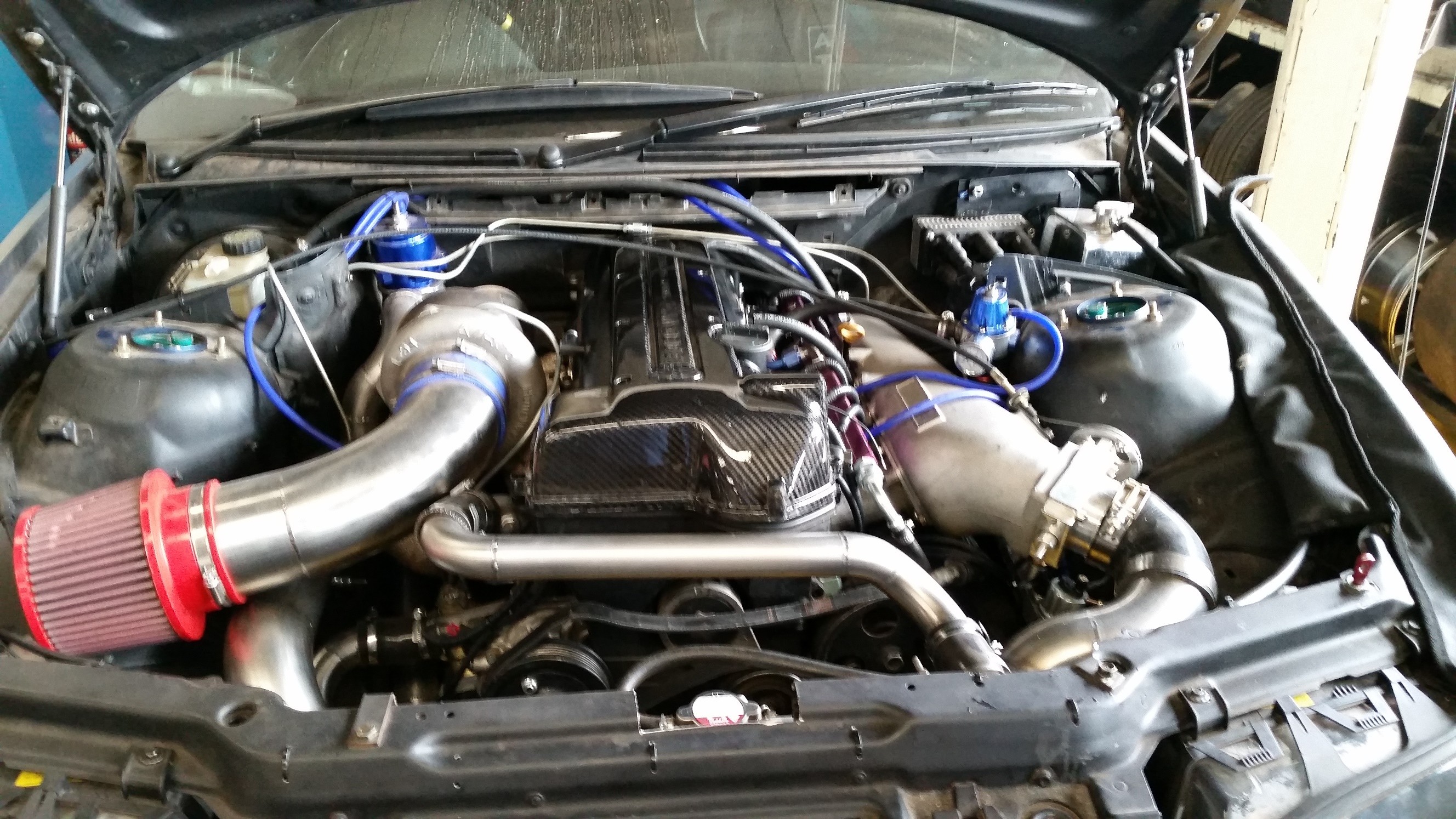

Hi. I am Leon and new to the site. Guess I will not be loved by many but to me my car is best of all worlds ... fantastic chassis (BWM) with a fantastic engine (Toyota 2JZ)
I built it as a track day car and street bruiser. Specs:
E46 CI 2002 (used to be 325)
Toyota 2JZ engine, Garret GT35, 1000cc injectors, ARP's, Cometic, standard internals, custom exhaust branch, e-Boost 2 controller, Domingo’s display and lots of other go faster bits. It will be tuned 2nd week in October and expecting 420 to 450 kW (570 to 610 hp) on the wheels
E46 M3 6 speed manual box
Original 325 diff with LS mod (this diff and gearbox combination has a theoretical top speed of 335 km/h at 7000 rpm)
Megan coil over suspension
Full roll cage
Carbon fibre - roof, bonnet, boot, door cards, dash, seats
