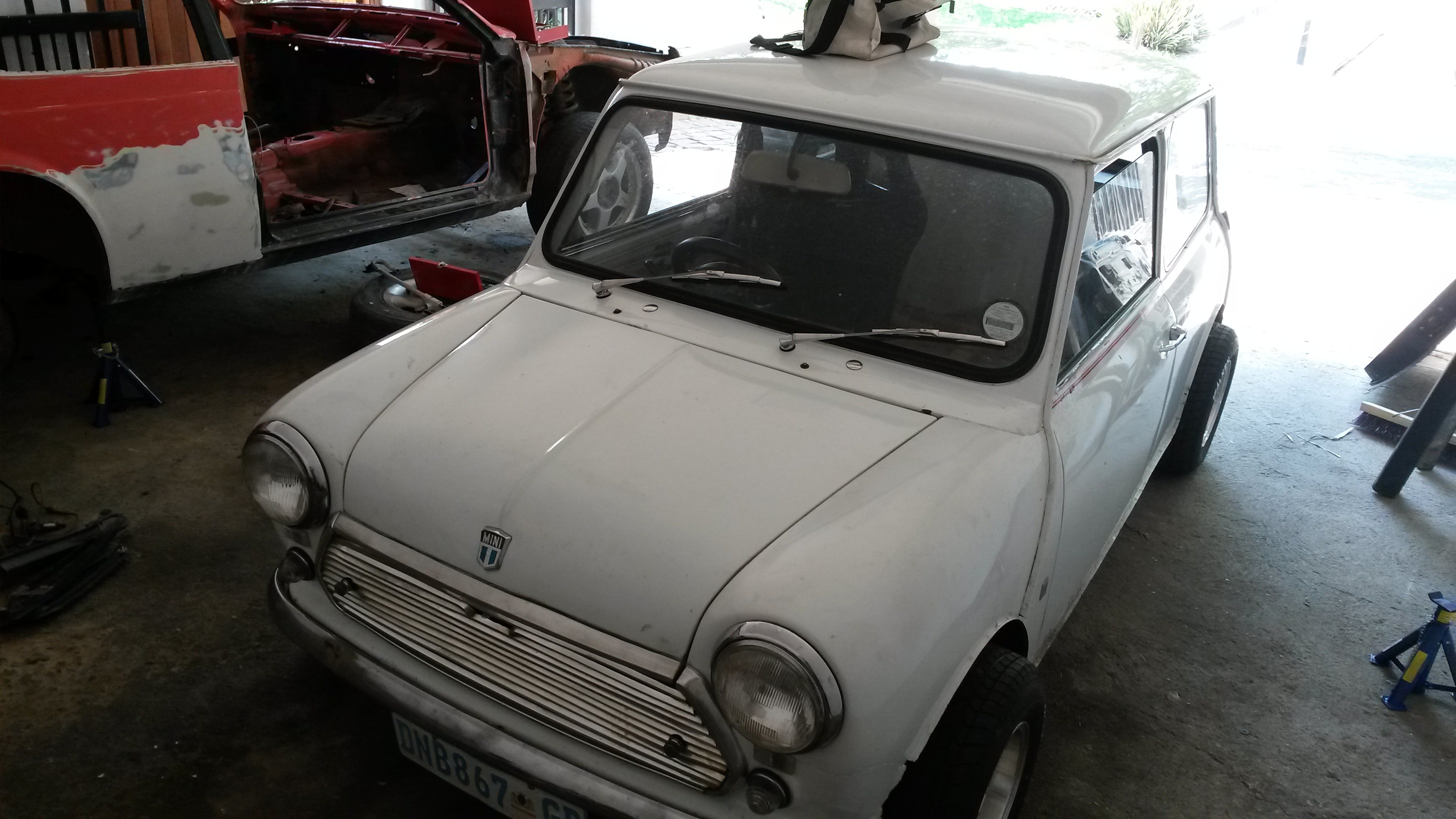

Ratex before her transformation;

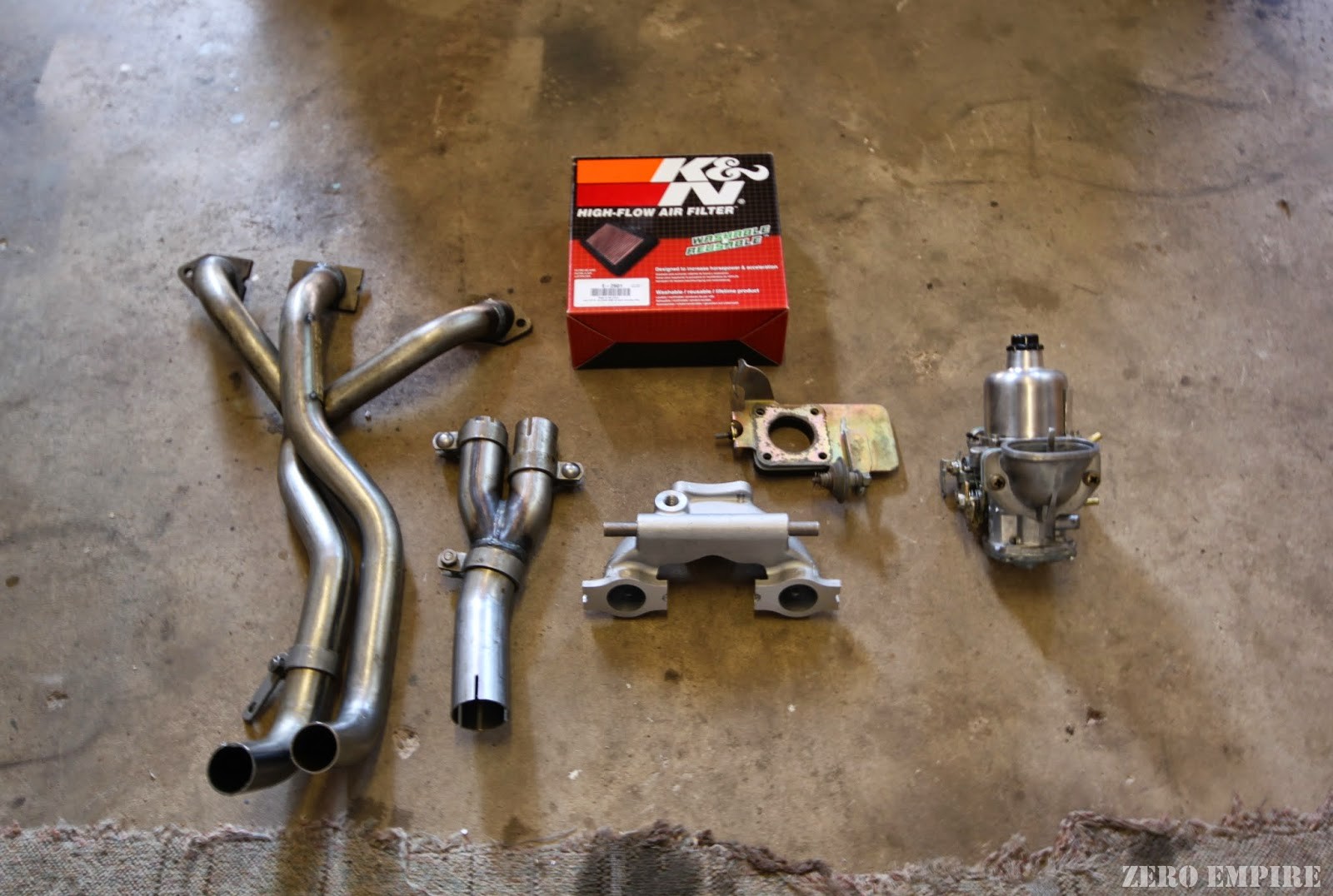

Right, so the first job was to liberate the breathing of the little beast.
Factory came with a F***** STUPID design for the carb and exhaust manifold. (This is a theme I will be revisiting, the Mini is an incredible design but some things are F****** STUPID). done for added 'cheapness' I guess, but the exhaust obviously heats up the inlet charge and kills performance.

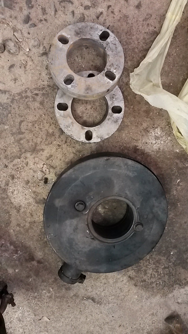

So, the factory carb is a 38mm SU, a little small for a big bore short stroke, but more importantly it comes with a combined inlet/exhaust manifold;
First job was to replace that shit with an HIF44 SU, a big bad ass 44mm side draught carb and a proper SEPERATE long centre branch exhaust manifold.
Boom!
No shit. Just those mods and I could drift the car in corners in 2nd gear.
Removed the factory pizza filter k@k too.

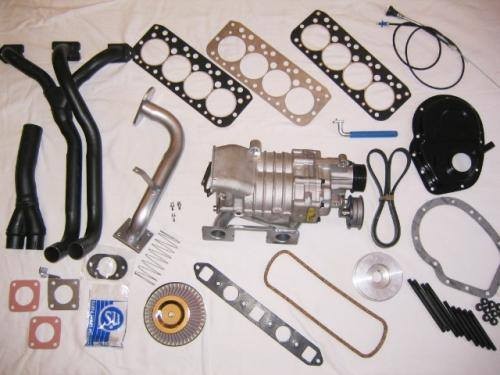

This means racing ideas out the window and the Super Charger kit is for sale
Super Chargers are too fiddly for my liking. Don't get me wrong, 150HP in a 600KG car would be going Full Retard and mad fun. 250HP per Ton is totally Full Retard.
kit is here if any one wants
http://www.gumtree.co.za/a-replacem...-mini-midget-morris/1001208541090910341125209

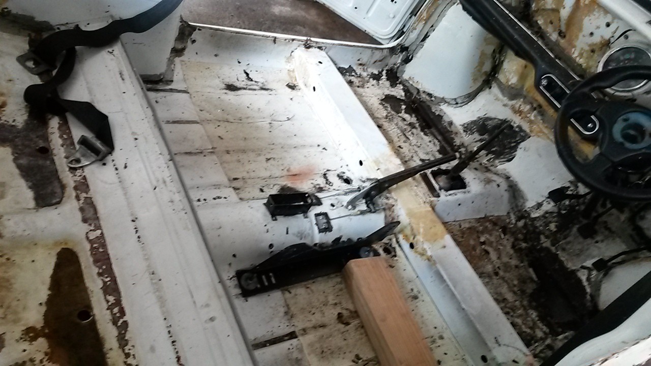

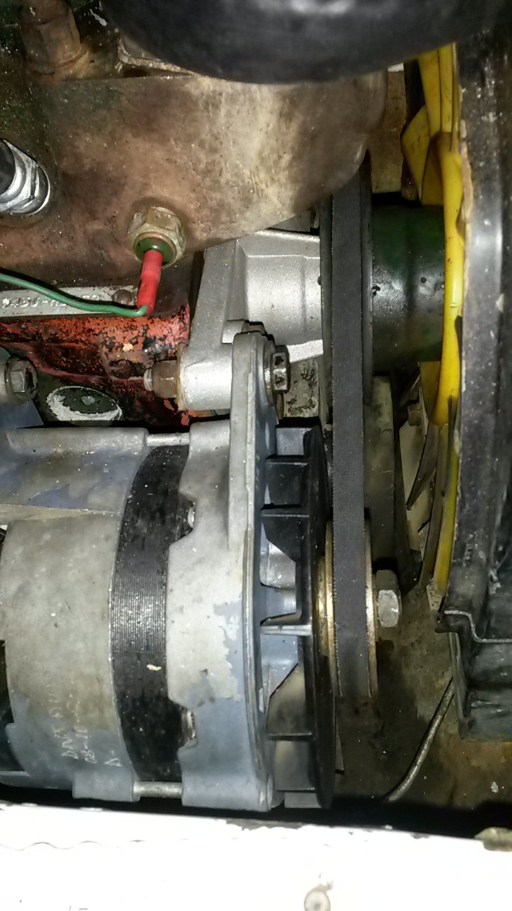

Interior has been stripped, de-adhesiveised. F****** STUPID! why cover the interior of a car in the fibrous adhesive?!!? Masks and gloves required to remove all that shit!
Also replaced clutch cylinder and water pump and new thermostat. And a new Alternator.
The water pump is a grudge purchase. Here's a lesson for life. Do It Yourself.
The F****** STUPID monkey who installed the alternator tightened the fan belt so much he destroyed the water pump. Que over heating! In the mean time I had refurbed the radiator and fiddled with timing and removed thermostat to cure the over heating.

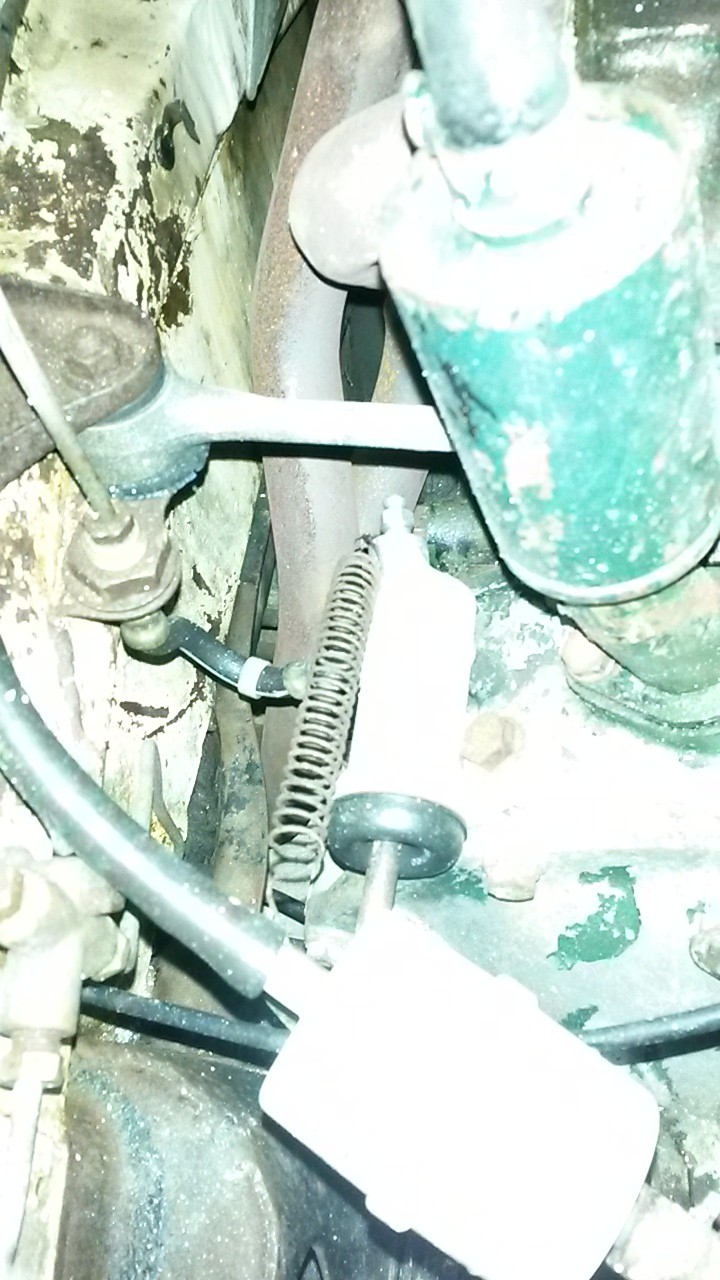

Clutch slave.

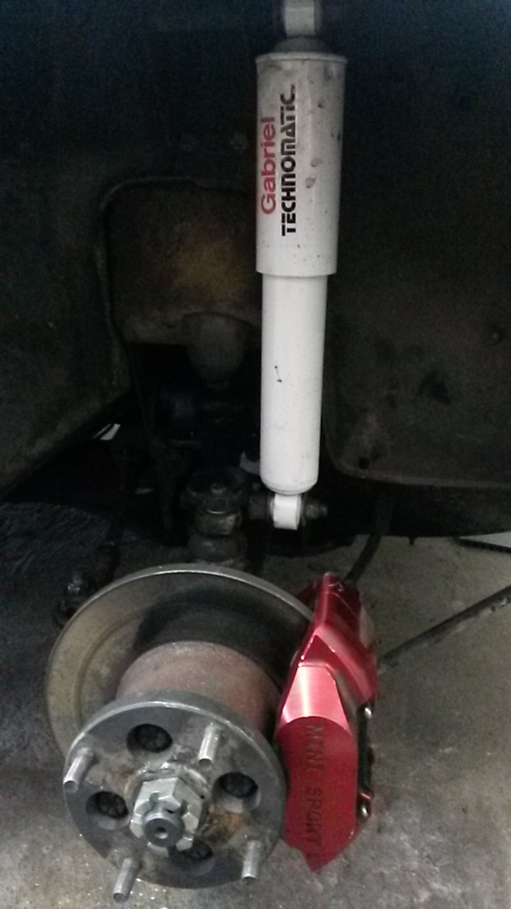

Mini is fast now, new Cobra Monaco racing bucket fitted, windows removed (temporarily), removing paint shaved about 10kg off the car, windows another 10kg. Wheelspins easy. So it was time to make it STOP.
Twin pot alloy calipers and 7.9 inch discs fitted at HUGE expense.
(I have been collecting Mini parts for 10 years and stashing them away in a shed, now they will see the light!)
Oh, and new Gabriel Technomatics all round. Can now almost lifts it's bum in the air if you slam the brakes!!
