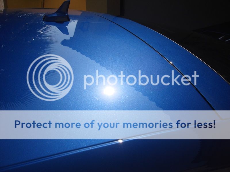

lambchop said:calypso said:Coolio. Dunno whats happening in that last pic, polish or burn on the fender, dunno why it isnt taped up. You just have to be so careful using a rotary against body lines. Dunno what polish, pads, RPM, pressue you are using, but you dont realise how quickly you can go through paint until have actually done it. Get some scrap panels or a kak car to try.
Please do consider buying a thickness gauge. Otherwise its an accident waiting to happen, and all the funds earned though polishing will just be blown on respraying.
Just my 2c, stuff that I learnt first hand the hard way while learning the motions of polishing. No reason why someone else should have to repeat my mistakes.
Dont forget plastic, Bumpers spoilers etc all very delicate areas. That last pic is very suspect. When a panel has been polished the light will not refract. so when you take a picture of the sun it will only show the sun, nothing else .. your picture shows a few other imperfections left in the clear coat.

Hey bro, it isn't a burn, just the way the light reflects off the surface :bravo:
Thanks for the tips too, we have actively research this before undertaking the use of a rotary :ty:

Im not picking on you work but let me show you the difference between your Sun pic and mine
Yours
Mine
