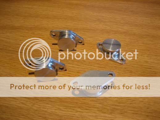

I'm ordering some swirl flap blanks from the UK and I'll be ordering some extra if anyone is interested.
To refresh the memory, swirl flaps are the little things on your diesel motor's intake manifold that sometimes breaks off and gets sucked into the motor and instantly destroys it. A simple solution will be to remove the flaps, but then you have to decently blank off the holes with these neat aluminum blanks which I'll be ordering soon.

Cost is 6 pounds plus postage EACH at the moment and you won't find cheaper. (Other sites run for between 10 to 15 pounds each...) This is for the 22mm as well as 33mm blanks. I recon depending on import duties (or at least VAT @ 14%), you will look at about R110 EACH which will mean you can potentially save you 320d for about ZAR440 and you 330d for ZAR660.
Why import? I had 3 quotes from precision engineering shops and they all came to about ZAR190 a piece. (You gotta love SA's economy...)

I think you can have them machined locally for much cheaper. I have made drawings in Autocad with all the measurements, just need to find it...
EDIT: I'll speak to my machinist this week and see if he'll do a batch for you guys. I see only ten blanks, but what size? I only have the dimentions for the 22mm one, which is what mine took.

That will be good if you can source them cheaper. I'll buy for sure. But like I said, the couple of quotes I got turned out more expensive since the labour required to manufacture the piece out of one solid piece of aluminum. Please keep us updated :thumbsup:

I also have a contact, what labour, a CNC can mill that thing out in a minute, the worst part is doing the cad design, I will own a CNC one day :)

And material cost is about R50 for more than enough material for 6...
ZL, also ask your contact, mine will most likely do it manually afterhours, so turnaround will be longer, but it might turn out cheaper.

Having a quick look, it looks like a 3 phase machining process
1. Mill the basic shape
2. Cut the slot
3. Drill the holes.
My guy is only going to be cost effective if we do a production run of say 1000, then we will be looking at like R25 to R30 a unit, but what are you going to do with 1000 swirl flaps...

I get the goodies to my doorstep for the full price. Having them made in SA will mean AT LEAST R80 or so courrier cost, so being R20 short on a blank doesn't really make it a less costly exercise...

i could machine them if your cad design is accurate?
cnc machinist in jhb
