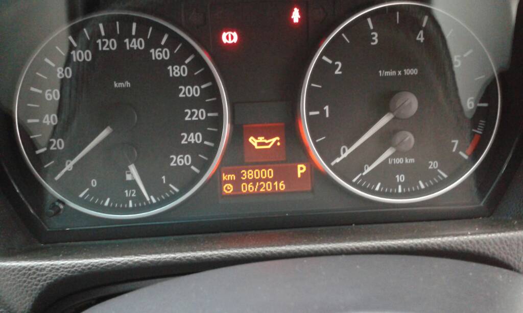

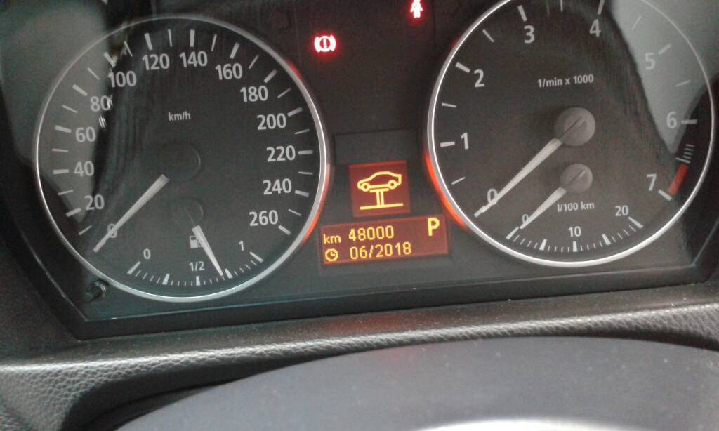

Hy guys I just got my bmw 320 I 2006 , I would like to know if the service intervals are correct in the pics attached or if they have been fiddled with because to me they seem rather high :-/

Just taken my E90 for an oil service today.
My next service is in 15000kms and next oil service is in the next 25000kms.
My car will get new oil every 10000kms as to what BMW suggest, its way to long in my opinion. Yours seem very long, phone BMW and see what they suggest.

Thats way too long. Both KM wise and time wise. If your car isn't doing the KM between services it should still be serviced atleast once a year

Does not look right to me! It's as if the service indicators were reset two years in the future! I would have to take a look at my car's service book to verify this.
But, the oil service in 25k km, not 38k km or more!! The general service interval is every 2 years and based on the lowest mileage service item. Brakes usually have a fairly high mileage if they are new.
I would make enquiries with the dealer that you bought the car from to clarify all of this!

Last recorded service was at 34000 km picked the car up on 49000km so next service I calculated should be 59000km but with this reading I'm doubtful to run it to that so first thing tomorrow I'm booking it in for checking and oil service. So all said and done the cbs systems on my car have been fiddled with. I did ask for service records before I got the car even took the key to bmw to check out and they told me all is well and now I'm doubting both bmw and the dealers just pray nothing is damaged by this issue :-(

service indicators can be set/reset/adjusted without hooking the vehicle up to diagnostics, so it's very plausible that someone could have fiddled or cleared them somehow. I say take it to bm and just ask them to correct the values per the service history on their system as you cannot understand the current values (car is on mp it should reflect on their system).
