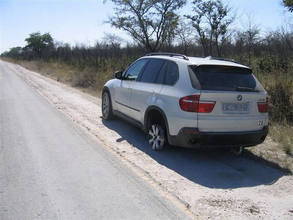

Be sure this doesn't happen to you:
More: http://www.autoviva.com/run_flat_disaster/member-post/2435
