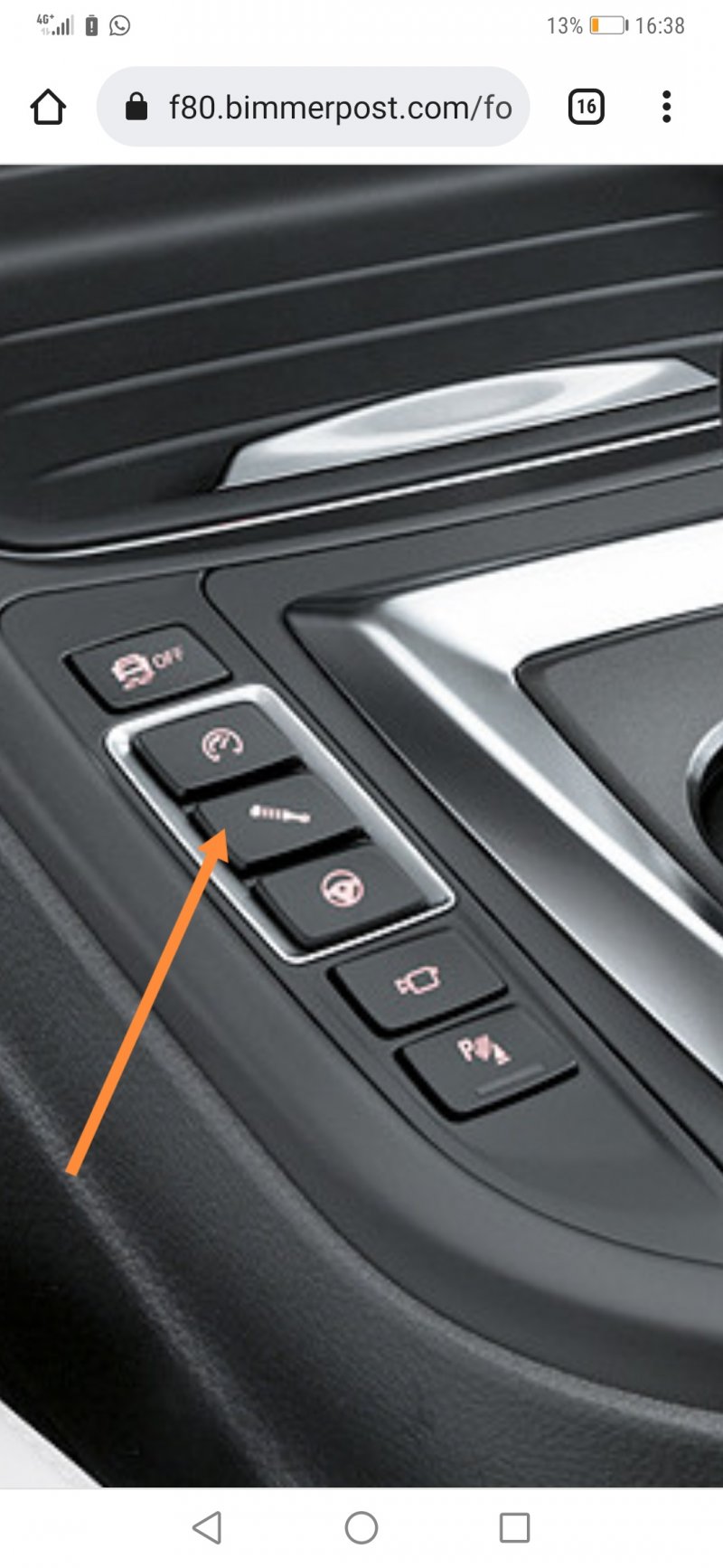

There is an EDC button on a non adaptive suspension car?
this is whats confusing me coz the car im looking at was confirmed as "not" having adaptive M suspension" as a build feature/extra, however it has that little button with the shock on it that moves from efficient, sport, sport+.. thats in between the engine and steering sport mode toggle buttons..
is Electronic dampening control and adaptive m suspension 2 different things on these cars?
Strange. I always thought the button was a clear indication of Adaptive suspension being fitted.
