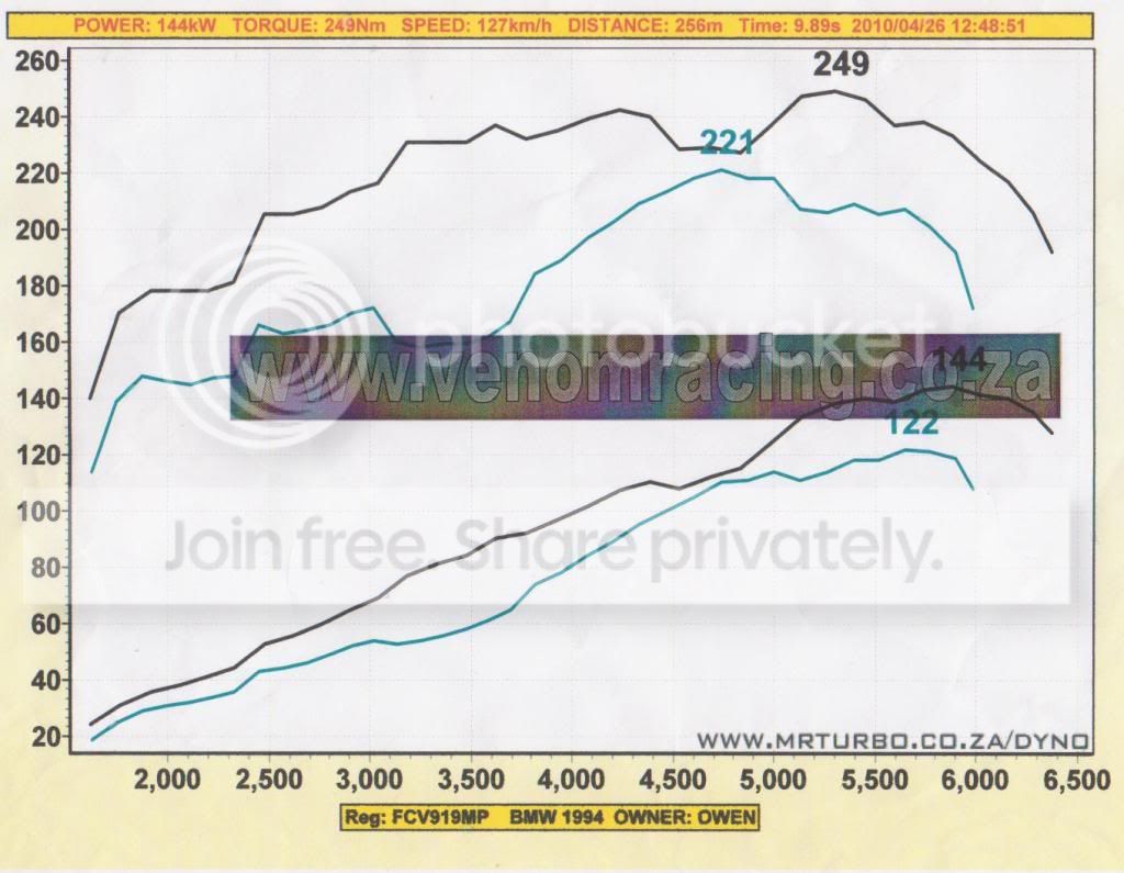

no bud.. stock 3.0L E36 M3's makes around 132kw on our dyno and bone stock 3.2 M3's makes 145kw.. up here the stock (really stock) 3.2's run 15.0 1/4 mile..
Doesnt matter what you rev as long as you fully use your powerband! Some bone stock E46 M3's struggle to get under a 14.6..
you welcome to come see the car any day! and also welcome to send Any Stock M3 around for a race!
Thats why we build it for the fun of the sport!
Here's the cars dyno graph so you can analise it.. also you will be amazed what a perfect power range to diff ratio can accomplish with minimum power! Diff = poor mans supercharger..

Bro i have been around M3's since the E36 was released. I know full well what they are and arent capable of.
That dyno must be a stingy one because here in JHB i have seen mide 150's to 160's for E36 M3's.
I dont know why you keep referring to "up here" i am in JHB so i know what they are running. 15.0 for a stock E36 M3 3.2 is damn slow, was the driver granny shifting ? I have personally seen them run low 14's at Tarlton, Wesbank you name it. And i know they were stock. 14.6 for a E46 M3 is also really really suspect. I ran a 13.8 @ 162 STOCK at Tarlton in my E46 M3. Sherwin as well as about another 100 people were there that night, so 14.6 the thing must have been sick.
Oh regarding your diff argument, are you trying to say the M engineers put the wrong ratio in the M3 not to take advantage of the power curve ?
That 328i starts falling flat on its face at 6000 rpm, but 6500 its all over. The M still has plenty of rpm left before redline.
This comment also amuses me "amazed what a perfect power range to diff ratio can accomplish with minimum power"

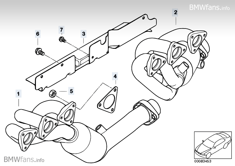

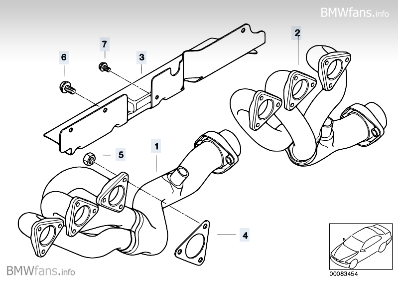

But here is the real killer. Yanks have a different spec M3 to us. Due to the strict emission laws in California, they have to have primary catts integrated into the branches. Huge restriction in the most important part of the exhaust.
US Spec branch:
Euro spec branch:
So what do the Yanks do? They sell the Euro spec branch as an aftermarket mod. So the branch we get as standard on our cars, they sell in the US as a mod. Evosport, for example:
And they getting like 30whp on the wheels fitting our headers on their cars!
So now, can anyone tell me why the Yanks can't gain what we are getting? Can one tune a car with 2 ovens in the branches? Those catts are retaining heat causing ignition retard. And they are restrictive.
European spec cars don't have catts in the branches and hence have a much free-er flowing, cooler running system & the tuning we do is not hindered by their setbacks.
So the moral of the story, is don't go comparing what gains we get to the Yanks as they have a different goddam car to us.
