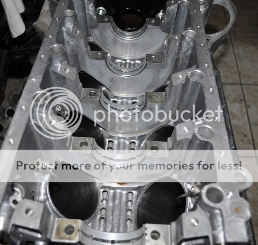

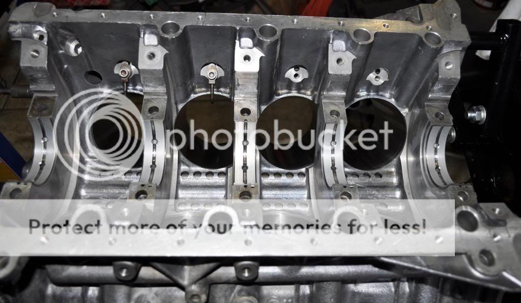

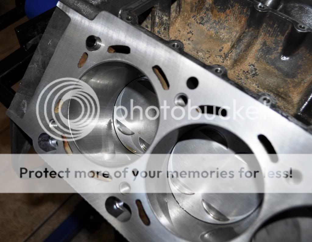

Block was cleaned and prepared for assembly.
Oil sprayers being fitted.

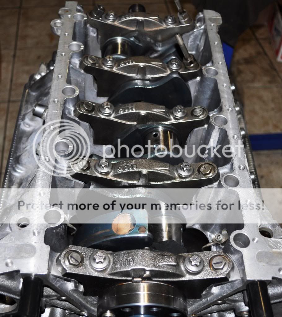

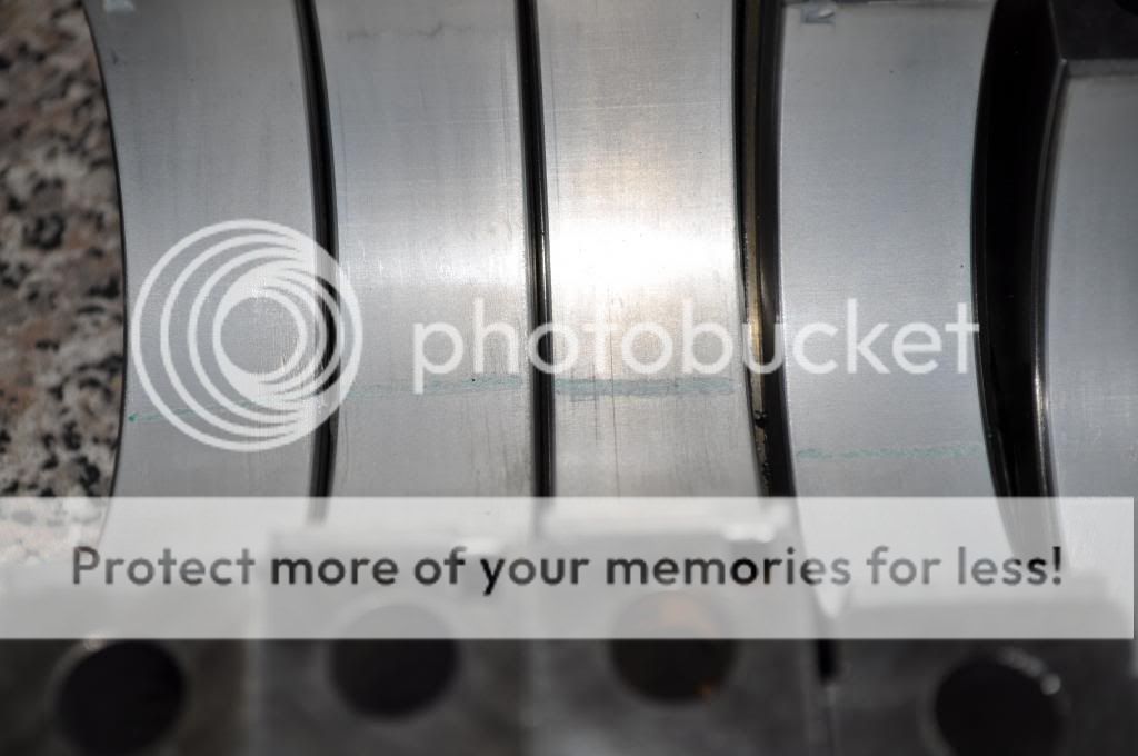

Mains fitted ready for dry measurement
Measured and all is well. Due to the crank having four bolt mains it took longer to set correctly so the vaseline reacted with the plastigauge.
Crank installed torqued and degreed.

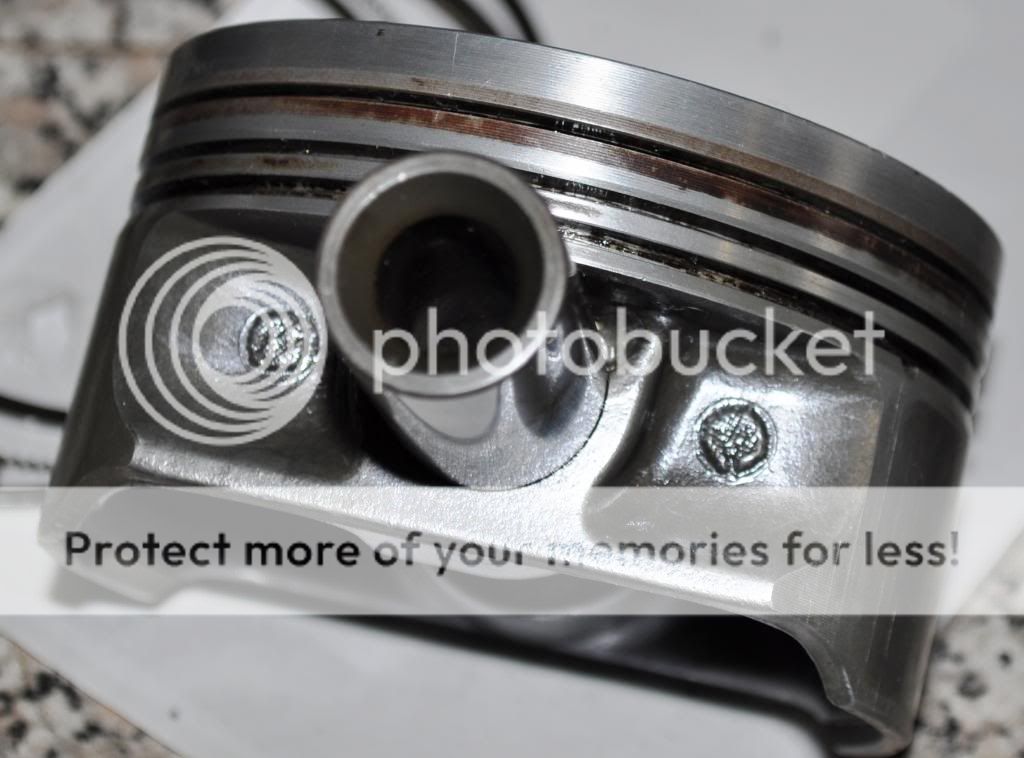

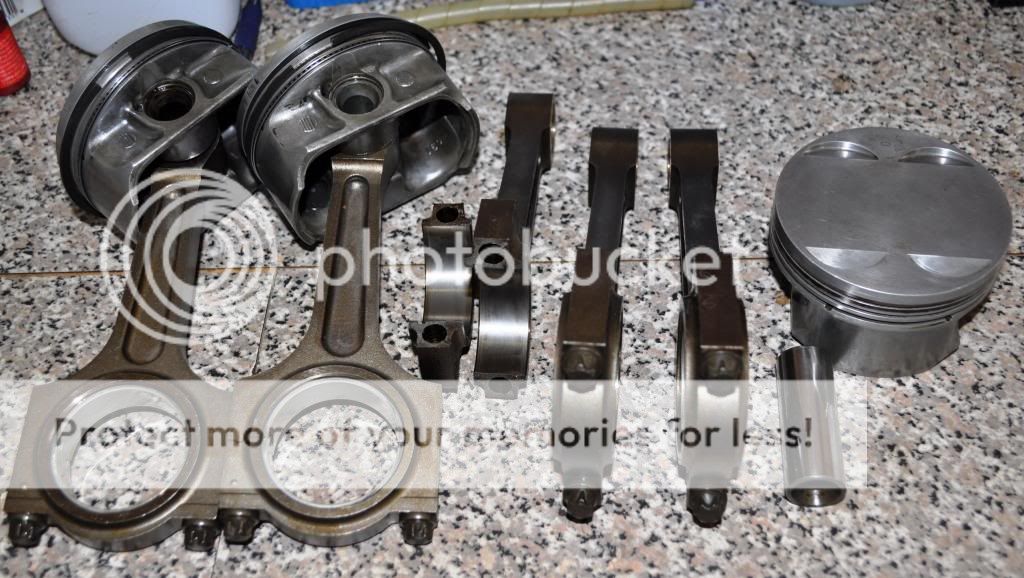

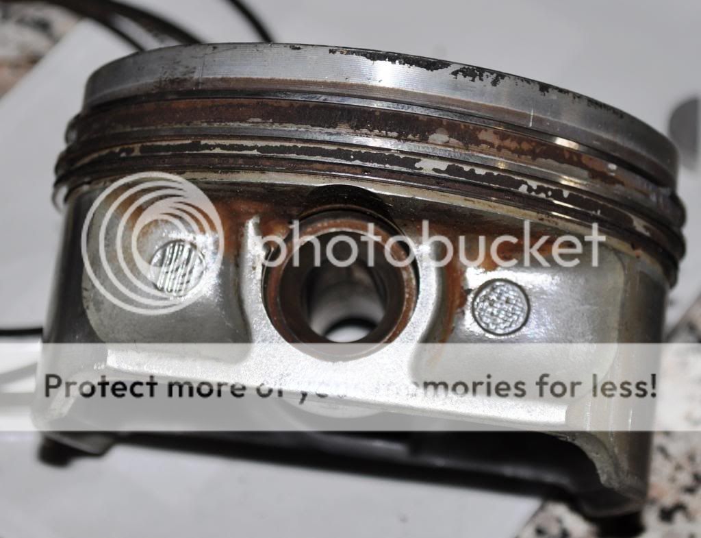

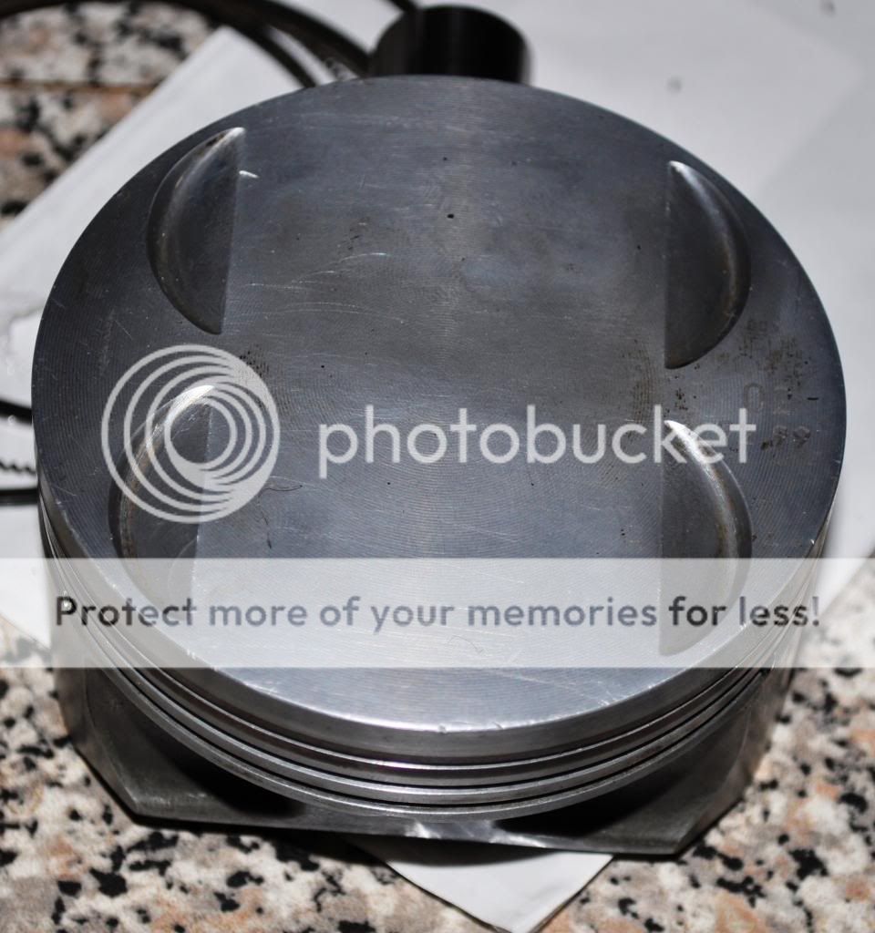

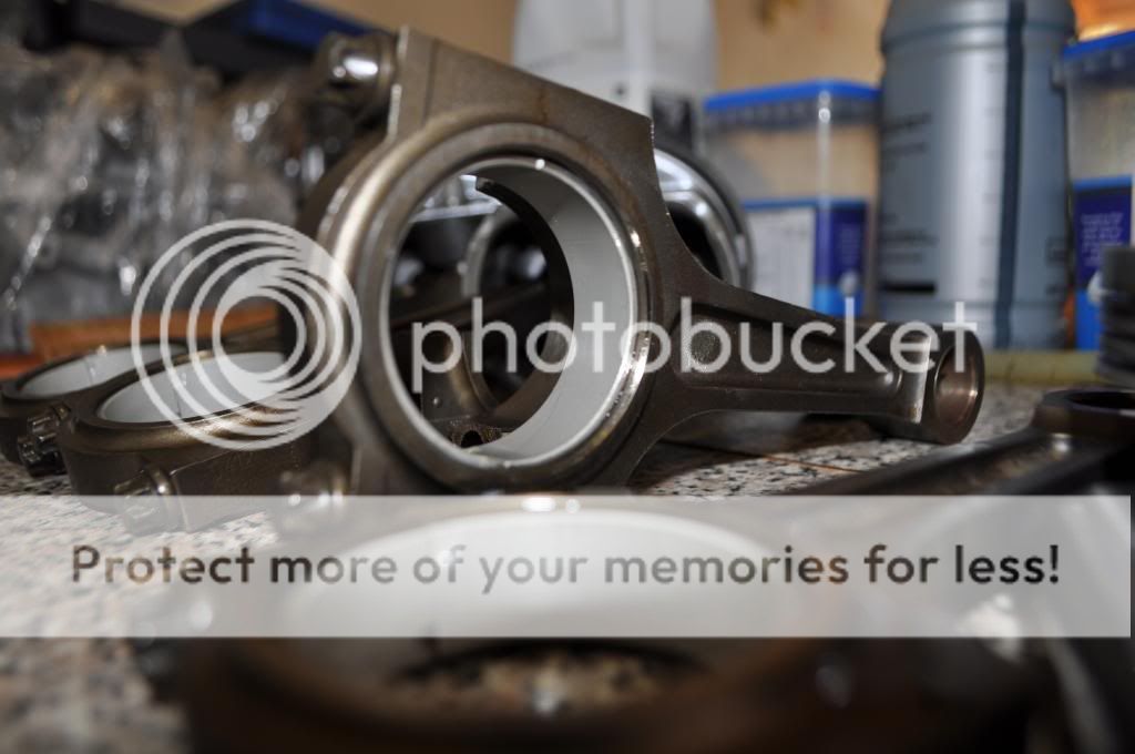

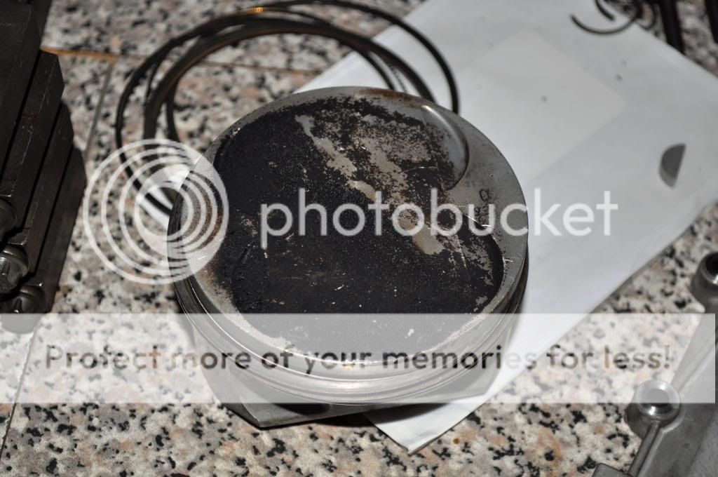

Pistons being prepared. Eight of them to clean so plenty time to reflect on ones belly button and solve global events.
Used a combination of Prepsol and ATF with a plastic brush and fine steel wool
Now we need rings and we are having a time locating them with the agents wanting R1 000 000 or something ridiculous.

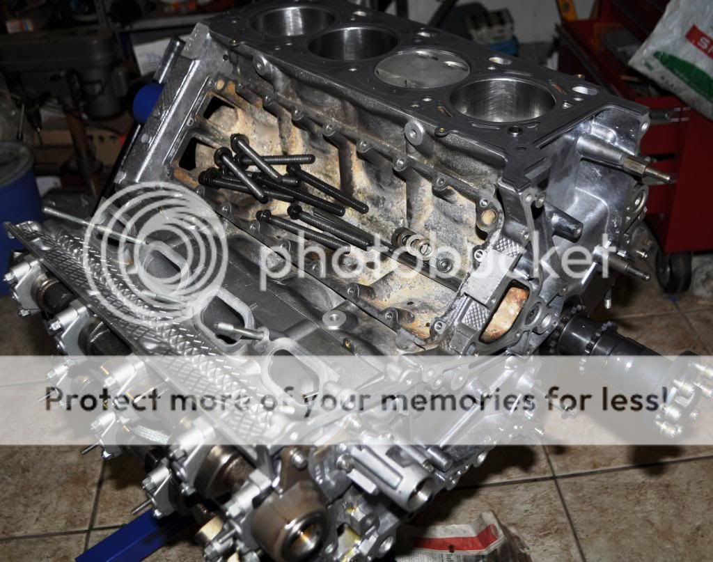

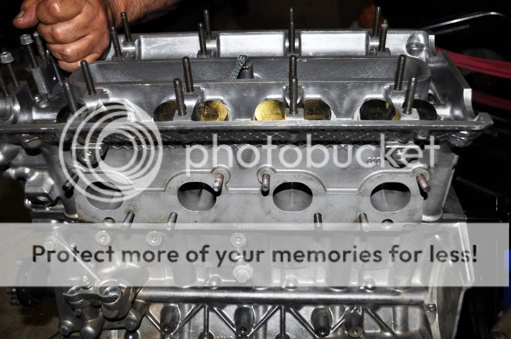

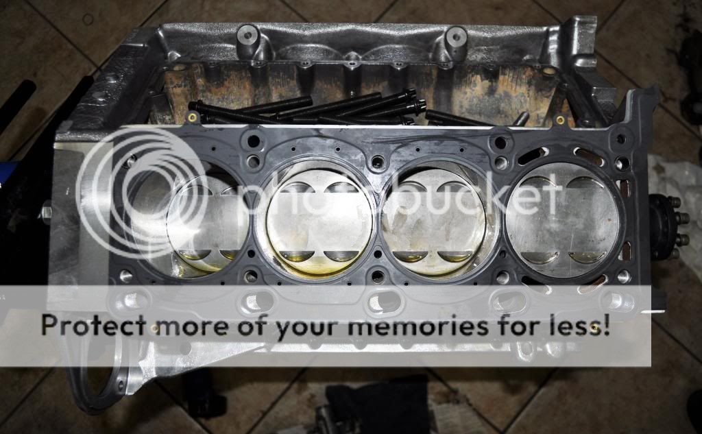

So......eventually located rings and we are on the home stretch.
One thing I can say about BMW limited run engines in this case an ALPINA motor, is that parts are difficult to find at reasonable prices.
I now understand why secondhand Japanese engines cost upwards of ZAR60 000 and your old engine.
We spent the weekend gapping rings and assembling untill we were stopped by the lack of 2 head bolt washers and an oil sprayer.
So tomorrow we will be ordering an oil pump at a cost of some R3 000 000 and a few bits and bobs.
Pics in a moment

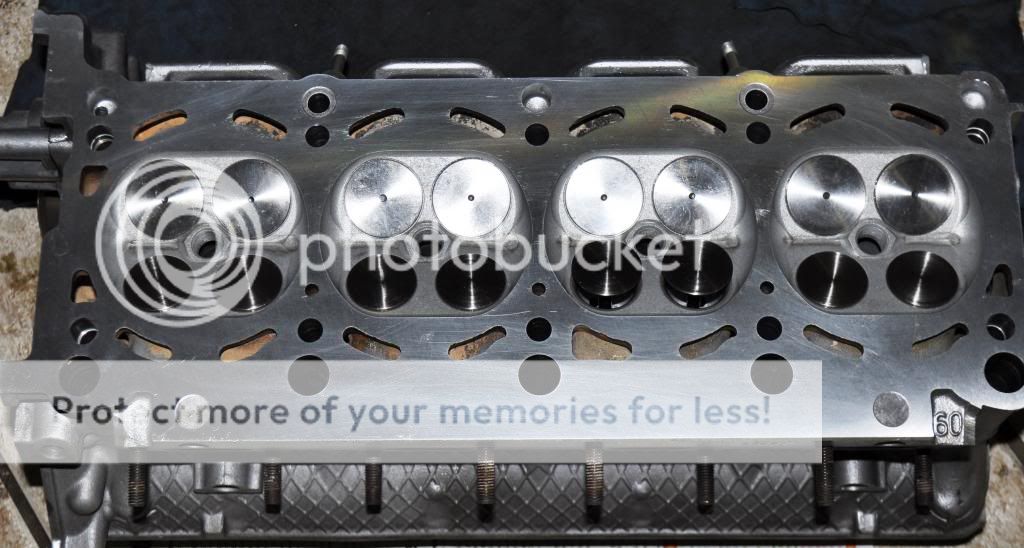

Looking good Peter. Just love the shiny new valves.
