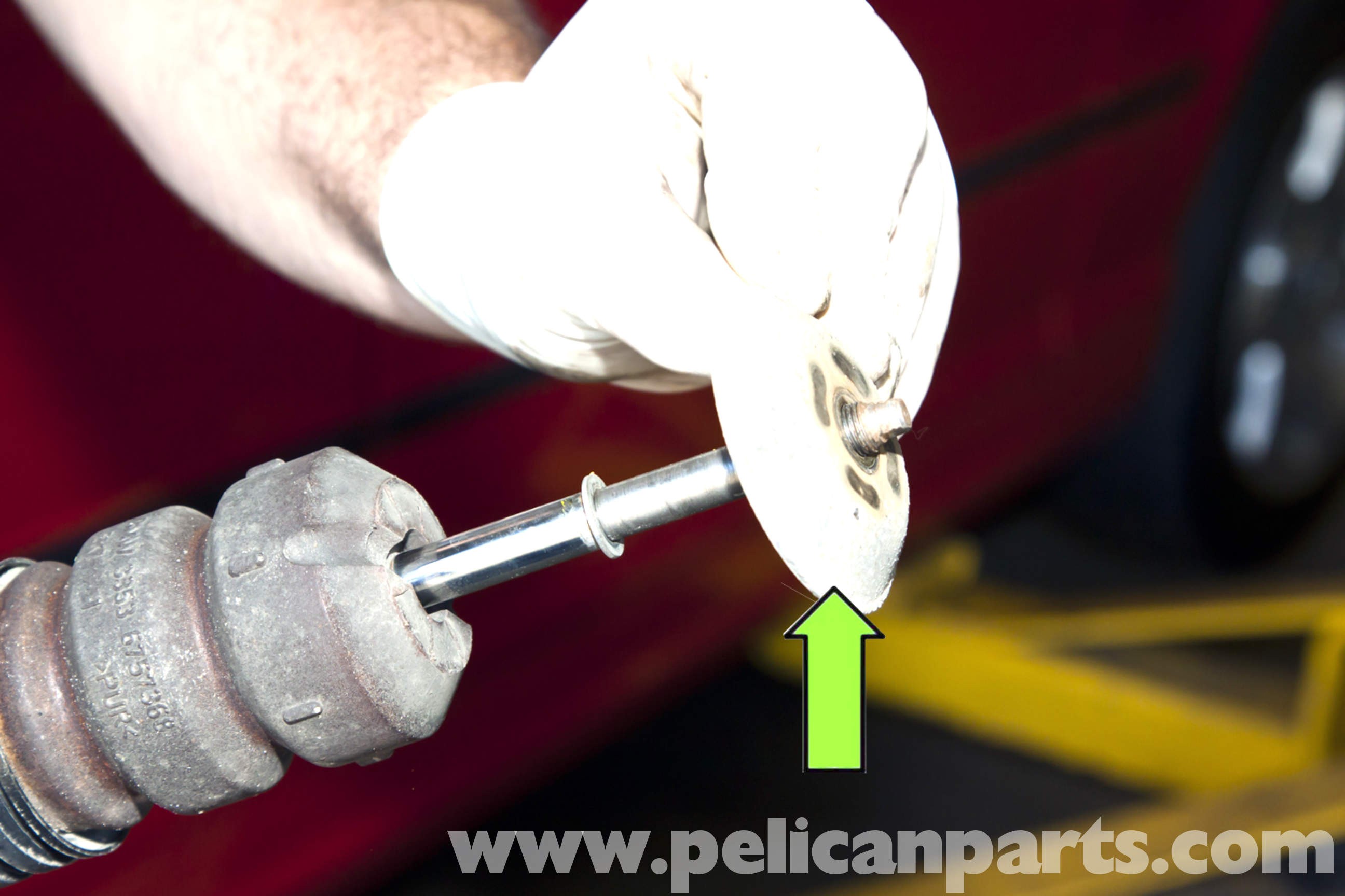

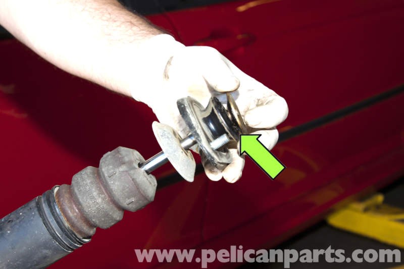

is this on a E46? if yes.. when you're re-assembling the shock, are you putting the bits in the correct order?
you could be forgetting something when putting it all back (that little washer in the first pic has to be there btw) .. have a look at these pics for the right order:

It's a e36. I put everything back just as it came out the old shock.
It went well for just over a month before it started doing this.
