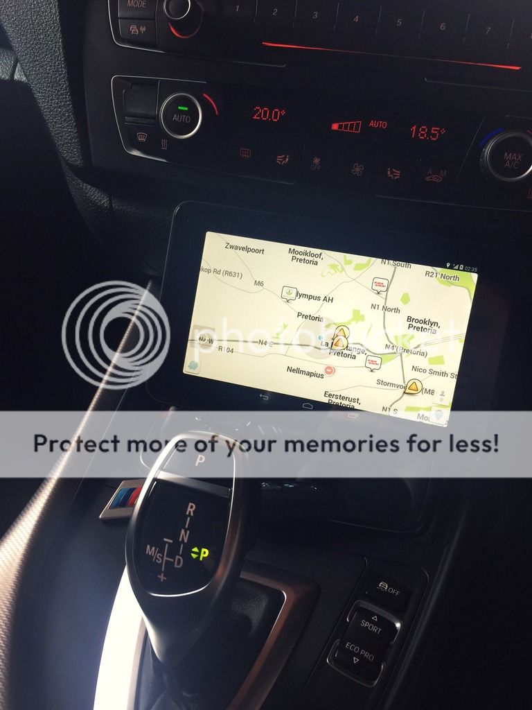

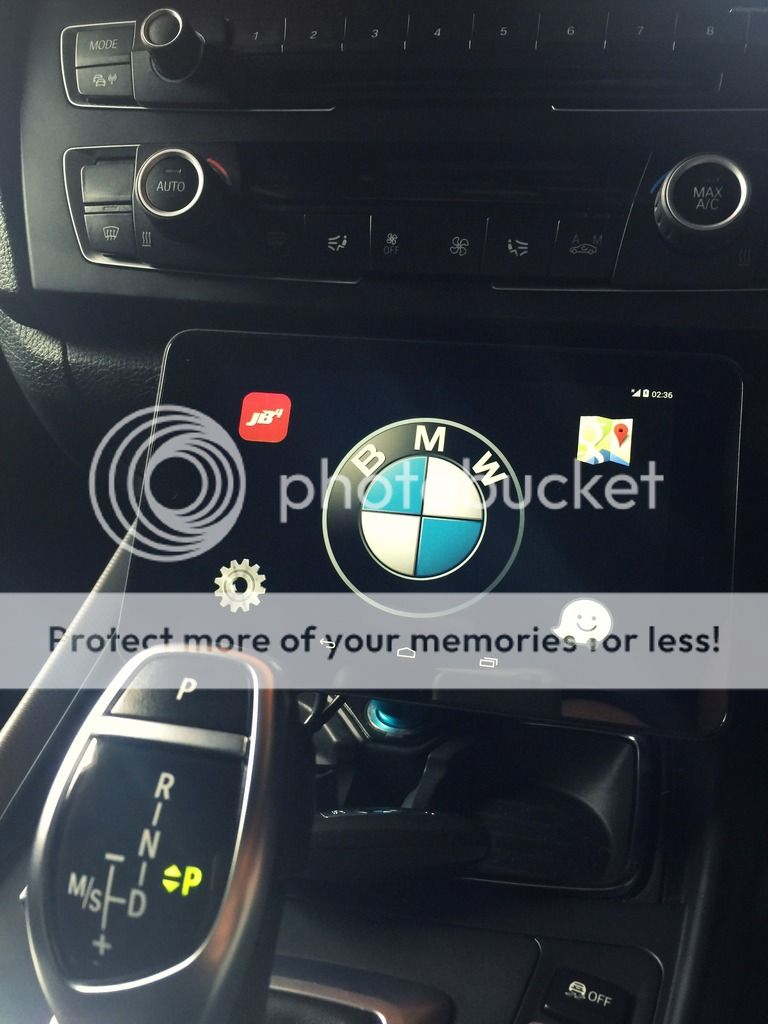

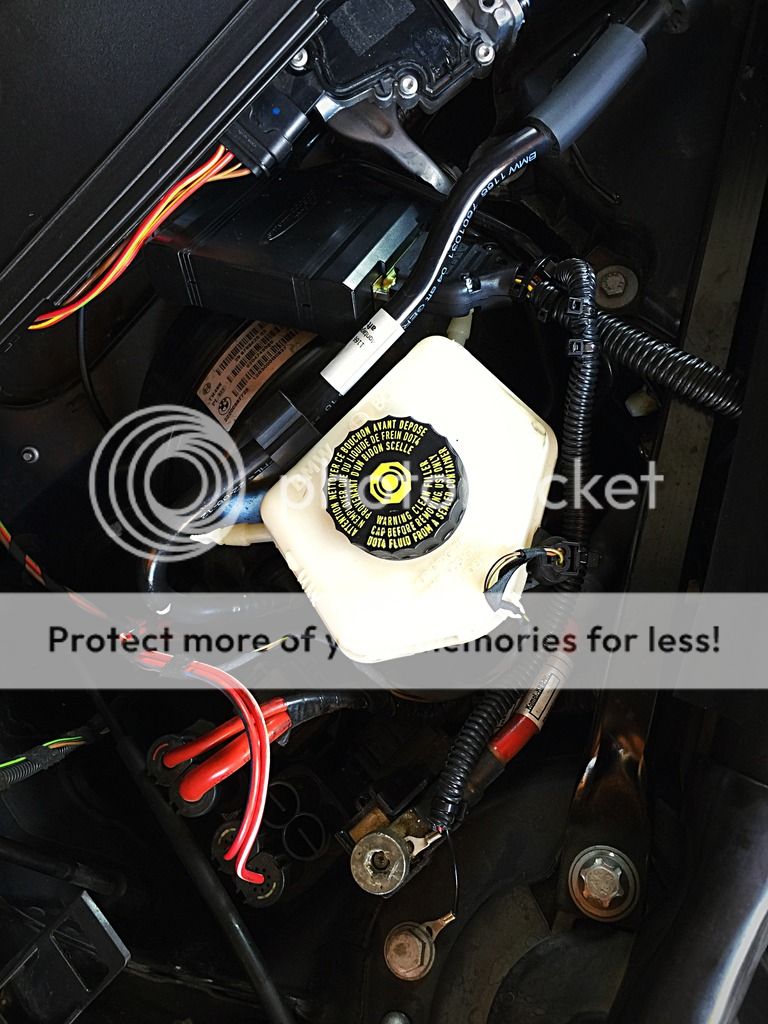

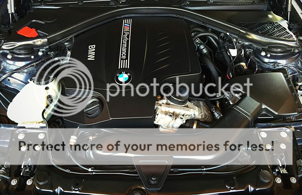

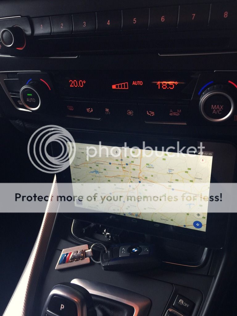

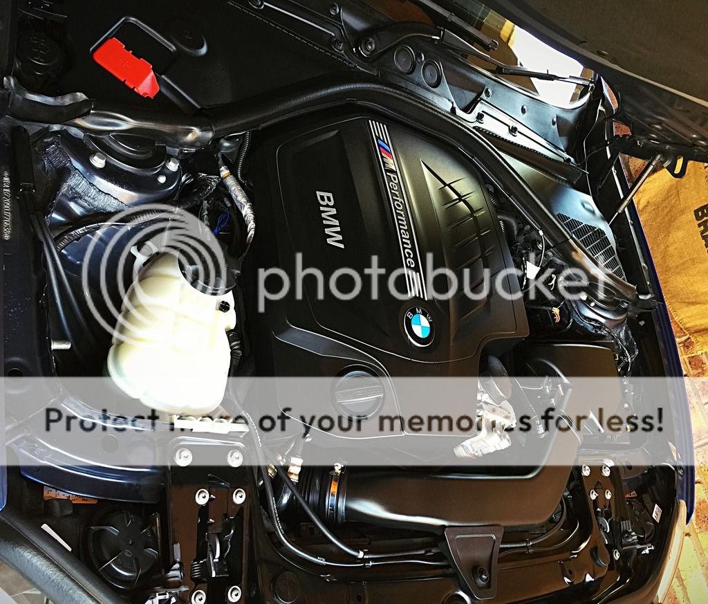

Got some ducting to hide some of the JB4 wires and make it look more stock. Gave her a nice wash and finished my tablet install.

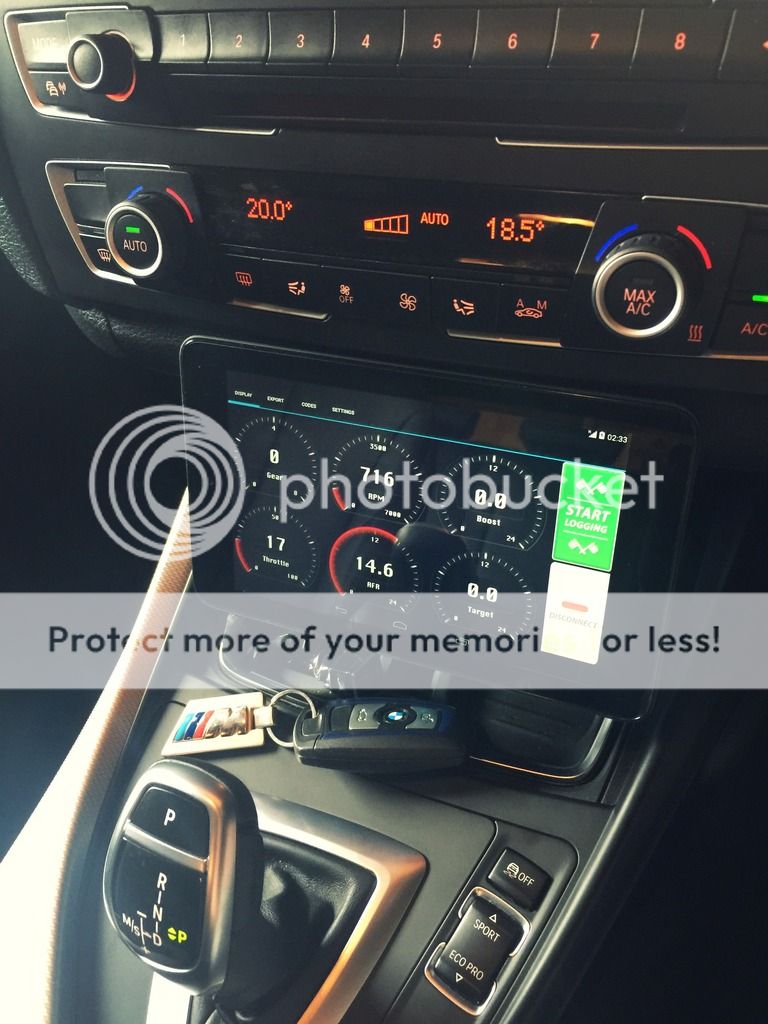

Tablet was tricky as I had to solder a 100k resistor into the signal wire to get it to charge and use OTG functions at the same time.
Worked :cartel:
Tablet is stuck in place with velcro so its easy to take out.

JB4:
Tablet Stuff:

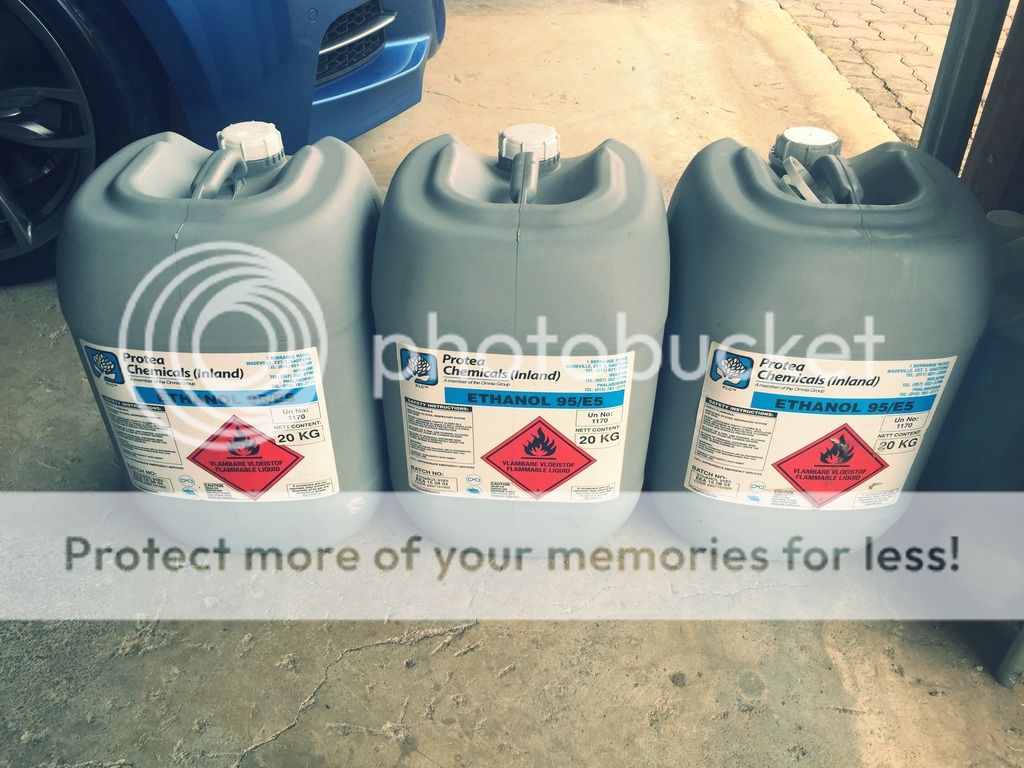

Yep, especially after adaption and some hard pulls. I strongly recommend running some eth to get the full "holy crap this thing goes" experience. I bought a jerrycan and just chug 5-10L every time I fill up and it really makes all the difference. Considering the price of eth, a tank of fuel now costs me +-R25 more. I can live with that.

Hey bud will love to know what's needed to enable the tablet to charge while plugged into the jb....have the exact same setup but annoying having no to remove tablet for it to charge all the time
