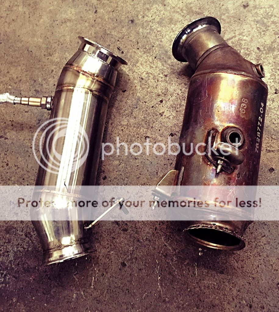

I got my 100mm downpipe installed at Swirlflow Customs, very happy with results. Its a different car 3000RPM+. The cold start noise is insane.

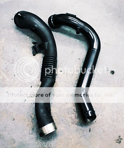

Also got them to build me a charge pipe. Using silicone on both ends with clamps. Pushed her hard over the last 2 weeks, no problems. This mod is purely for peace of mind.

Nice mods. Post a vid with exhaust sound after DP was fitted bud.
