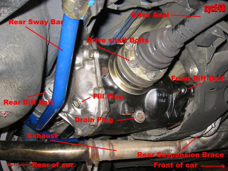

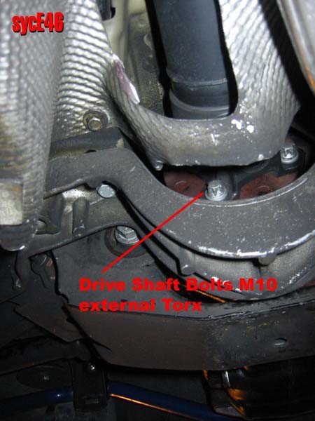

Backlash was driving me mad. And the fear of another breakdown. Put her up on stands and found the propshaft torx bolts to diff were loose - could turn them by hand. Poor show!
So guys I can state that the work on the propshaft itself was great, but fitting by his staff failed. Make sure you check yourself.
Drive Shaft (from http://www.bokchoys.com/differential/pictures/Differential Diagram.jpg):
Propshaft (from http://www.bokchoys.com/differential/pictures/drive_shaft_fig4.jpg):
