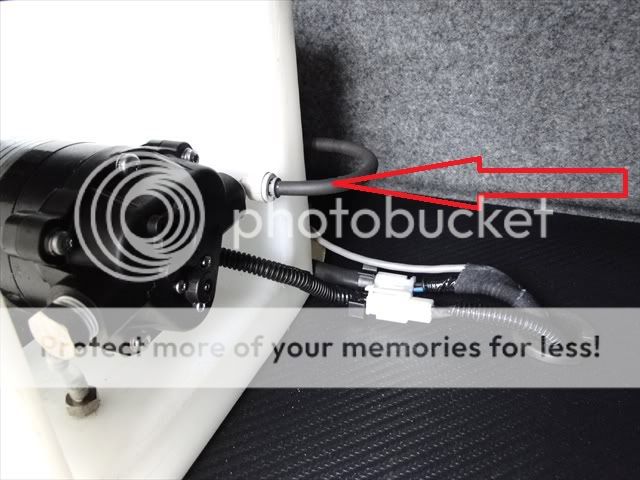

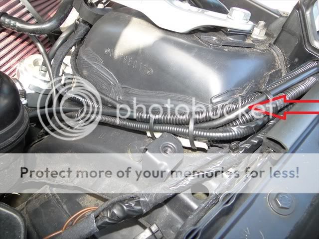

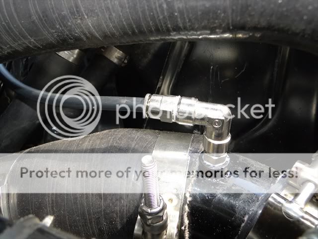

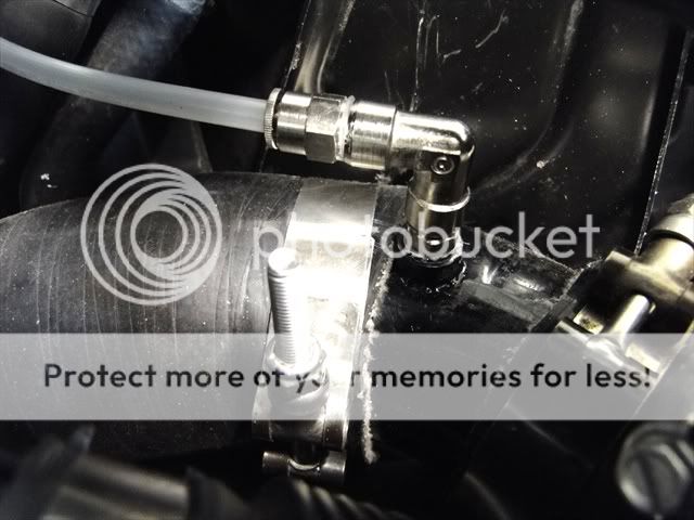

Here are some pics of my insulated meth tubing. You can get the insulation tubing from Builders warehouse or an electrical shop. Just take a piece of the meth tube with you so that they can give you the right size and thickness for the insulation tubing. You can also heat up the insulation tubing so that it fits tightly on the clear meth tubing:
Here is a pic of the clear meth tubing:
Here is one with the tubing:
Here is the insulated meth tubing in the rest of the engine bay:
Here is the tubing at the pump area:
I hope these pix are of some help to you.
