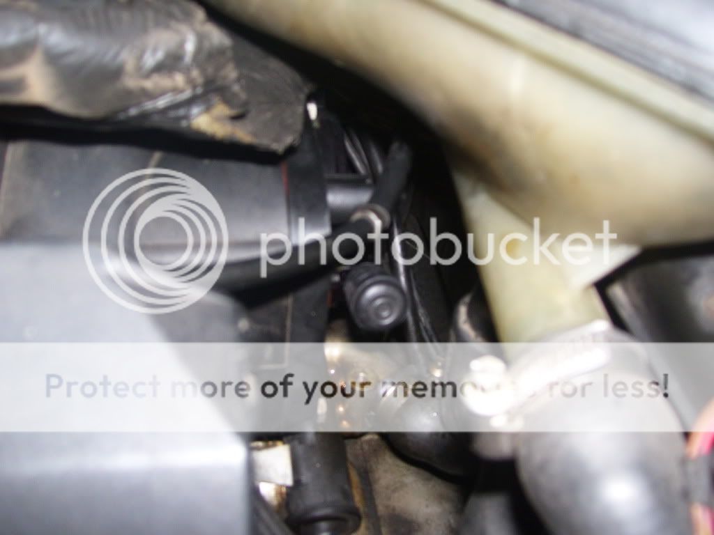

It's the rubber blanking plug on the PCV brake vacuum hose (that the E34 540 doesn't have anyway)
So basically when he tried to start it, his 540 backfired and blew his plug off... I suggested he now secure it with a large cable tie.

The culprit. See that little piece peering out (centre of photo)? that's the little bugger

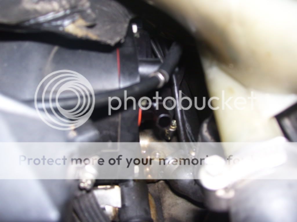

This is what it should look like. (again, centre of photo)

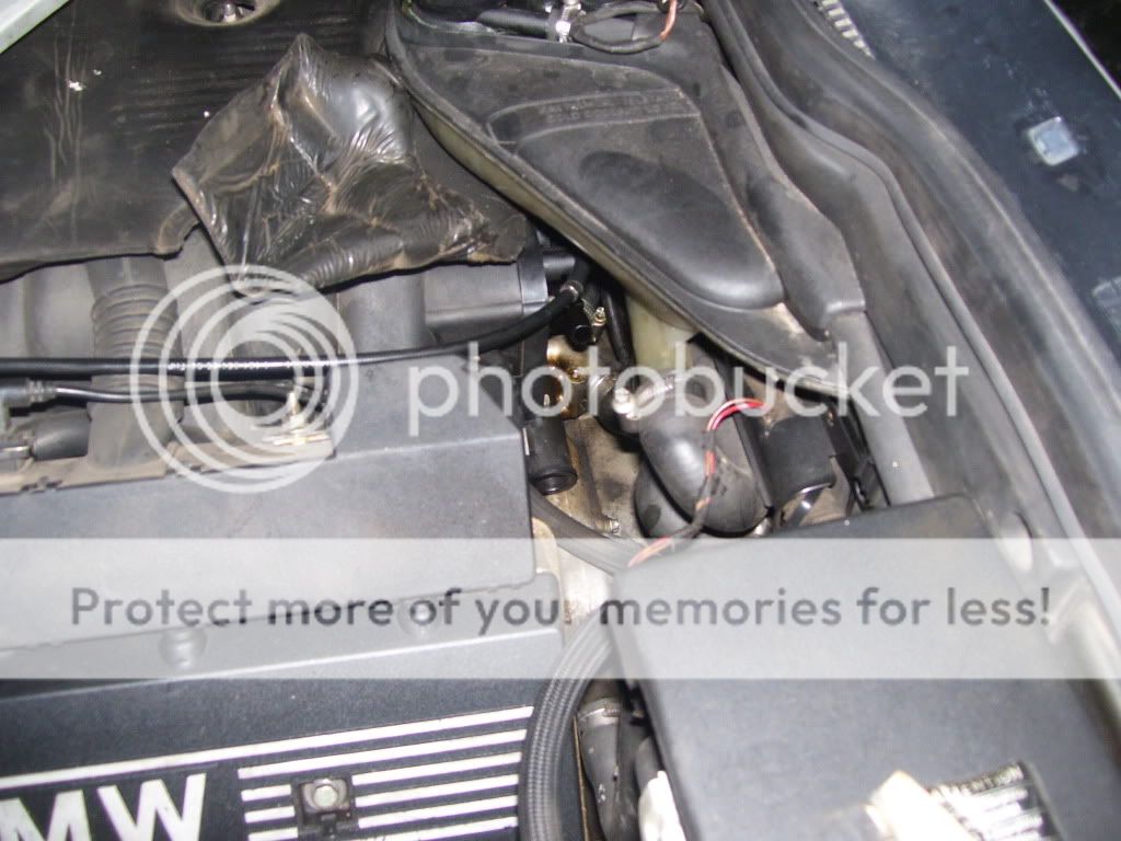

This is a bigger view, just to get an indication of the location of the little bugger.
