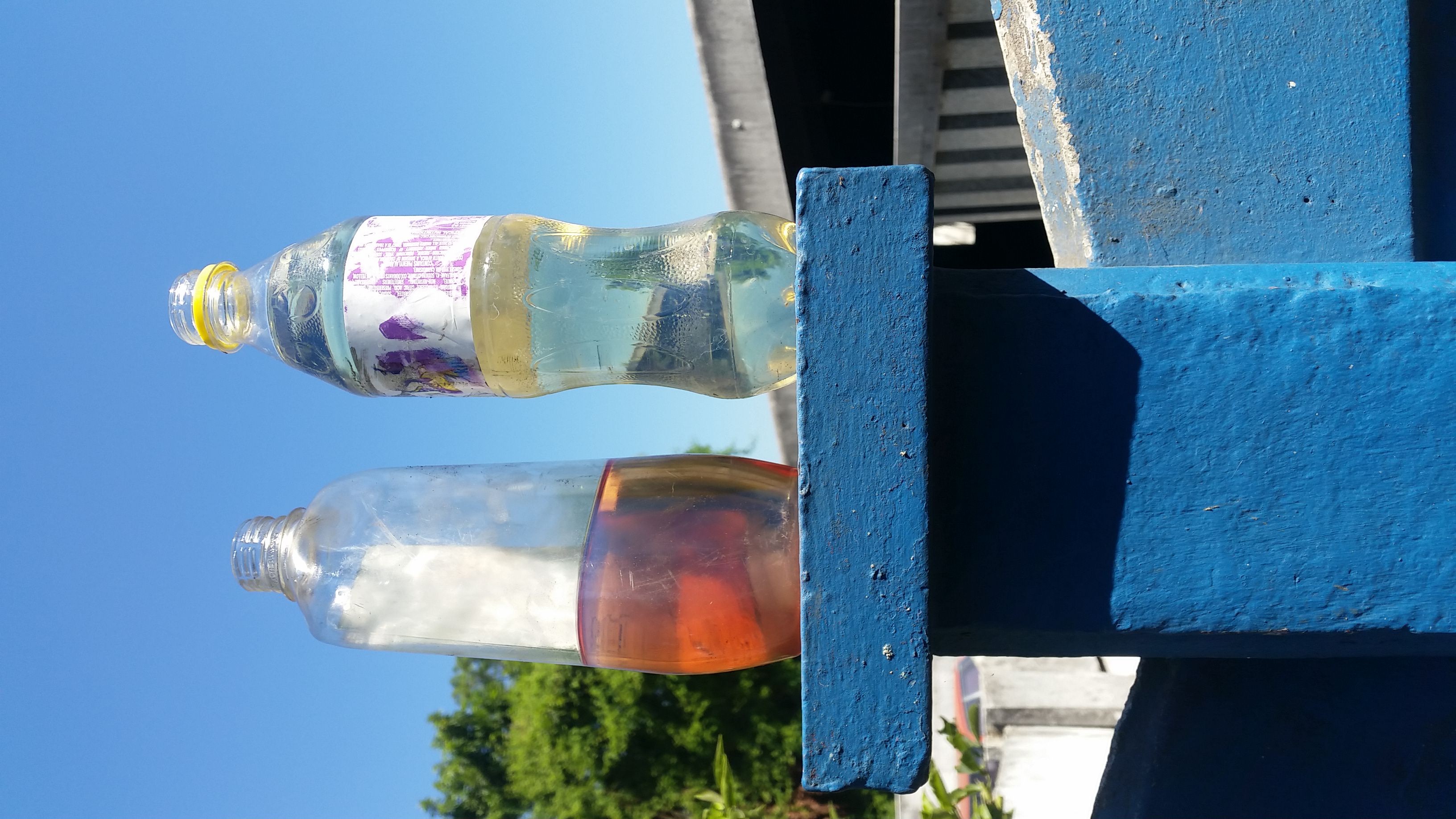

Hi guys i traveled from Jhb to Durban on Saturday my car is a 2004 320D 180k on clock. New turbo and new injectors a year ago. Car drove like a charm. I had about half tank and filled another R200 at tugela plaza unfortunately we went into the shop and came back paid the attendant and left. The mext day while driving my car just started shaking losing power and it could not drive at all. It starts but misfiring badly as if its running on 2 cylinders with a lot of smoke. Also the accelerator pedal is not responding and if touched the car cuts off. Took it to my mechanic and he drained my tank. This is what the diesel looked like compared to new diesel on the right. Should i be worried??

Unfortunately i dont have the slip onky a sms on my phone of the actual transaction. Will change the petrol filter etc tomorrow and see if it helps. As of now the petrol in the tank is assuming. But to me that looks like a mix and definitely not clean diesel.
