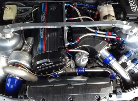

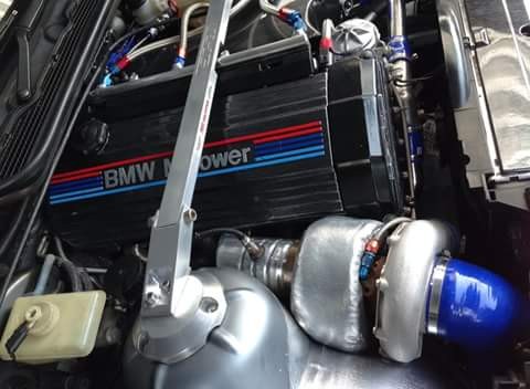

moranor@axis said:
more details please :)
turbo install looks quite neat
In a nutshell..
M52b28 block stroked to 3l using M3 crank. Forged bottom end. Built by Budler.
325 non vanos head, supertech valves and springs, 280 cams, flowed and put together by Vd Linde.
Fullboost branch and intake.
Precision PT 7675 bb turbo.
430wkw 670nm @ 1.3 bar, ethanol.

@nikhil, this car used to be the 'ultimate street car' originally built by Savspeed.

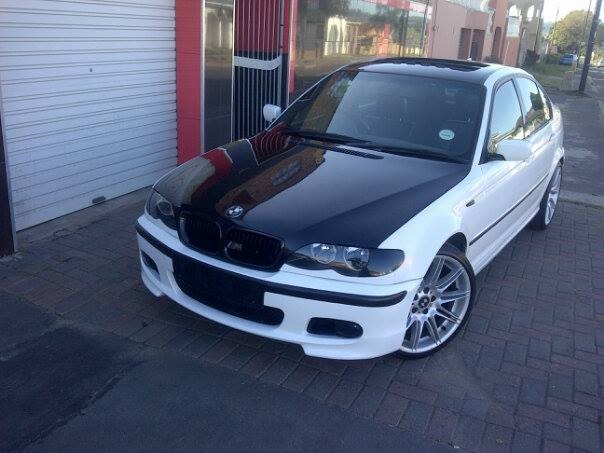

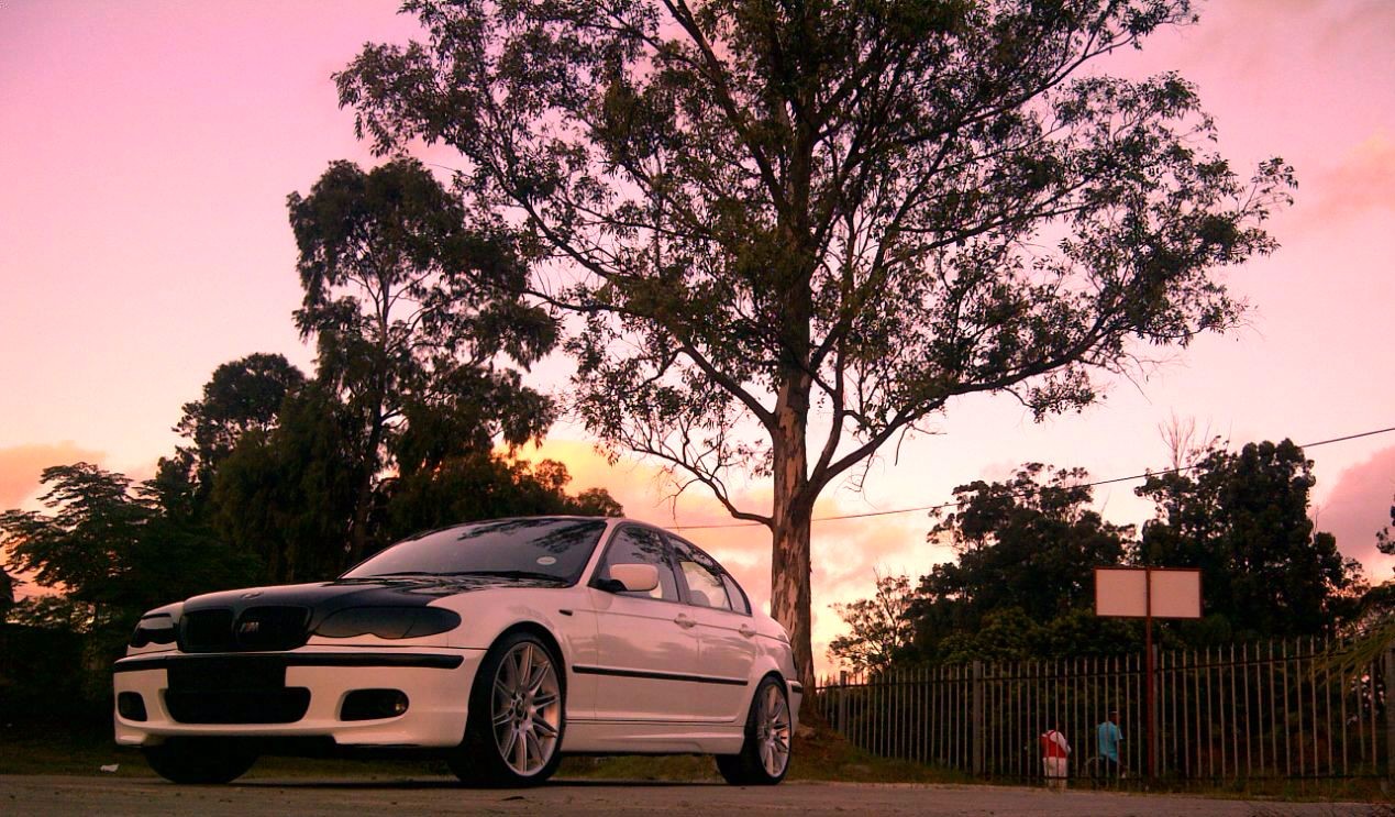

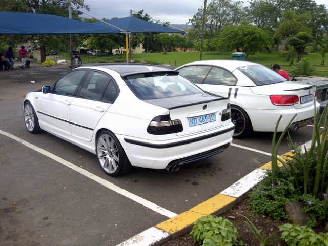

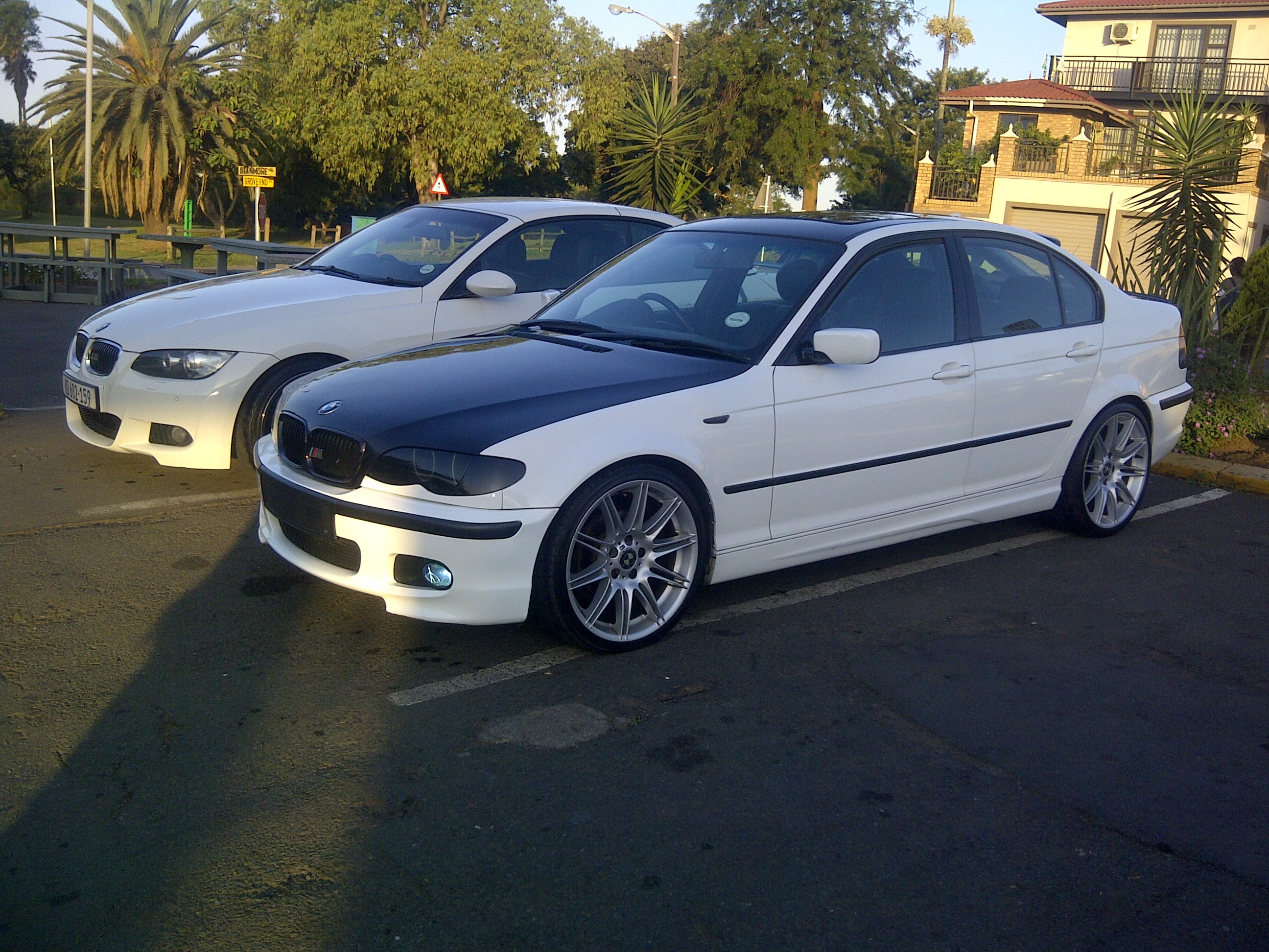

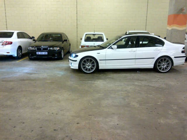

My '04 E46 325i individual. Originally Black Sapphire Metallic, was resprayed after an unfortunate collision which damaged most of the front end. The black and white color scheme seemed like a good idea to 16 year old me, and, though I am still fond of it now, I realize it isn't fitting of a BMW and is rather juvenile.
Plans for the car include a CSL front bumper, Space Grey respray, coilovers, a CSL-styled trunk and 18" satin Black ADV.1 wheels.

Thanks for the post, absolutely nothing juvenile about ur car, I love it!

"Crazy" looking car and that Power:skit:...
The E46 looks different and nice in a way, to use to seeing ordinary E46s everyday. Would love to see the new build tho wen u start.

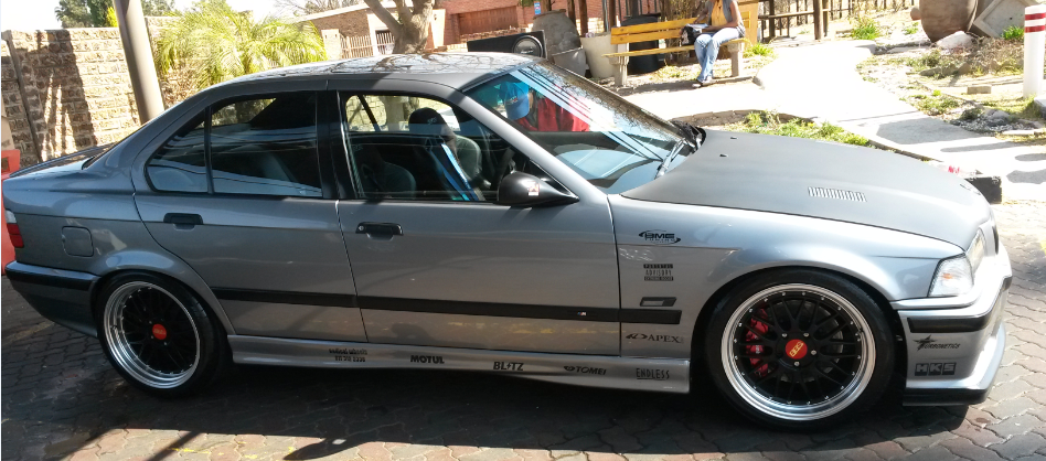

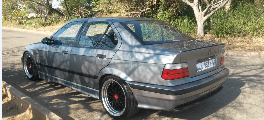

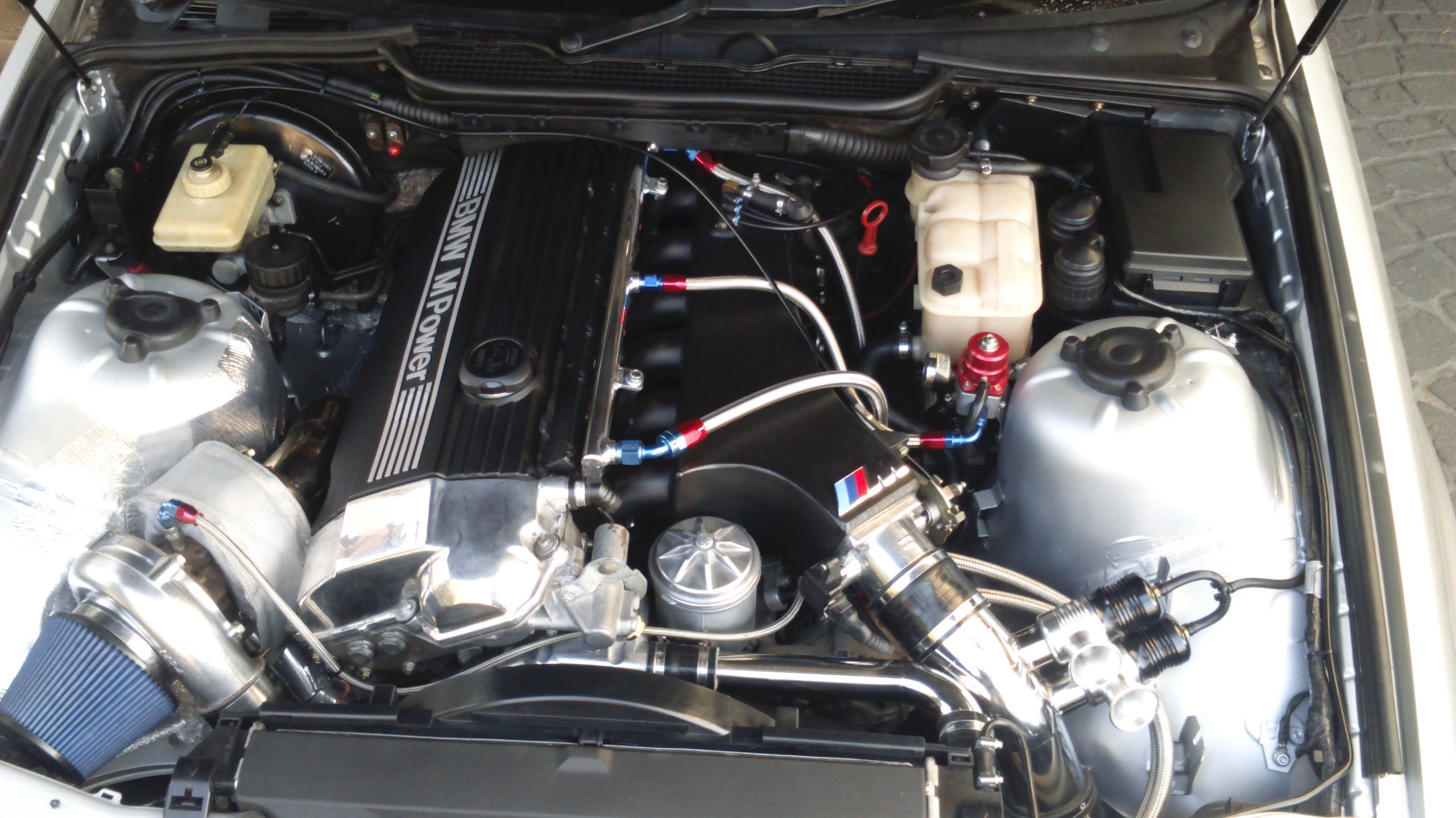

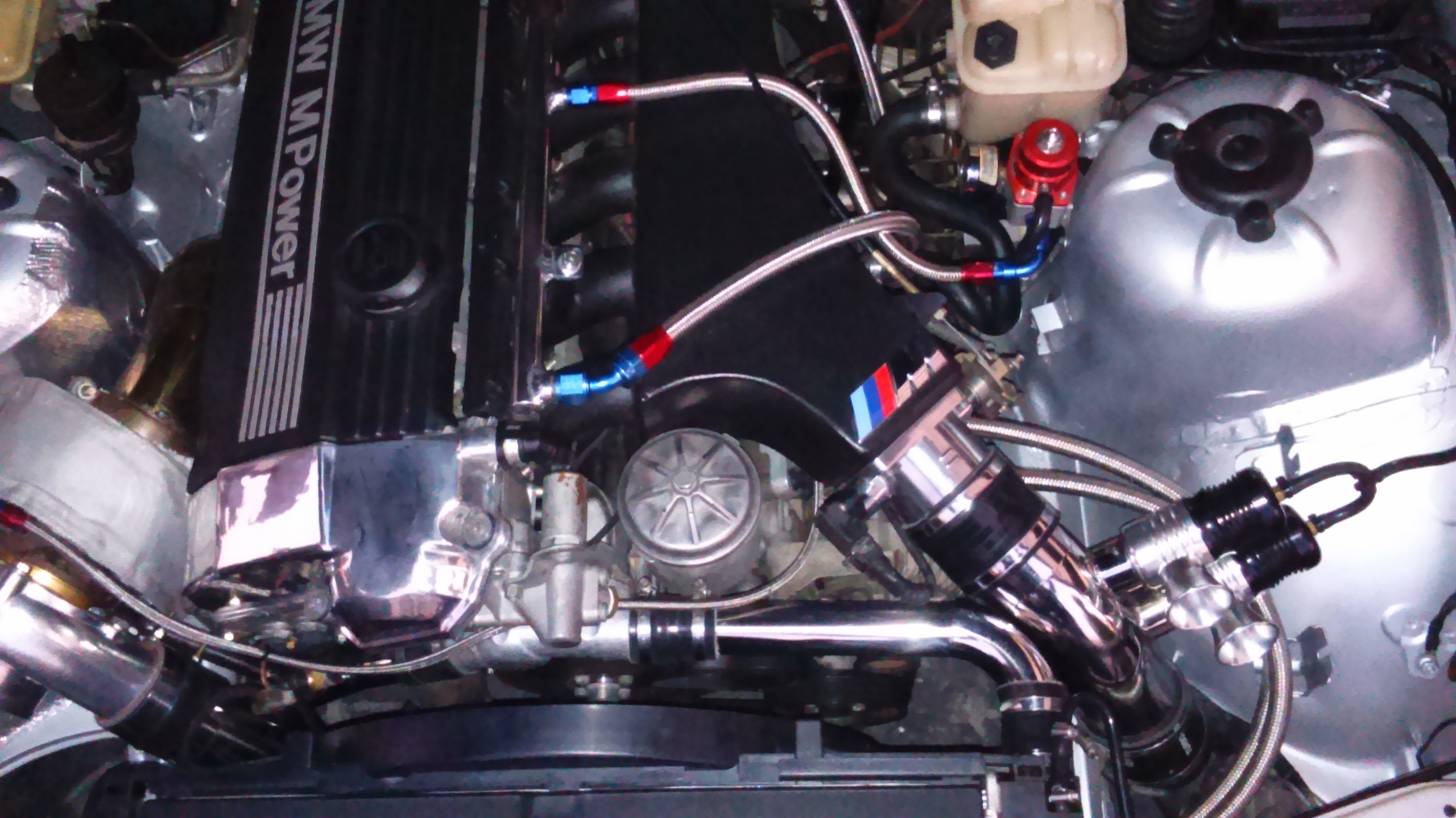

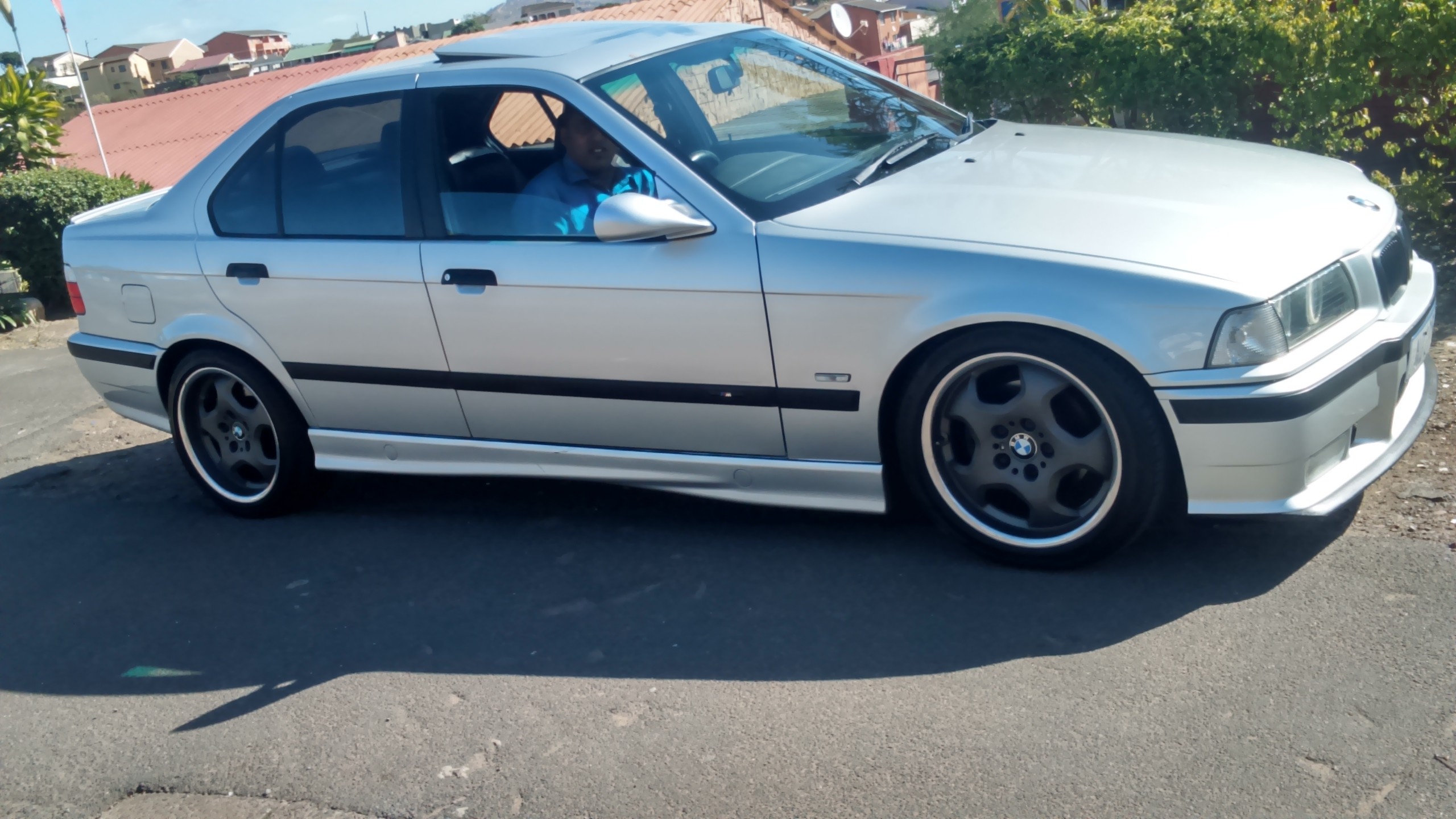

Hi Guys,
No more pics of MODDED cars???
Anyway, here are some pics of my first E36 328i INDIVIDUAL turbo build, that was sold a few years ago to a fellow fanatics member "Sideways".
This used to be my pride and joy but I was forced to sell it, and regretted the hasty desicion every since..........but its finally back in the family! :blowheart:
Almost 6 years later, a close friend of mine purchased the car from Sideways and sent it back "home" for me to rebuild the engine.
The car was still in excellent condition, special thanks sideways for taking such good care of her!
Here are some pics, I am sure some of you might recognise the car! It is now back in Durbs.

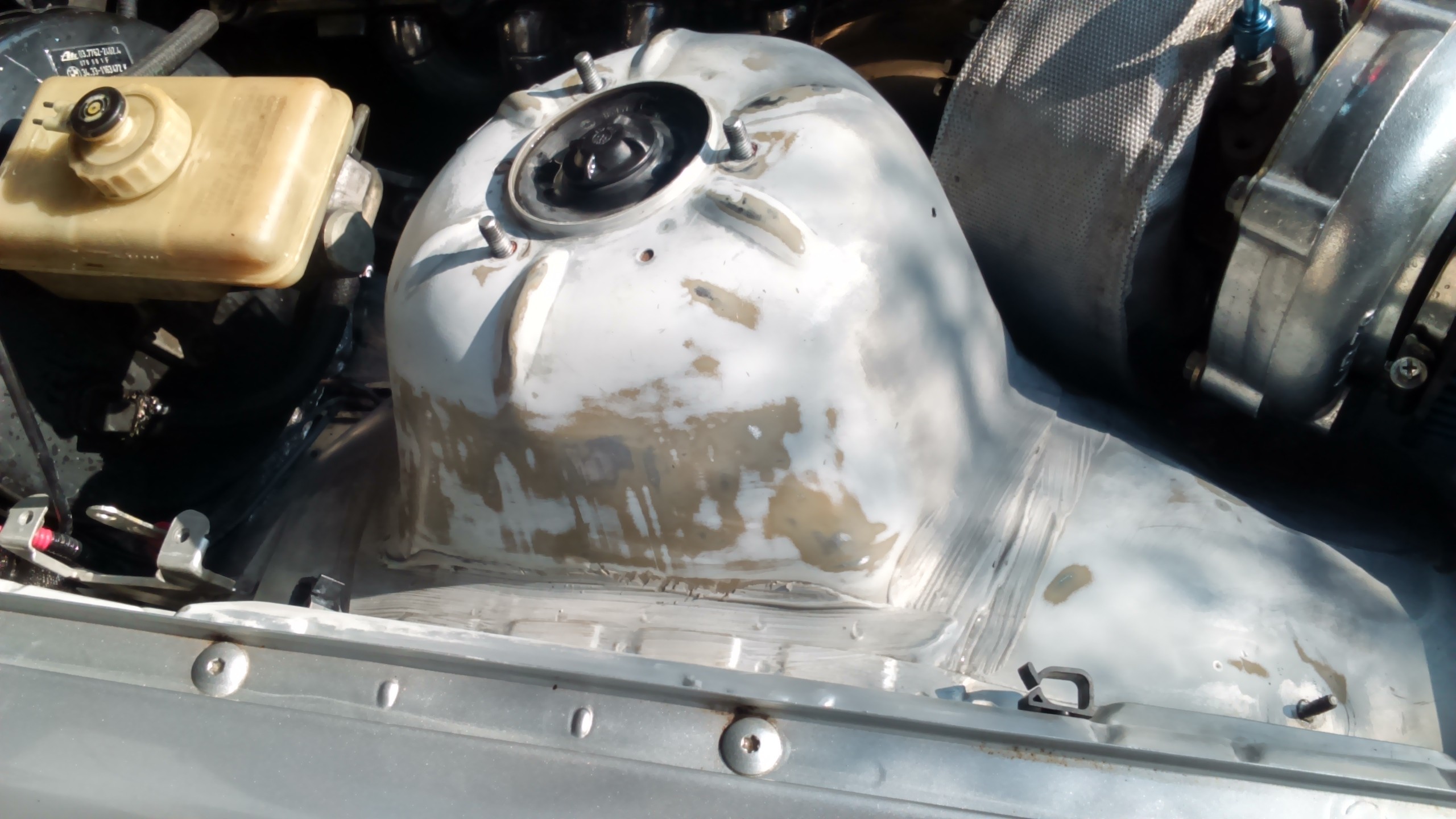

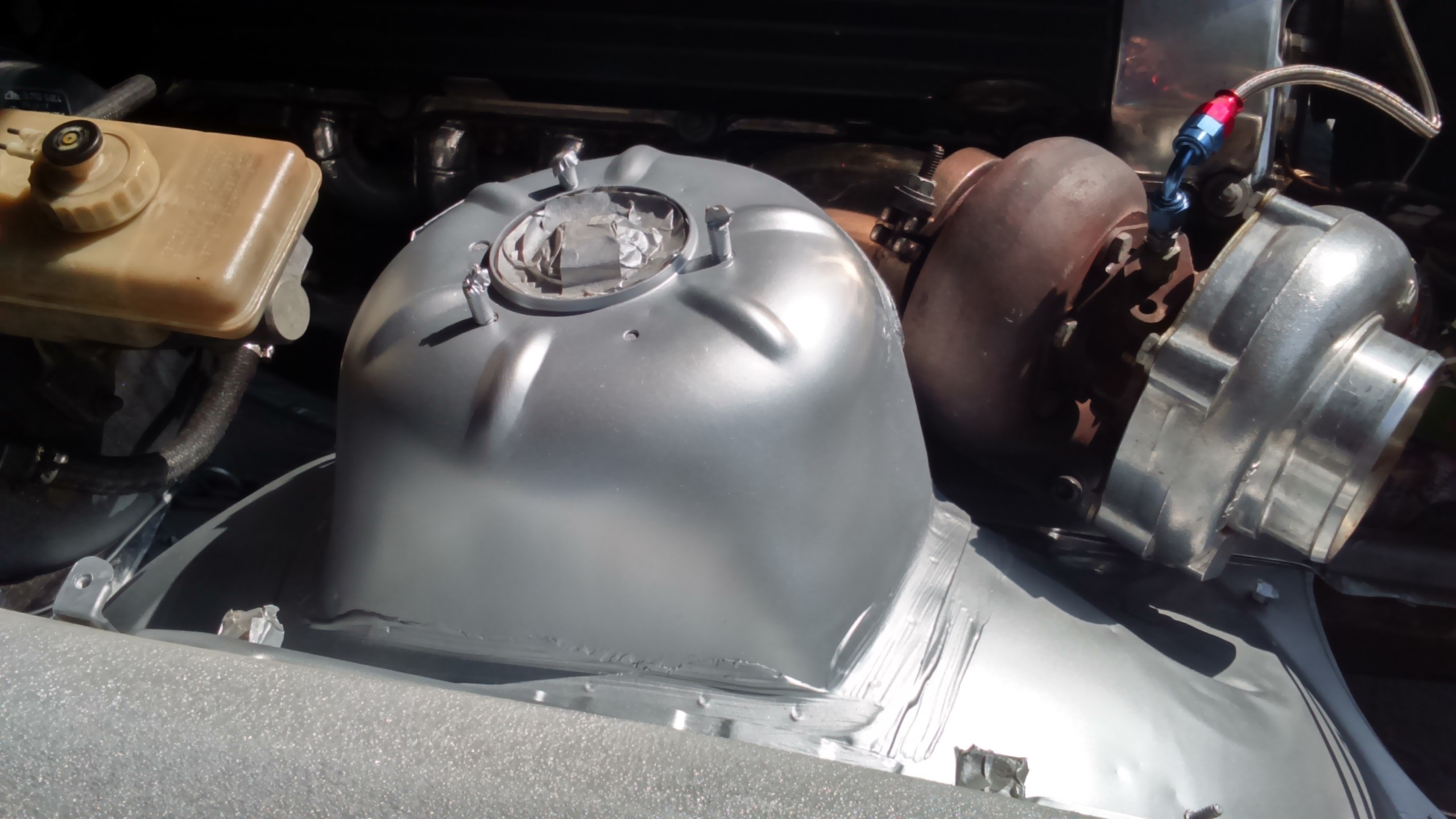

Stock head, just flowed. Bottom end has forged pistons and scat rods with 328 crank. ARP stud kit top and bottom. T66 ball bearing turbo with Fullboost branch.
Making 265wkw, 420Nm on 1 bar boost, pump fuel.....for now! :rollsmile:
Engine Bay required some new paint after an oil leak damaged the paintwork.....my airbrushing skills came in handy....lol
...and finally....engine bay almost identical to my current car.
