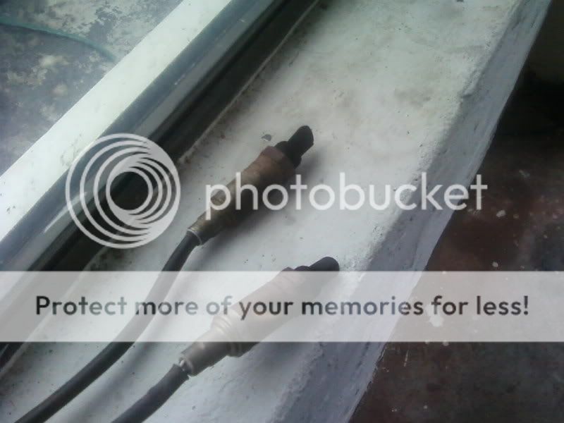

Then he removed my oxygen sensors, they were already disconnected, but still attached, by disconnecting them the computer substituits a valve of 0.45 when it cannot pick up the sensor. He then removed his still working sensors and put them in my car :excited: After which he put new sensors in his car
My old f.cked sensors
